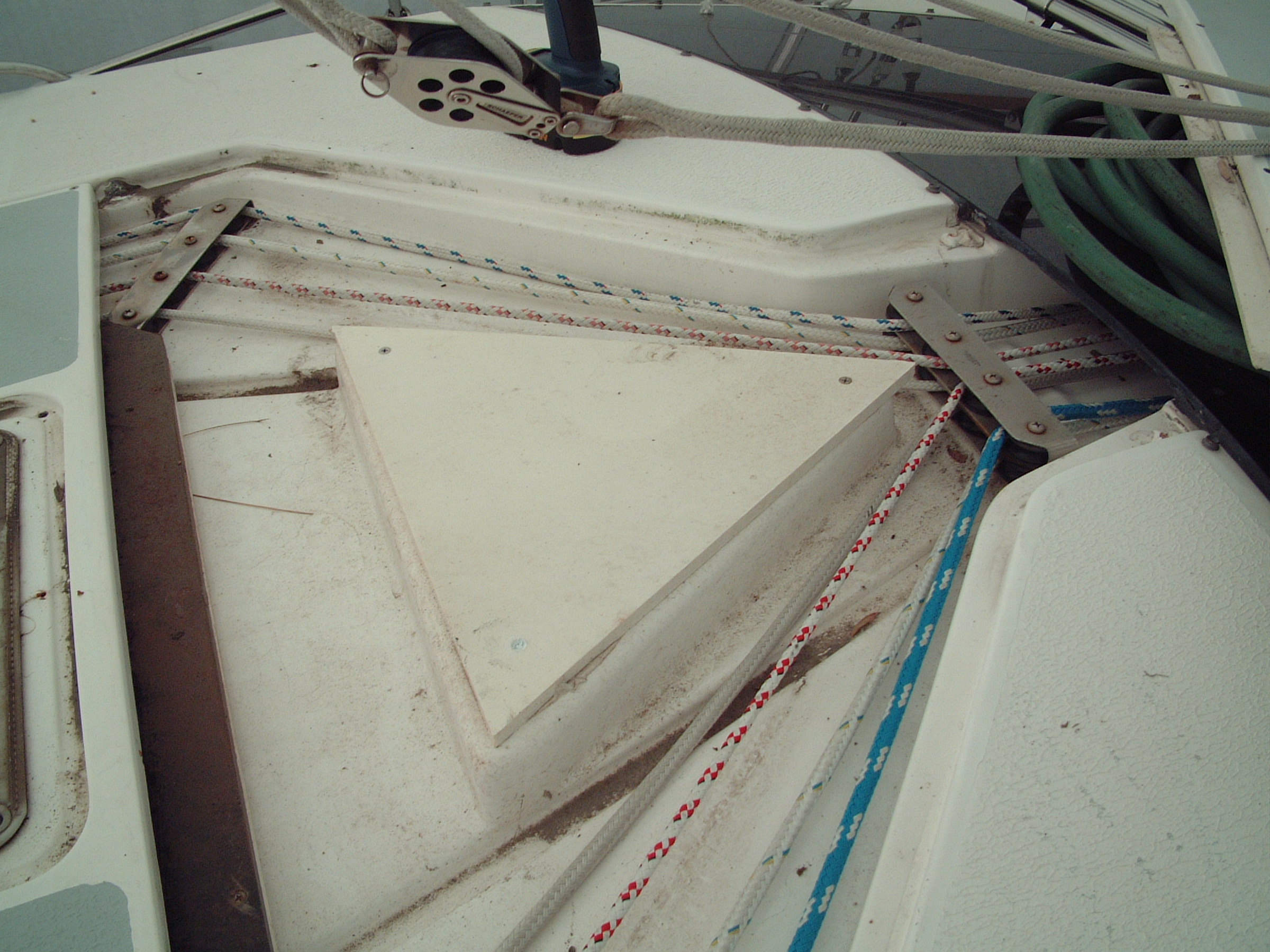

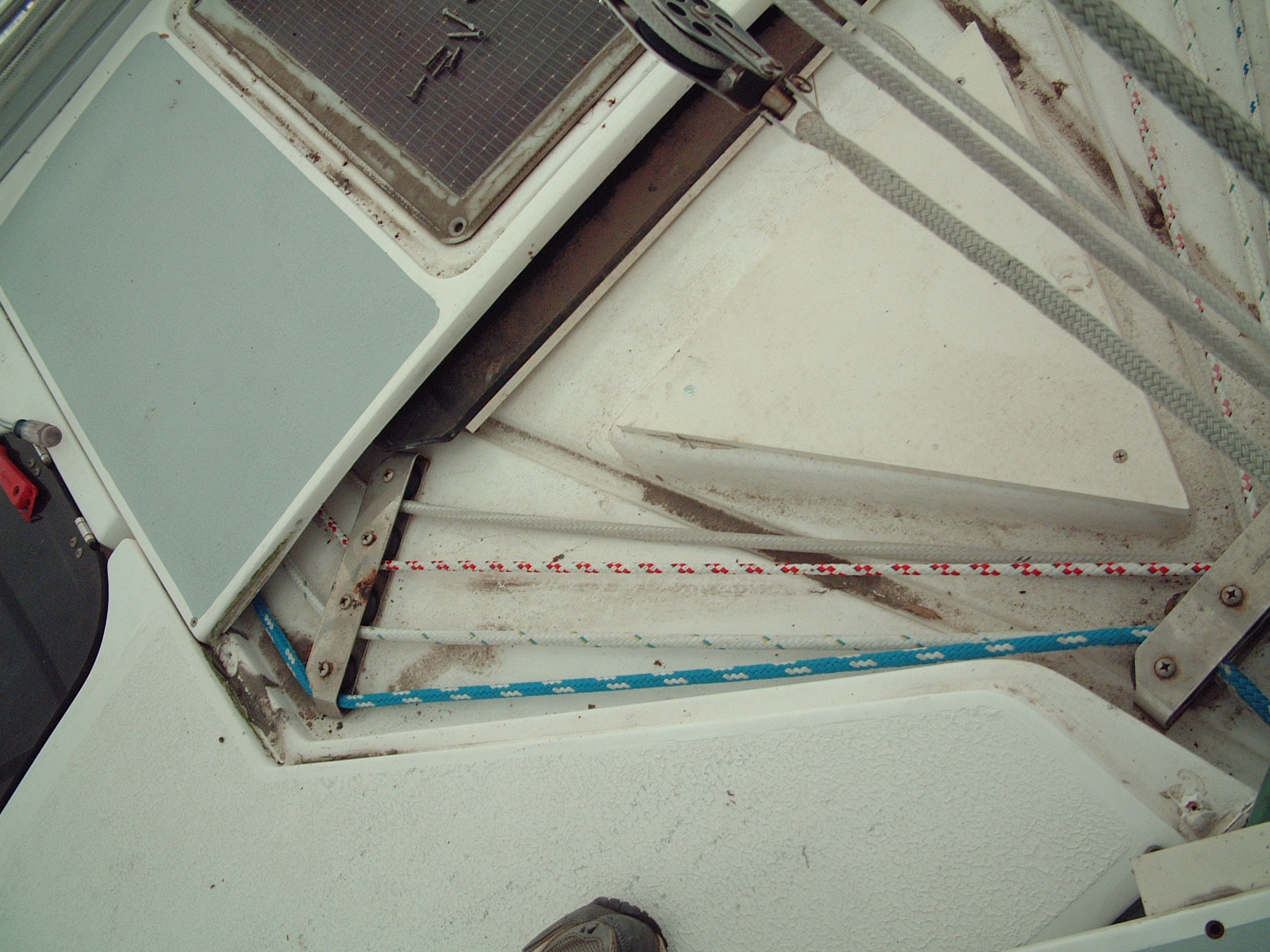

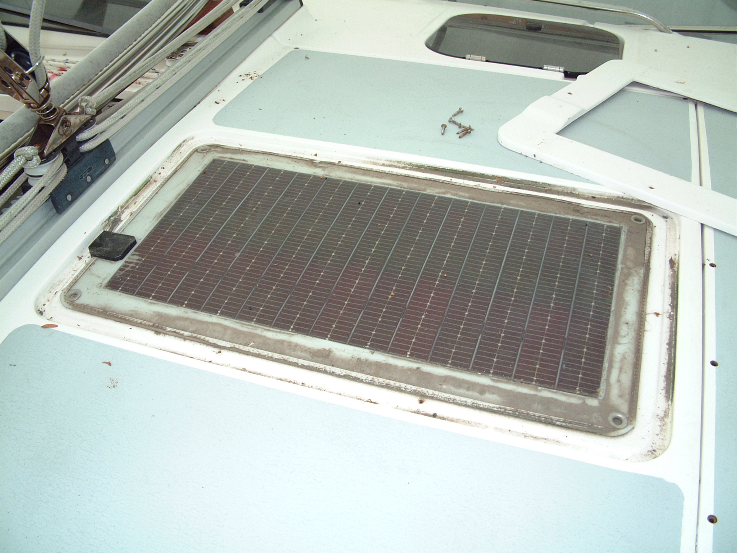

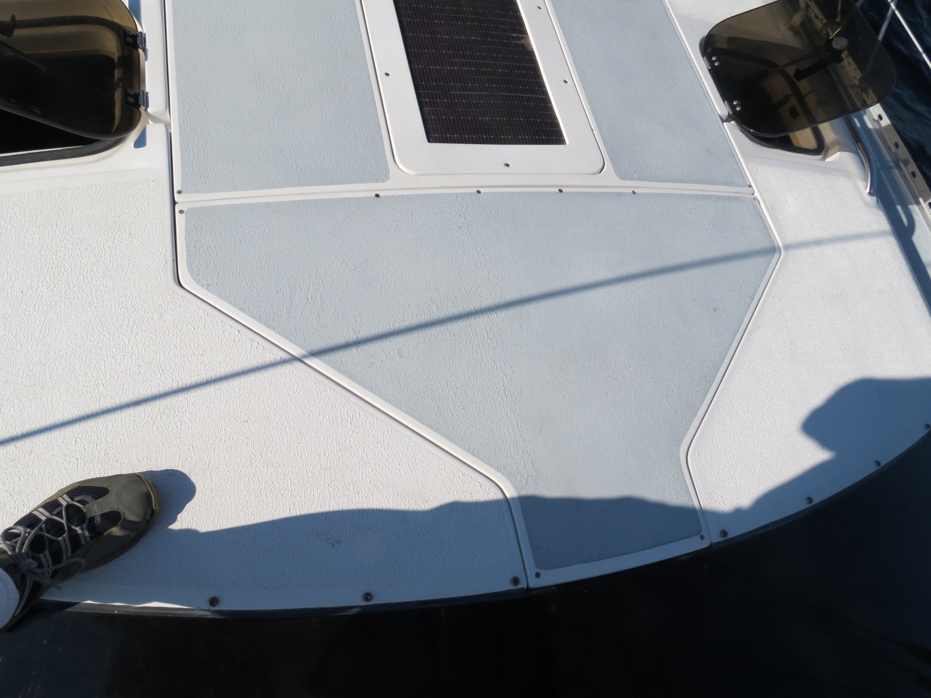

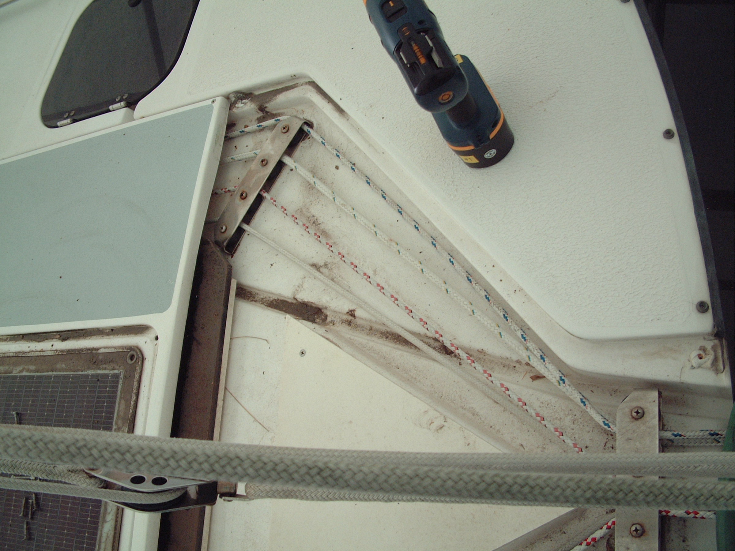

Dan- Perhaps pictures of my 1997 h405. will help you. at least you will see where the factory made the cuts. The unanswered question is if the factory changed anything else other than just cut and make two pieces.

Thanks Rich - You and Bill have been very helpful. The pictues really help alot. I have as good a head start as anyone has a right to expect. Thanks again.
