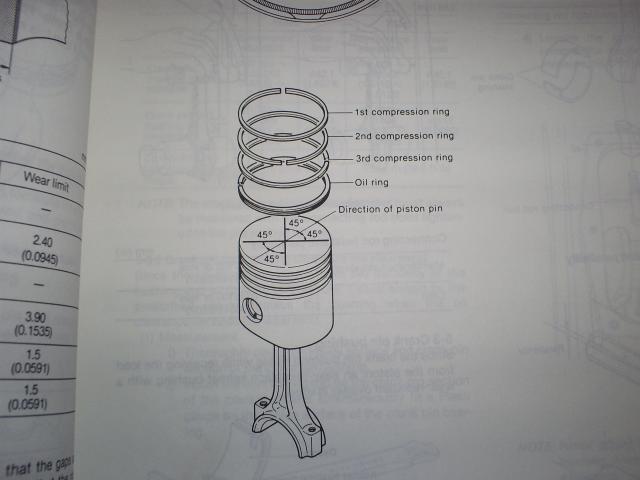

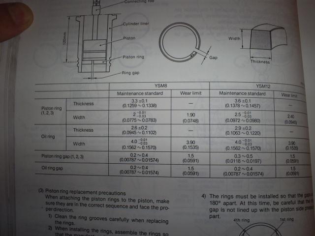

Were working on rebuilding a 1GM10 yanmar engine that seized. To make a long story short, everything is looking up except we can't find specs for the piston ring alignment in any online owners manual, parts manual, or tech data sheet. Is this not as big of a deal as I think in a small engine like this. We can go to yanmar but they want around 60 dollars for a book on all gm engine repair.
