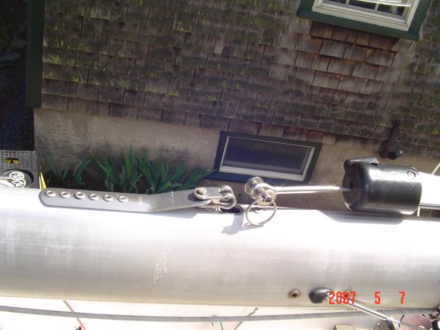

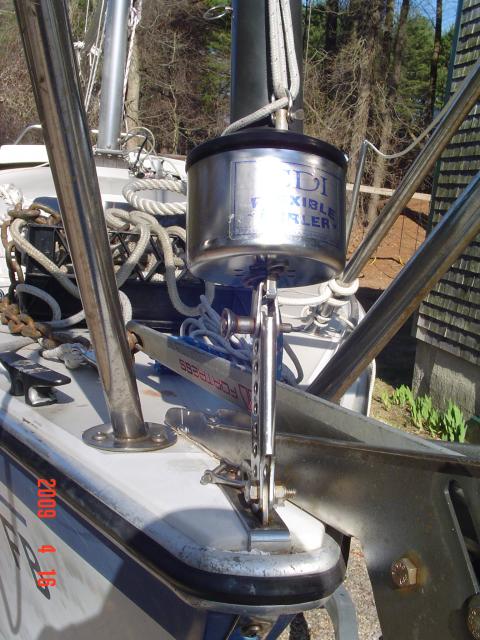

On the stem plate there should be a rigging pin with a cotter pin. A bolt will work as long as it's not completely threaded. On my boat I have a roller furler and an anchor roller under it. I needed the room under the drum to be able to handle my anchor so I Mickey Moused a MacGregor lever type rigging fitting to give me that 5" of space needed. In place of a regular rigging pin, I use a press button quick pin for my fore stay connection to this tang. This is what I choose to use along with a Johnson Handy-Lock on my back stay. I also have a Mickey Mouse set up for my tang on my mast to make disconnecting my furler a lot easier for trailering. My friend uses a bolt and nut with a cotter pin in a toggle strap, and I use a rigging pin with a cotter ring in a toggle strap at the mast tang. As long as it's all stainless steel and it's safe, it's OK.

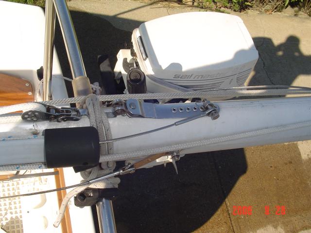

Precisely. The bolt should have a long smooth area to hold a sheave pulley or turnbuckle. They say that the threaded area of a bolt is the weakest part of a bolt. You may need to replace a mast head sheave some day and some mast heads have pins that are pressed in place, or a riveted type pin. This pin can also be replaced with a S.S. bolt and lock nut to hold the pulley in place. I installed one on my mast years ago and it's still holding up. As long as the pulley spins on the smooth part of the bolt, it's perfectly acceptable. My friend Wayne uses a nut & bolt, with a cotter pin for his fore stay connection to the tang on his mast and this works for him. In the picture, the bolt at the end of the stay connects to the toggle strap on the tang. I stole this idea off him, but I'm using a rigging pin instead of a bolt.
