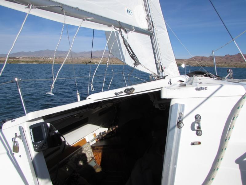

Sumner, I spent some enjoyable time a few days ago tagging along on your adventure (great job) and one of your pictures illustrates the visibility issue that comes along with a larger Genoa
This picture below is from your web site with the larger Johnson lever extension (I figure you have about 11.5 inches of extension including the extra toggle at the bottom). I think you have a 135 Genoa
Since we have the same exact boat, its interesting to compare the visibility you get with the 100% jib that is as low to the deck as is possible (my picture below). With the larger Genoa, even with it raised, as the boat heels the sail again begins to block the view. The smaller jibs are cut so that you can heel a lot more and see where you are going.

Since I'm sitting here in major wind and probably won't move north before Tuesday I dug the tape out and went out and measured. Measuring vertically off the deck the bottom of the drum is 13 inches off the deck and the bottom of the sail is 17 inches.
The view is going to depend on a lot of things, how much sail is out (don't need to put a 130 all the way out), the angle of heeling, where you are sitting, how close hauled you are, running or on a reach, etc. and of course how important it is to you to try and see forward under mostl conditions. In the pictures you posted the 135 still has better forward vision by the pulpit but that comes at the price of the much higher point where the bottom of the sail is attached to the furler. Of no consequence to me but it probably is to you as you are more interested in the speed difference. Just do what fits your style of sailing the best.

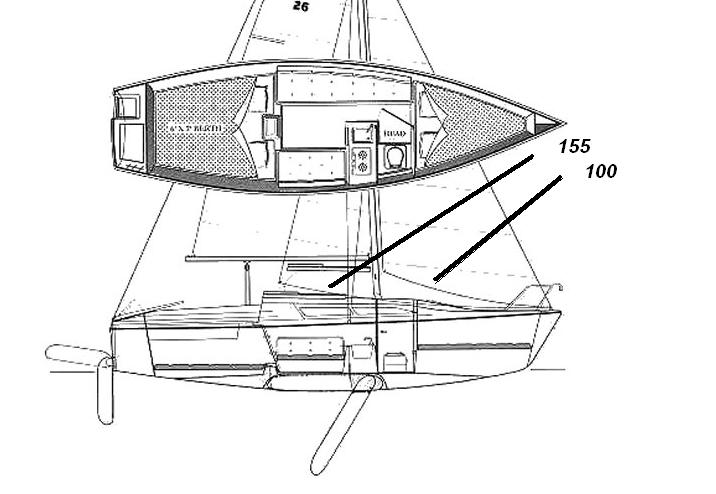

With the larger, low cut sail... it is common practice to install a window to improve leeward visibility. On my #1 Genoa.. about 140%... there is such a window... and is quite an advantage for singe handing. With a crew, it is less critical because the headsail trimmer is sitting on leeward side most of the time... and can warn the driver of obstacles.
When I single hand with the larger sail.. which is not very often.. I will steer from leeward side quite a bit... especially in the crab pot areas.
Another thing to consider with the low cut, deck sweeper design is the likelihood that green water can be funneled back towards the cockpit.
The sail's cut will have a lot to do with lead block placement. In the first drawing you'll see the two suggested sails have completely different lead placements..... requiring a huge adjustment system, or at the least, two separate lead blocks. The design of this boat's topsides would restrict the adjustment track options...
In the second drawing the genoa has a much lower clew... helping it line up more closely to the working jib's lead... The suggestion here is that designing your sail plan with your boat's deck configuration in mind should be considered.

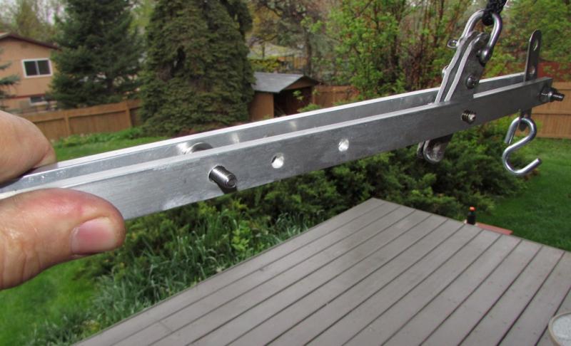

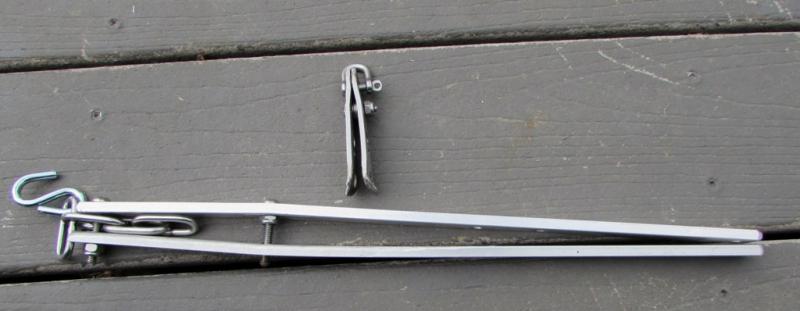

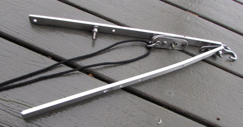

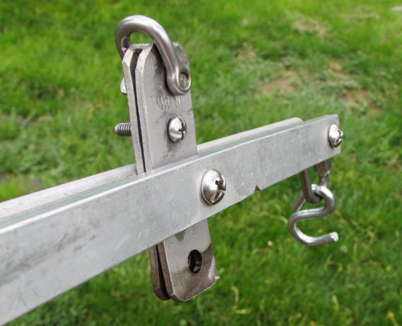

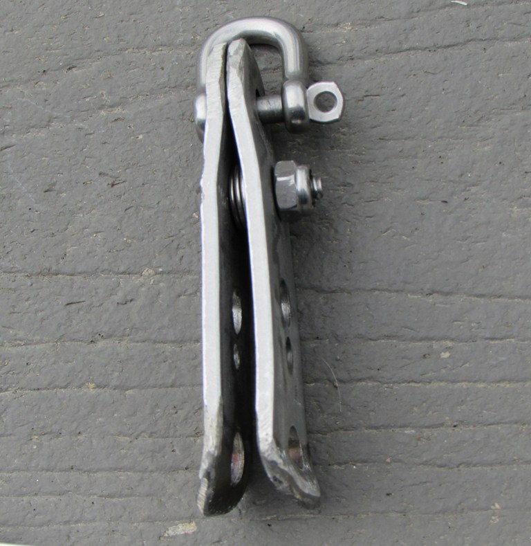

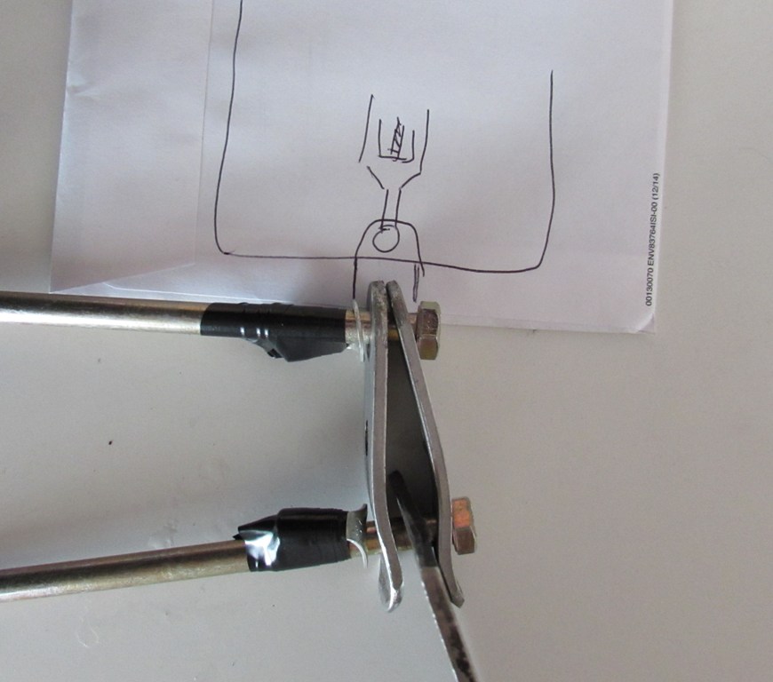

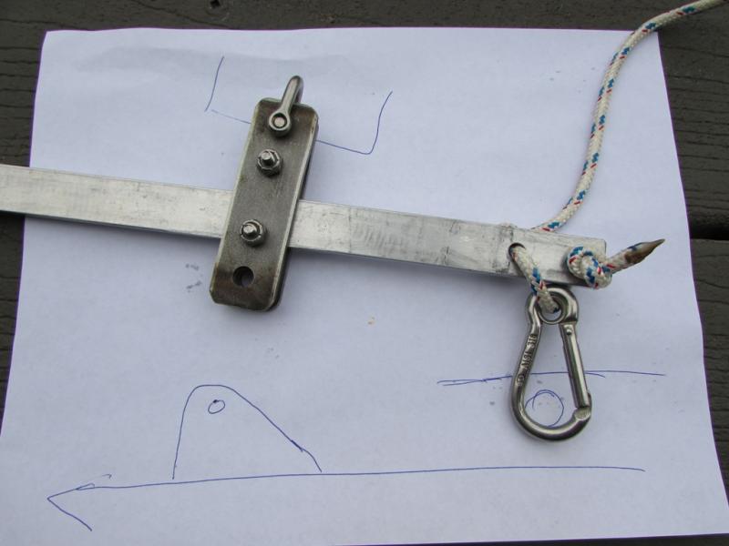

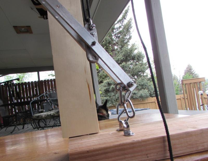

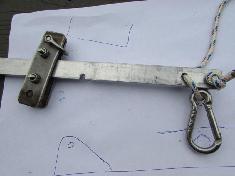

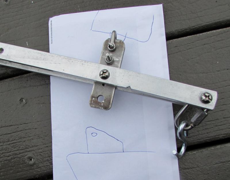

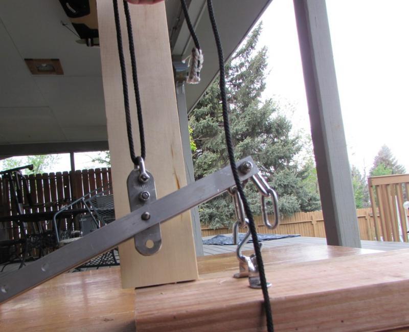

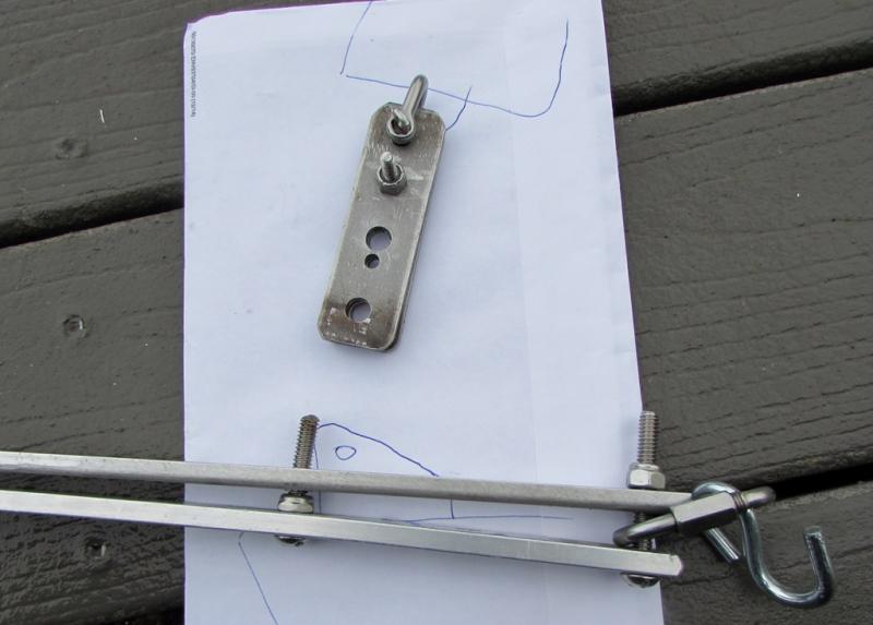

Just an update on the pinning stick idea..

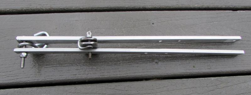

This is rev 4 and I think will work nicely. All this hardware weighs about 0.8 pounds and it will give a useful travel of around 6 inches which I think should make the setup fairly easy.
Those two aluminum bars are still 1/4 by 3/4 but now there are two of them so you can really put some leverage on these. I just tested this, other stuff will bust first. The adapter is 1/8 by 1 inch wide SS (drill slow with a cobalt bit - use lots of cutting oil)
This will raise the furler drum 2.5 inches. Easy to use, hopefully the pictures show how. You just hold the open end of the two sticks with your hand for pinning and I think this will be all that is needed. The stick will get stashed on the boat. I may only need it for raising the mast, the tight Gin pole pre-tensioning the mast may be all that is needed to un-pin and drop the mast.
Note.. the shackle in the pictures at the top of the adapter wont be there when I use this - it just shows how the furler will attach.
walt
Jun 1, 2007
3,550
A correction.. you can see the travel in the pictures - its the distance from when you can first attach the adapter to the stick (the adapter is already connected to the bottom of the furler) to where the adapter is pinned. I measured this and its about 4.5 inches which should be nice. The larger Johnson lever max "travel" is about 2.2 inches so the stick does over twice the distance. This stick has just a little more leverage than the larger Johnson lever but not much (3.75 vs 3.53 ratio). Note.. the measurements from the Johnson lever are from looking at pictures / caliper / scaling so might be off a little.

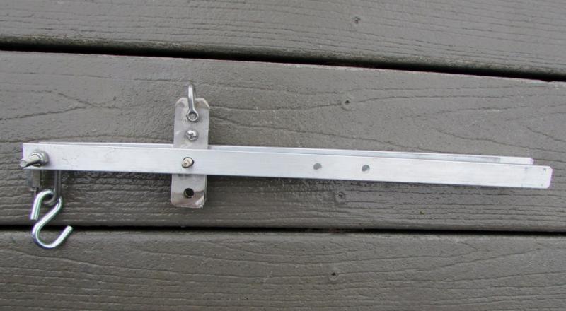

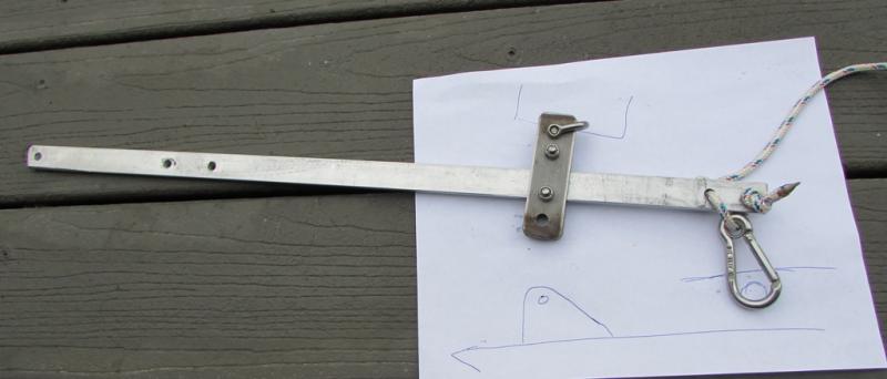

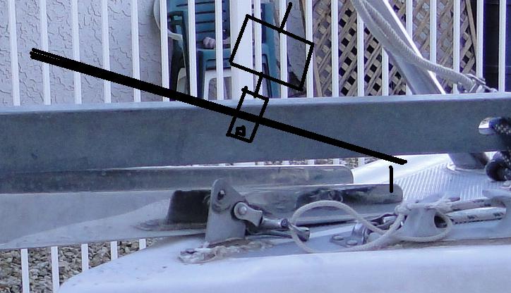

Rev 5 and I think final.. I wont get to fully test this until I get to the boat but based on all the testing I have done, I think it should work well. I will be able to attach the pinning stick to the adapter (always attached to the bottom of the fuler) and begin using the stick to pull the furler down for the last 5.5 inches before it gets pinned to the deck. I added one more registration open end bolt close to the handle end.

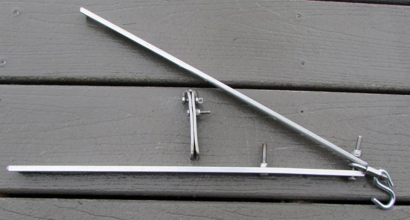

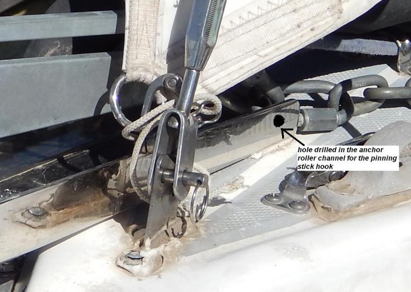

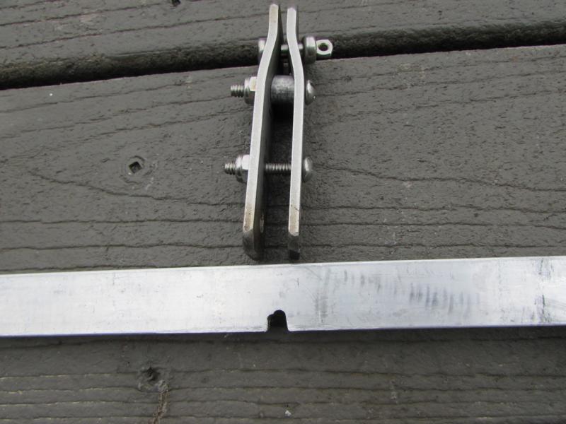

Ok. rev 6 now. I had not considered something important that was in the Schaefer furler set up manual.

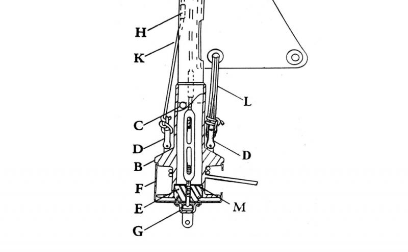

Its fairly obvoius that you need a toggle at the top of the furler forestay to prevent cable damage. The Schaefer manual also says you need a toggle at the bottom end. You can imagine the need for this toggle if you had a fairly loose forestay that allowed the jib sail to "bow out" under wind load. This results in the furler at the bottom of the forestay not being exactly normal to the deck and therefore the need for a toggle. When the forestay tension is very tight, this angle is small.. but you still need to worry about it.
Also, when you add a rigid structure in the "line", there needs to be a toggle at each joint. For example, if you add a Johnson lever at the bottom of the furler, the toggle at the bottom of the turnbuckle (inside the furler drum) handles the joint between the furler and the Johnson lever but you still need to add an additonal toggle at the bottom of the Johnson lever.
Since this "pinning stick" adds a rigid adapter, it needs either an additonal toggle at the bottom end or it needs to have some sort of toggle function.
So.. rev six has the "toggle function" built in (assuming this idea actually works.. it has not been tried yet).
Rev 6 raises the furler above the deck by 2.0 inches now and still has over 5 inches of travel. This is compared to the larger Johnson lever that raises the furler above the deck by a mininium of 10 3/4 inch (lever plus toggle) and has about 2.5 inches of travel. Im referencing the larger Johnson lever since this also uses the 5/16 pins (which Im going to use).
