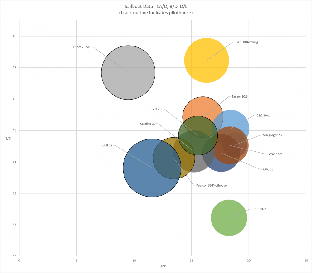

Attached is a bubble chart showing SA/D, B/D, and D/L for various boats in the size and price range that I'm considering. The size of the bubble indicates D/L. Bubbles with a black outline are pilothouses, which is currently my preference due the expectation that we'll be doing year-round cruising in the Pacific northwest.
I keep coming back to the Tanzer 10.5 as having the best all-around combination of the features I'm looking for. The Gulf 29 also looks really good. The Gulf 32 and Fisher 25 seem like really nice boats but, with their low SA/D, a bit more 'motory' than I want. The C&C Redwing is an outlier but it's such a pretty boat I couldn't resist including it. The non-pilothouse boats (C&C 30, etc.) have really nice numbers and are certainly options, with a full cockpit cover, but I still lean toward the pilothouses. The Mac 26S is shown only for my reference, because that's the boat we currently have.
