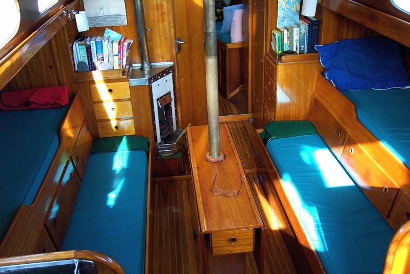

As I mentioned before, my boat was finsihed off by Field Aircraft Services. It may have been the first Alden boat they completed. The spec sheet for the boat called out for it the interior to be done in African mahogany. The "African mahogany" we get here is khaya, which in general, is what most people label as African mahogany. I've tried it on several places on the boat and the match is very poor. Your suggestion I look a sappelle ( or sapele ) got me on the hunt again for a matching wood.
As I searched thing out on the internet, I found that there really isn't anything that is true "African mahogany". The marketers has generally labeled Khaya as African mahogany but sapele, and others are also sold as African mahogany. I purchased some sapele and ripped it into battens for ceiling material. As you said, it cost about $7.00 a board foot but when ripped down to 5/16" battens, the cost is cut in half. The color of this wood matched my V berth better than the main cabin so I will use it there though the grain is quite different. It will look very smart. Cost is about $100 for the V-berth overhead ceilings.
In my search for the right looking sapele, I came across another wood that is ocasionally also sold as African mahogany. This is Makore. As it turns out, this is what my boat interior was finished off with. Makore has the distingtion of having heartwood that can be either as blond as spruce with golden grain when quarter sawn or a deep red similar to a true mahogany. I have the former in the galley and main cabin and the latter in the V-berth and trim pieces throughout the boat.
Luckily all of these woods have been readily available in Seattle. One of the things I find amazing is that I could never get anyone to identify the wood samples from the boat as Makore. I guess I was always asking the wrong guys.
I started on this quest to find an alternate to white painted peg board for the pilot berths ceilings. One of my big hang-ups was that I could not find any harder backed, "oil tempered" masonite type hardboard like you used to be able to get. Every place I went had only the stuff that seemed unpressed on the back side. Out of frustration, I resigned to the decision to put a temporary ceiling in the pilot berths using the "unpressed" pegboard. When I got to a new Lowe's in the area, I was astonished to find the hard backed material. ( I had probably checked 6 other stores and lumber supplies including at least two other Lowes.) So for $12.99 and a few hours of work, I put pegboard back in the pilot berths. Looks nice and light with great ventilation. Could be a winner though I will probably be looking at the light Makore or Port Orford cedar in the future.
