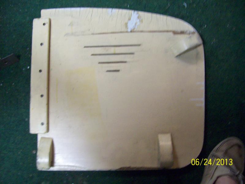

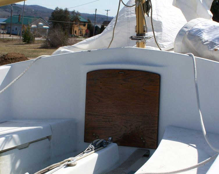

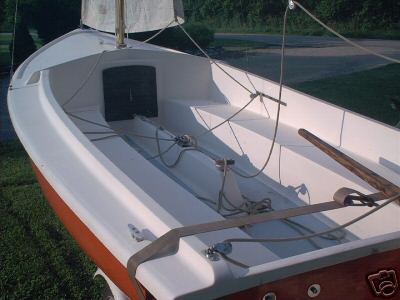

Pictures below, I'd suggest a call to Rudy at D&R Marine, I'm not sure if he sells the door/hatch for the Javelin (Under-deck stowage compartment......ah, heck, "cuddy" is close enough <GRIN!>). But he should have the dimensions. D&R (508) 644-3001 www.drmarine.com (phone call will always work better than e-mail to Rudy).

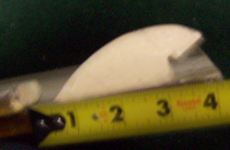

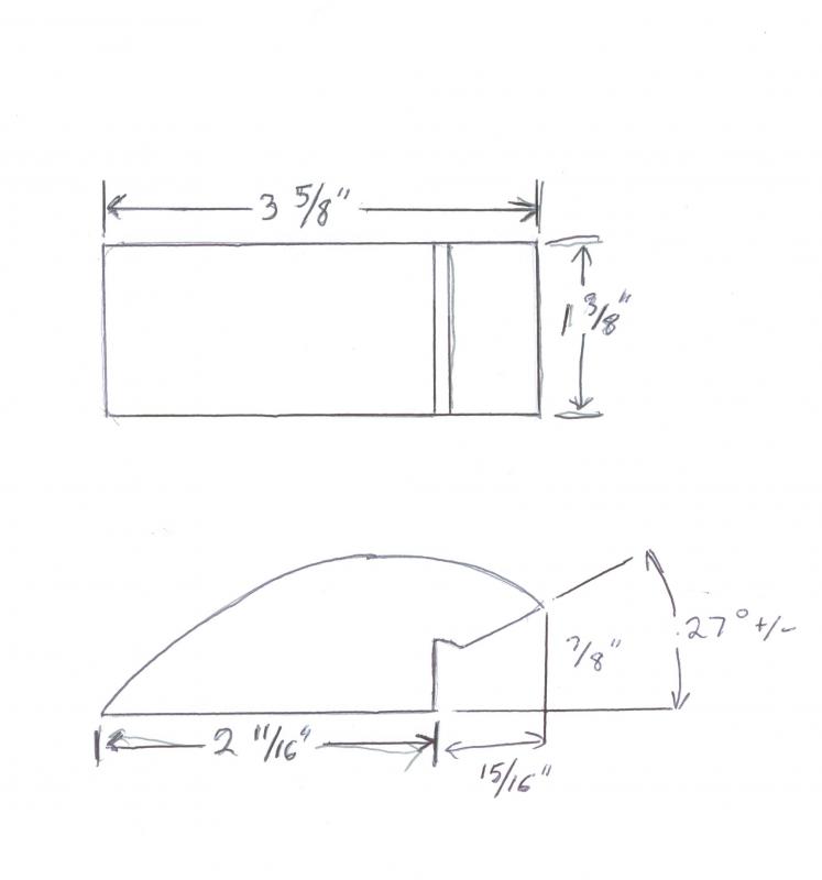

Hope these pictures help, it appears that the cover is about 1-2" larger all around than the opening, based on the cuddy boards for my DS II, I"d assume that there is a pair of wooden hooks on hte backside of the cover that slide over the bottom edge of the opening and a metal tab mounted to the bulkhead just above the opening that slides through a slot in the cover and has a hole for a lock to keep cover in place (could use a pin in place of padlock if you don't need to lock). I'll add a sketch of those hooks and a few pictures of my old DS II cuddy boards (I bought new ones from D&R a few years ago). To show how they fit, I can see in the pics of the Javelin hatch where these hooks are screwed on.
