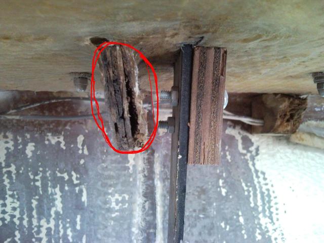

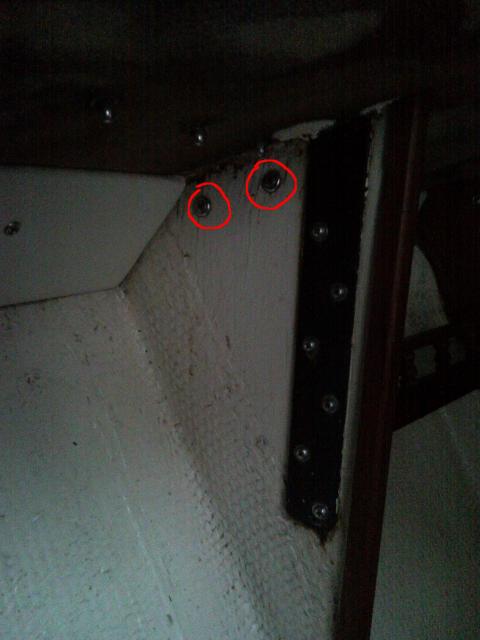

I know what you mean, but I removed those "decorative" pieces wood... I didn't ask my question properly, look at the attached pictures to this message. You'll see the old one with 2 screws that was fastening the bulkhead to that stiffner.
Do you think that I can remove those "stiffners" because they are rotten? Considering that my new bulkheads are longuer now

Those were added to the deck to avoid having to laminate up side down to the deck. They can be removed if you laminate your new bulkheads directly to the deck.
You must have a very early hull we stopped using them fairly early in production.

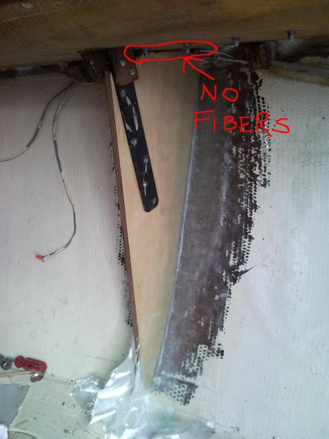

I didn't laminate the fibers to the deck (attached pic)... But my bulkheads are much more longer and it must be hard to keep the fiber glued to the deck...
Do you think that I need to laminate to the deck? Guess I can use a fast hardener...

I would laminate both sides of the bulkhead to the deck. Also be careful to coat the end grain of the plywood with epoxy. You can use plastic sheet or wax paper over plywood to temporarilay hold the laminate up if necessary, either screwed to the deck or blocked up from the bunk.

I puted epoxy all over my bulkheads with a brush before installing it, anyways, I didn't have any other choice because I used 3/4" russian birch exterior plywood. It's not a "marine grade" plywood but it is stronger and cheaper.
