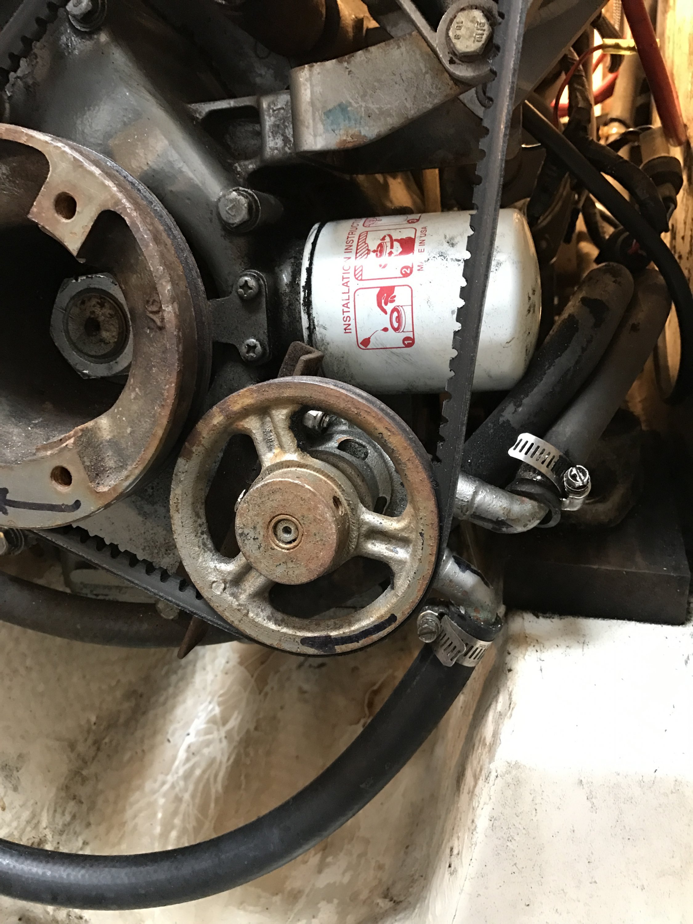

I can take a picture of the sea water pump on my 3QM30 tomorrow - I imagine it would be the same?

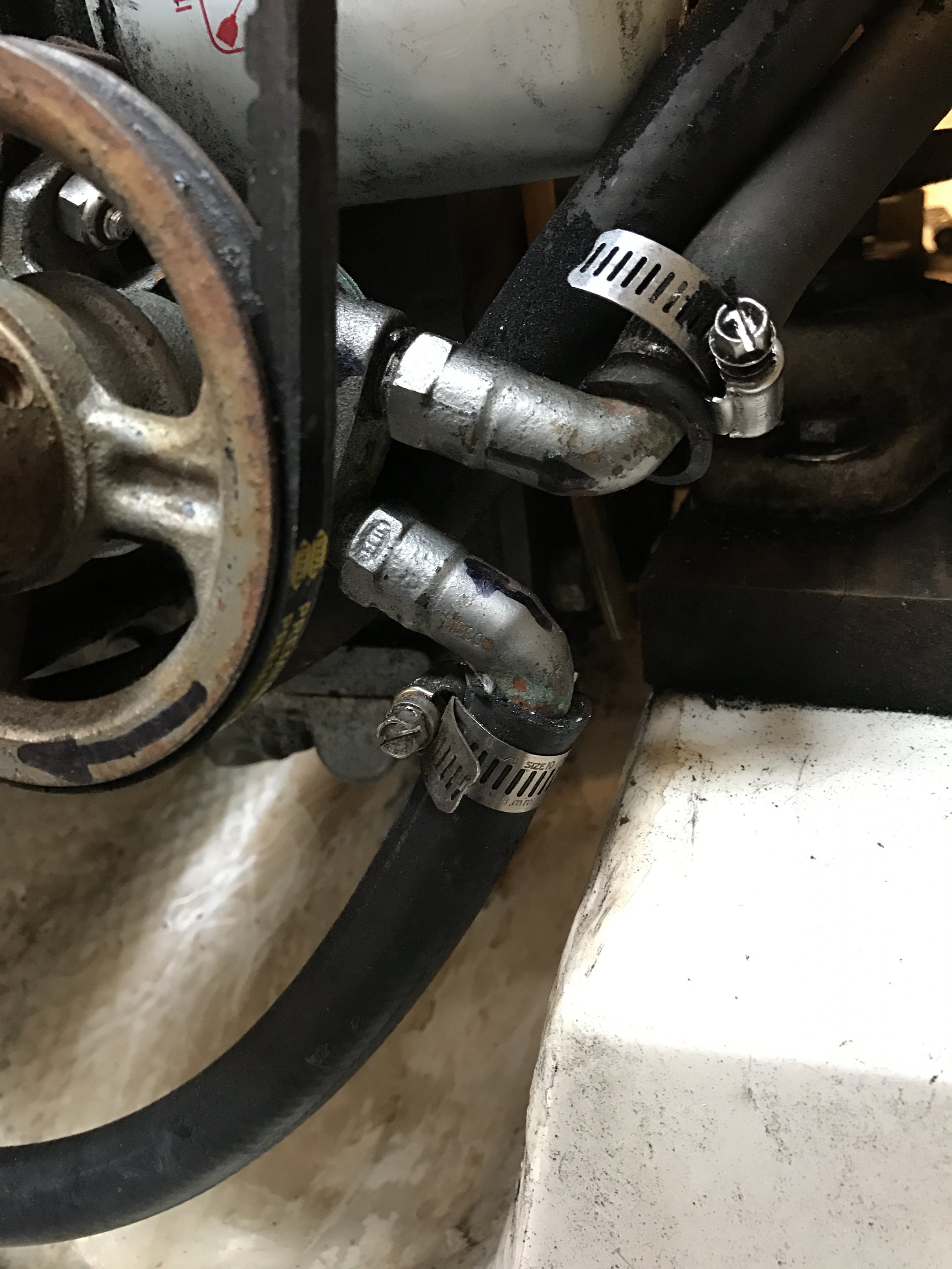

Tmbj,
Many thanks for the photo. (Jim -- you can cease and desist with your photo!)

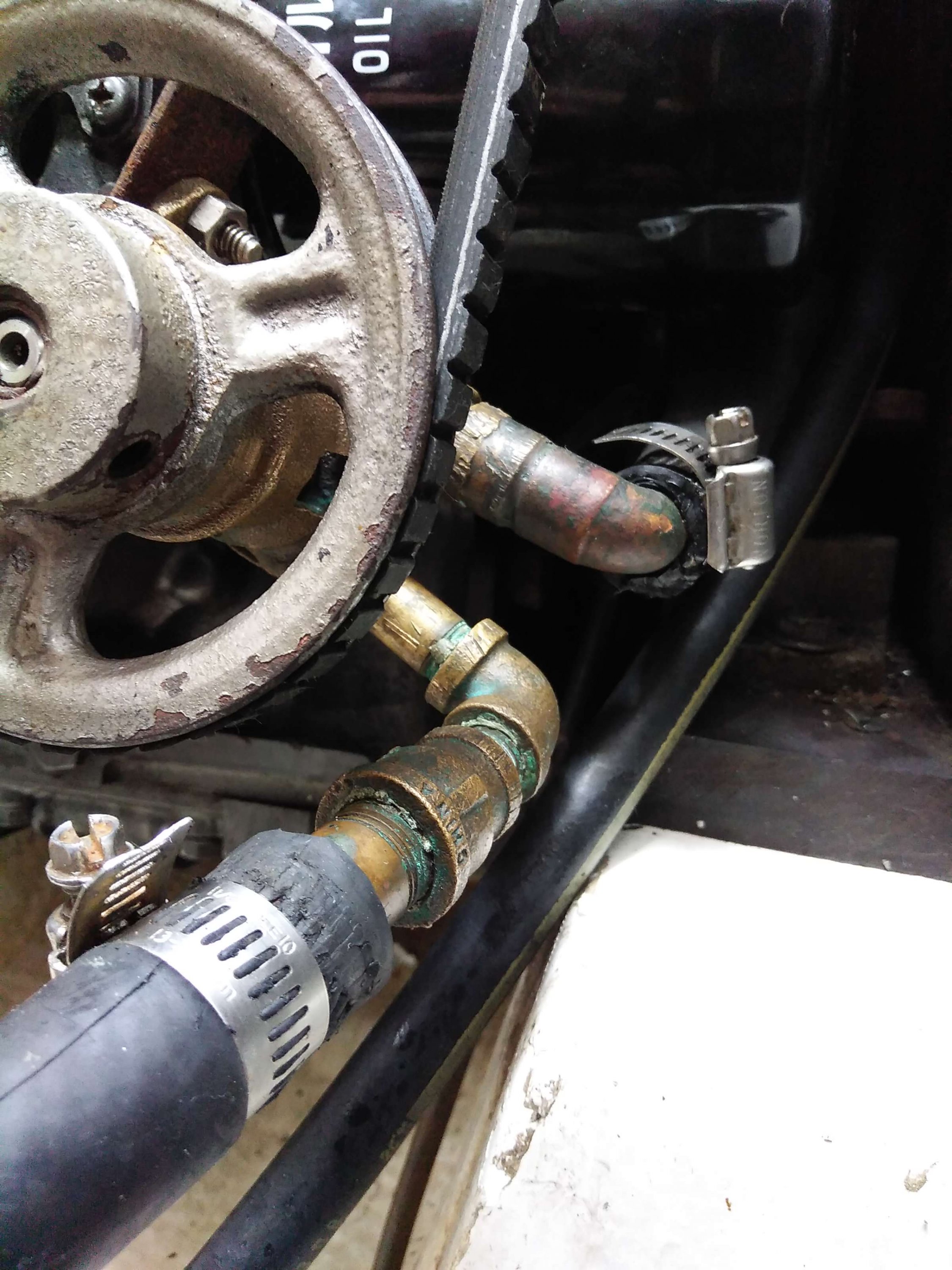

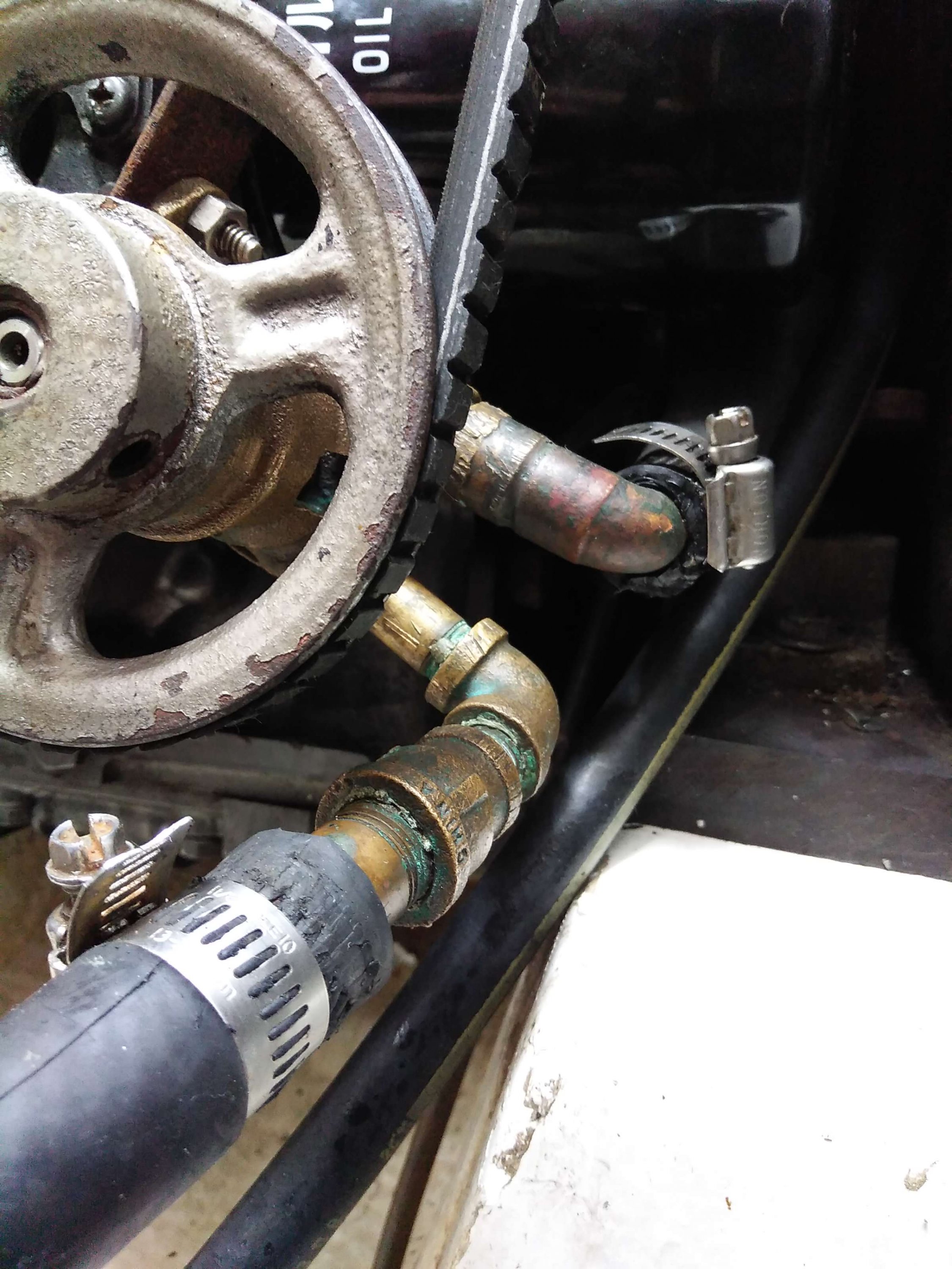

Attach is a picture of my hose lead configuration. Different than yours on the input side. My guess is that at some point in the boat's history, the hose rubbed against the flywheel. Hence the extension.

Glad to be able to help you for once - and to hear that your fix is working. Who knows maybe that'll do it for a while. Good luck with it.
Interesting re your hoses. The way mine run I don't think there's much chance of them contacting anything that moves. I may have modified their configuration when I got the boat as I had to do some work on the pump and replace the nose from the raw water filter. Maybe that helped. I can't remember.
