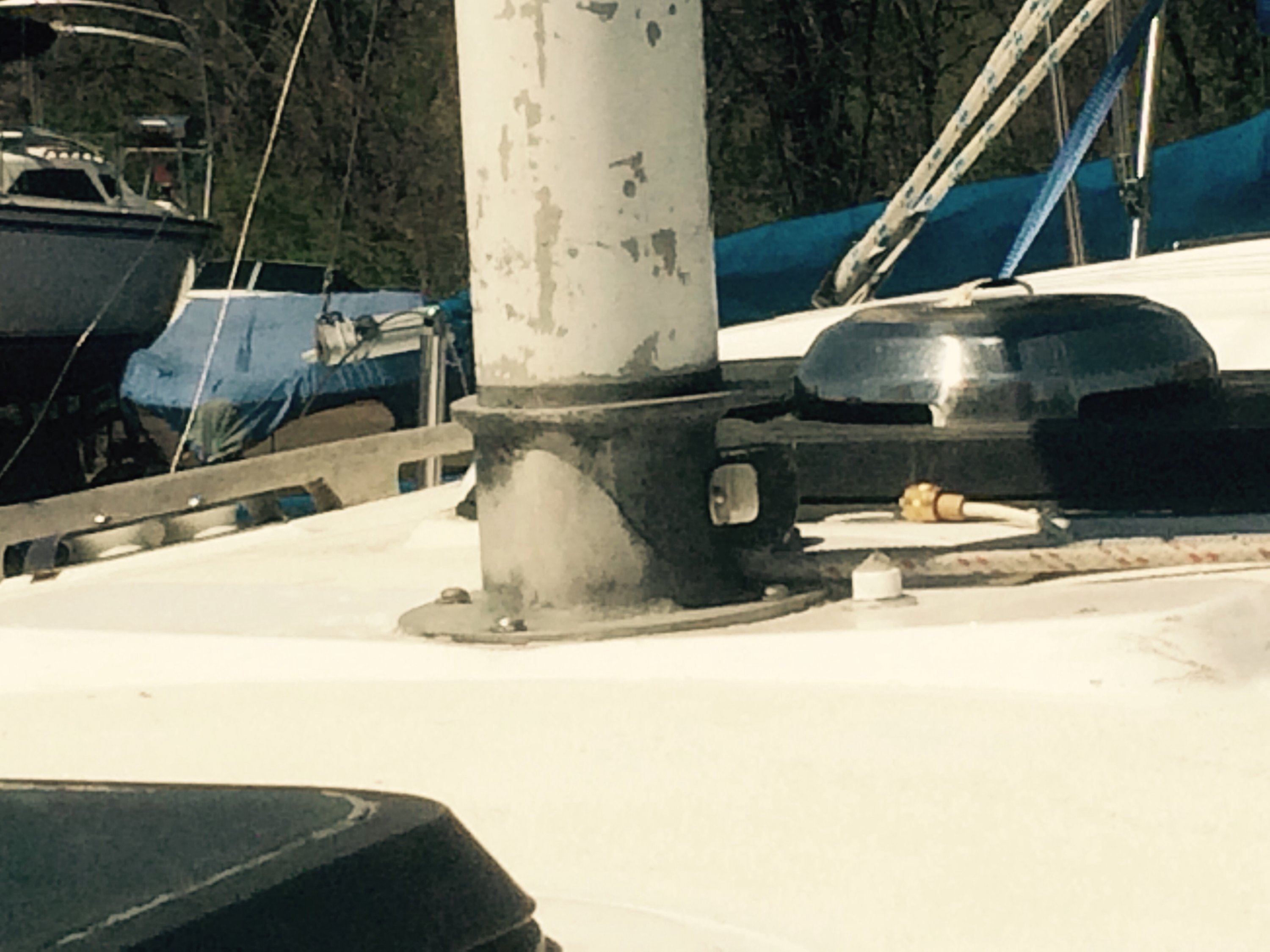

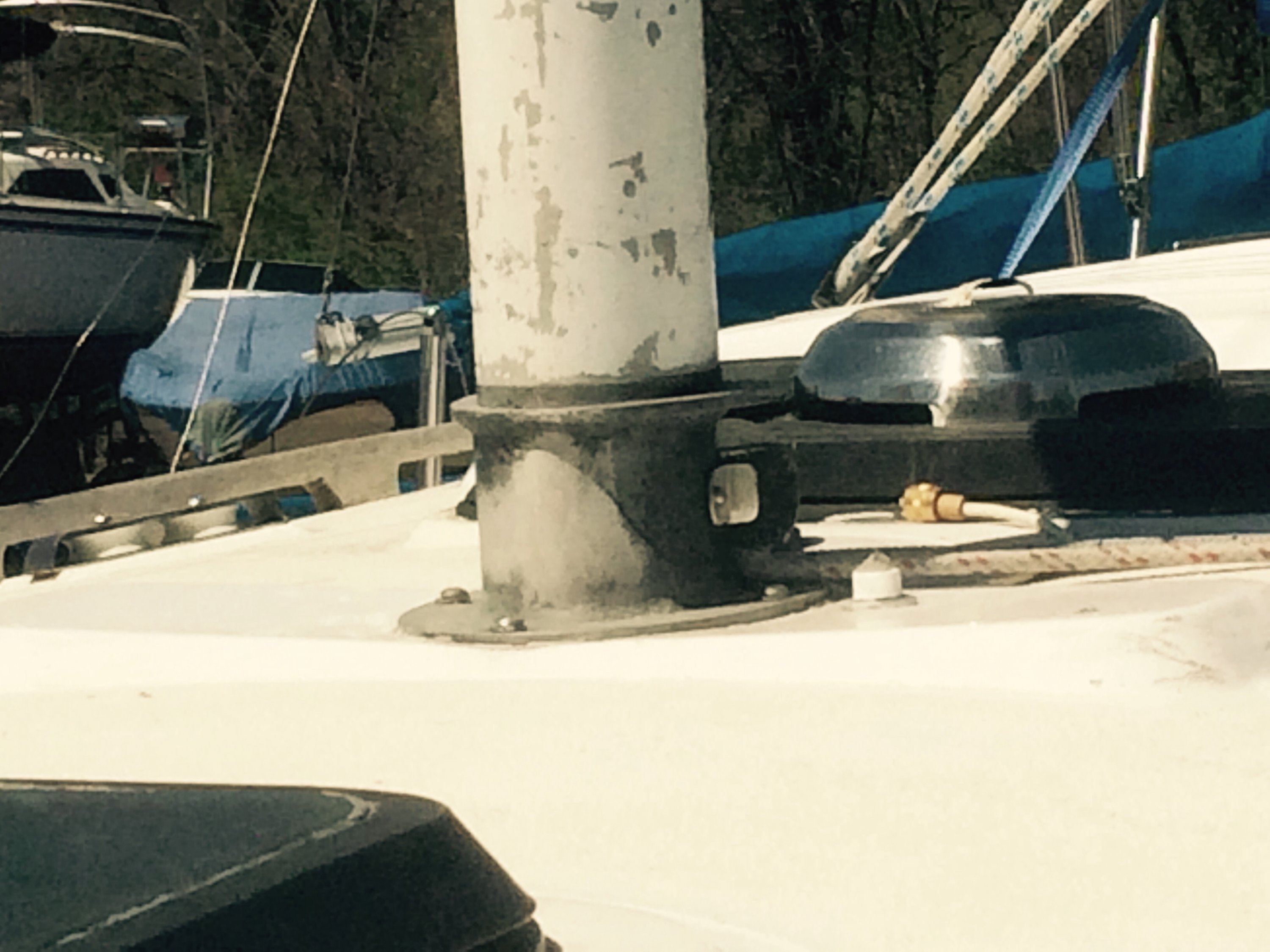

Here is a picture of the mast step on our '77 h27. You can see that the deck slopes up to the T shaped mast step.
That's the Niagra in the "background."

If you were to put a straight edge from the port side to the starboard side of that riser would you have a half an inch or more space at the mast?

A depression at the mast is not normal. Not sure why it would be. If someone else posts a picture showing theirs has a depression, it only means he has problems too.

Update...
After looking at dozens of pics of 30's and 27's, I realized something.
It's an optical illusion because the deck arches up in front of the step. I stuck a straight edge across that plateau and there was less than a 1/4" gap at the center.
Not something I'm gonna tear up the deck, sole, or compression post for this year!
