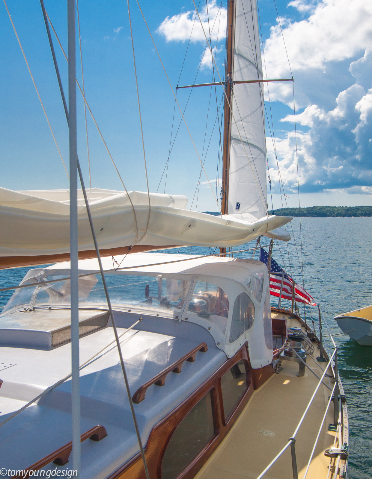

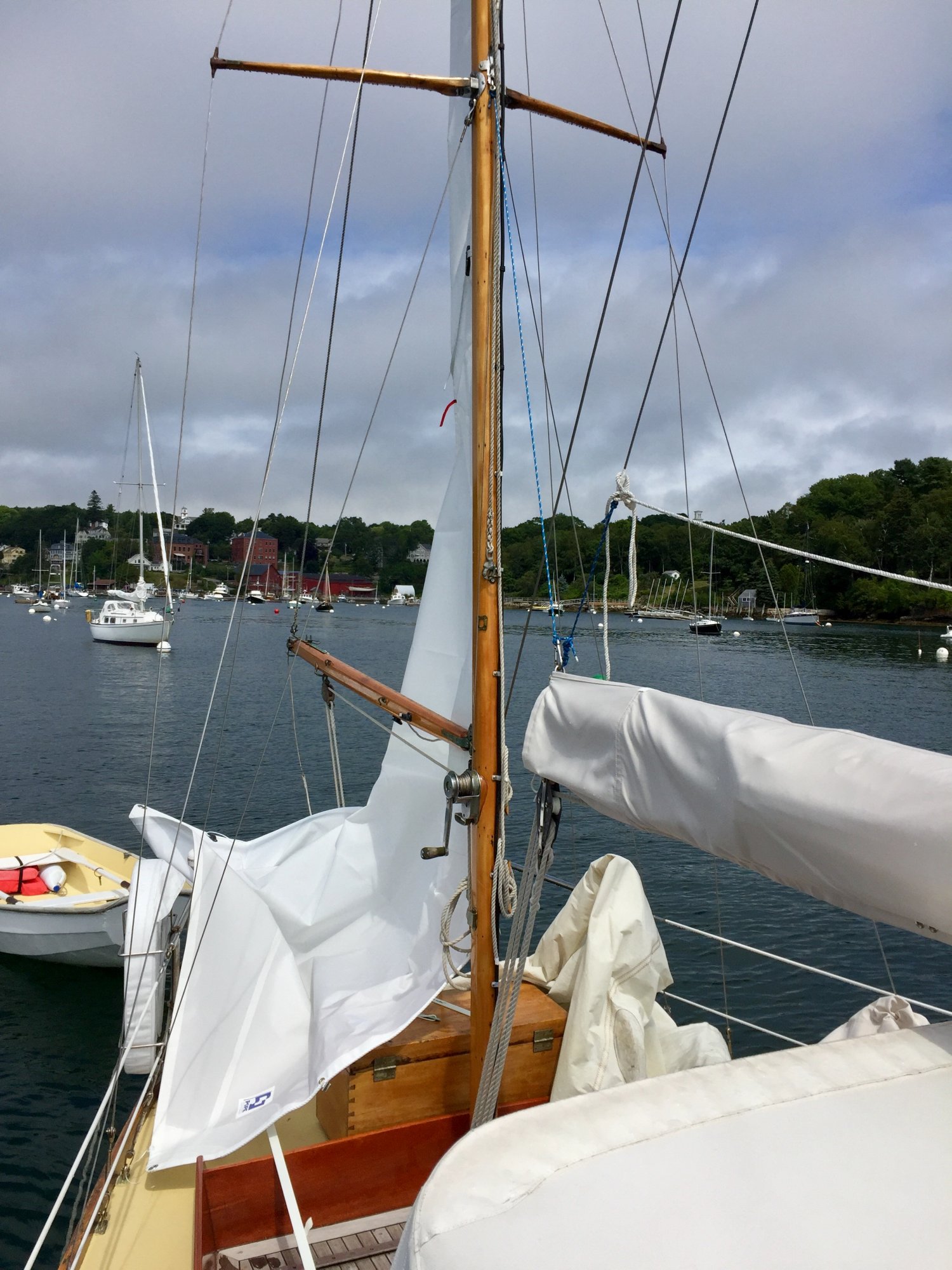

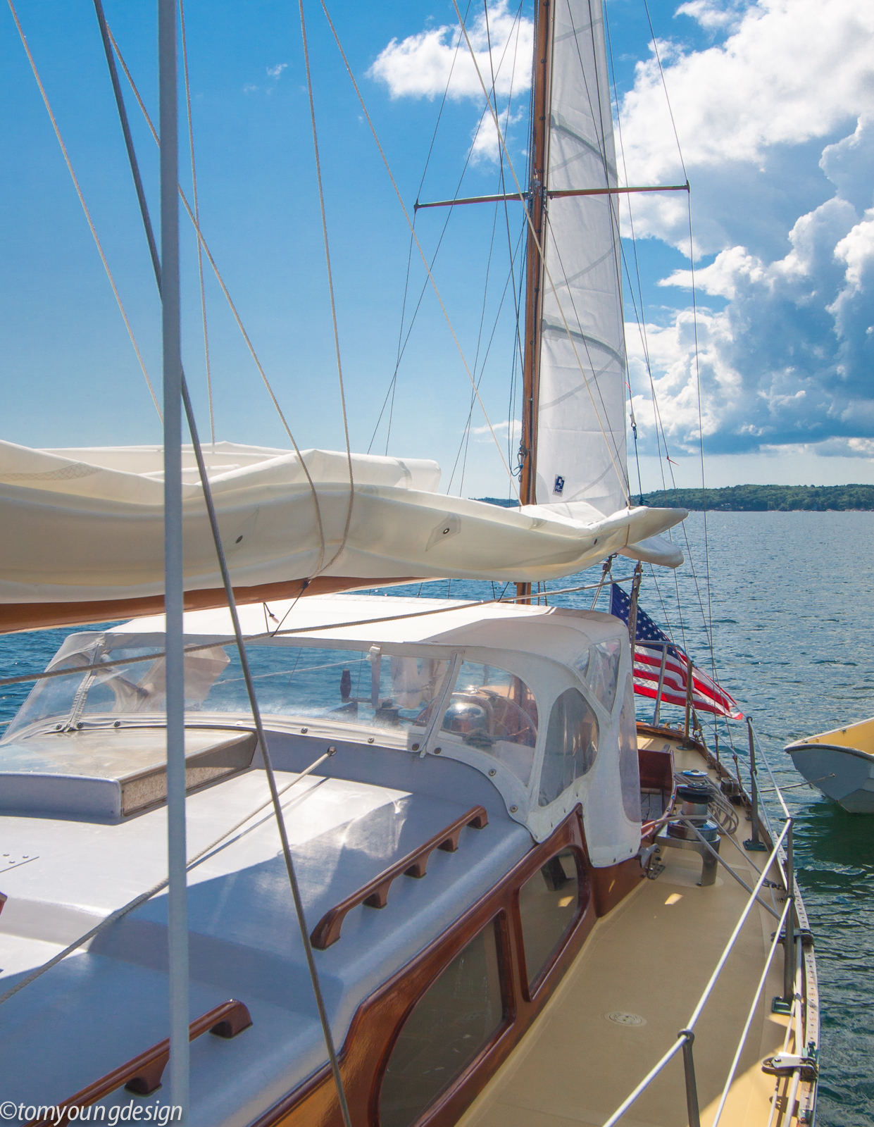

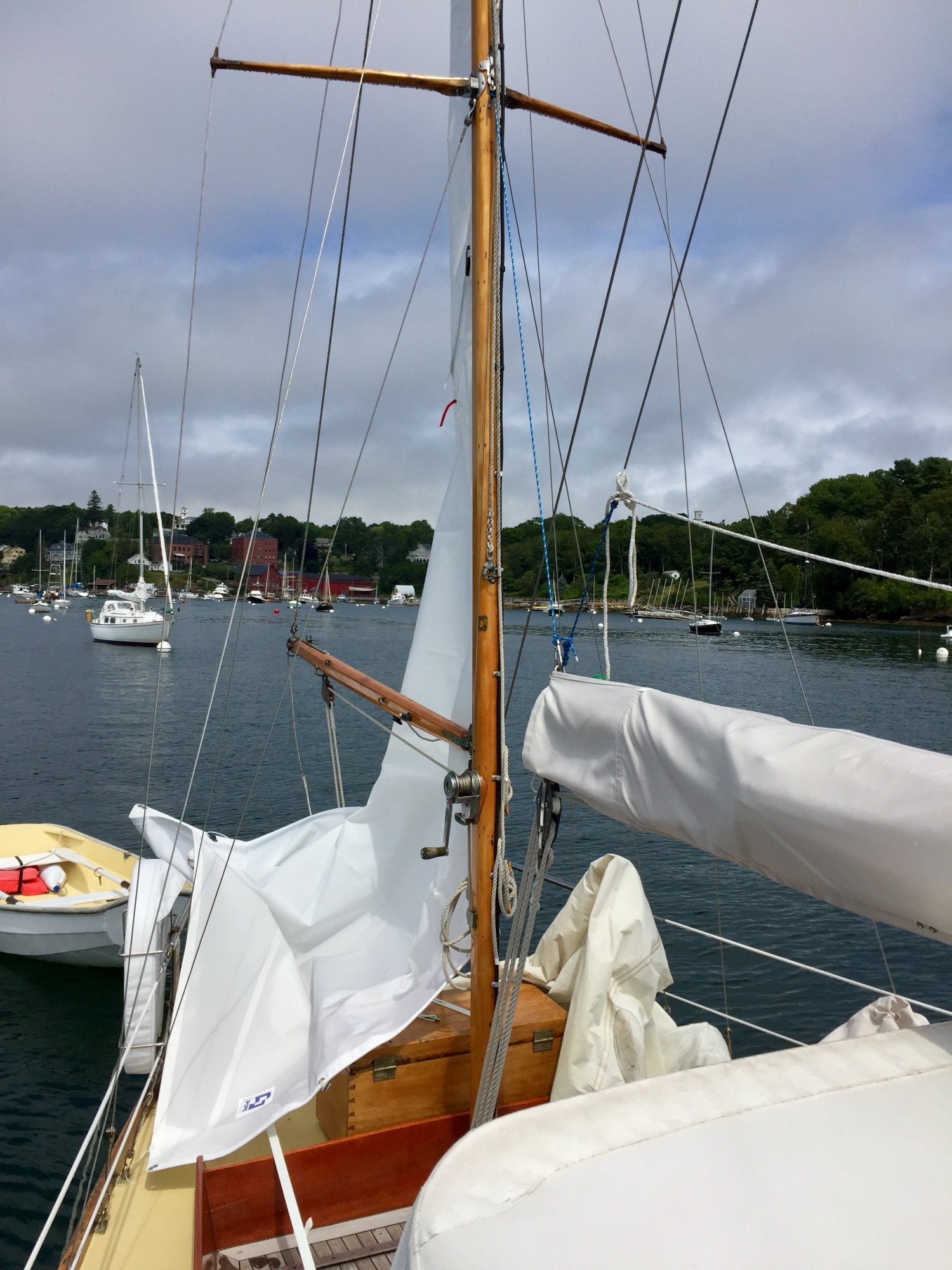

Mistakes happen. I was pretty excited to bend on my new mizzen main 3 seasons ago. Full battened, I put the battens in as it went up.
Then, the halyard winch jammed and stuck. Hmmm,... I thought a slide stuck somewhere but I couldn't see the problem looking up the mast. Then I saw, the head plate on the new mizzen, was tight to the mast head.
I looked down at all the sail still on the deck. Wtf?
Oh well, mistakes happen. Luckily it's a local guy who has built all my sails and sail covers, and he was devastated when I gave him the news. But he quickly turned around one that was the correct size.
I asked him if they found a home for that loooong slender mizzen sail.
He said no.
The new one:

14,182
He said no.
The new one: View attachment 188245
Ouch! That's a big mistake.
TomY
Alden Forum Moderator
Jun 22, 2004
2,769
Yeah. A tape measure has become like my third hand in my life. Yet, I make the same careless occasional mistakes. Often it's the dreaded 'inch trick' that gets me.
Anybody who fabricates or builds anything no doubt has suffered and re-learned the 'measure twice, cut once' adage. You can get engaged in the details and forget to re-check, re-check your design work.
That one above will stick with somebody (I think it was an assistant), for a long time.
