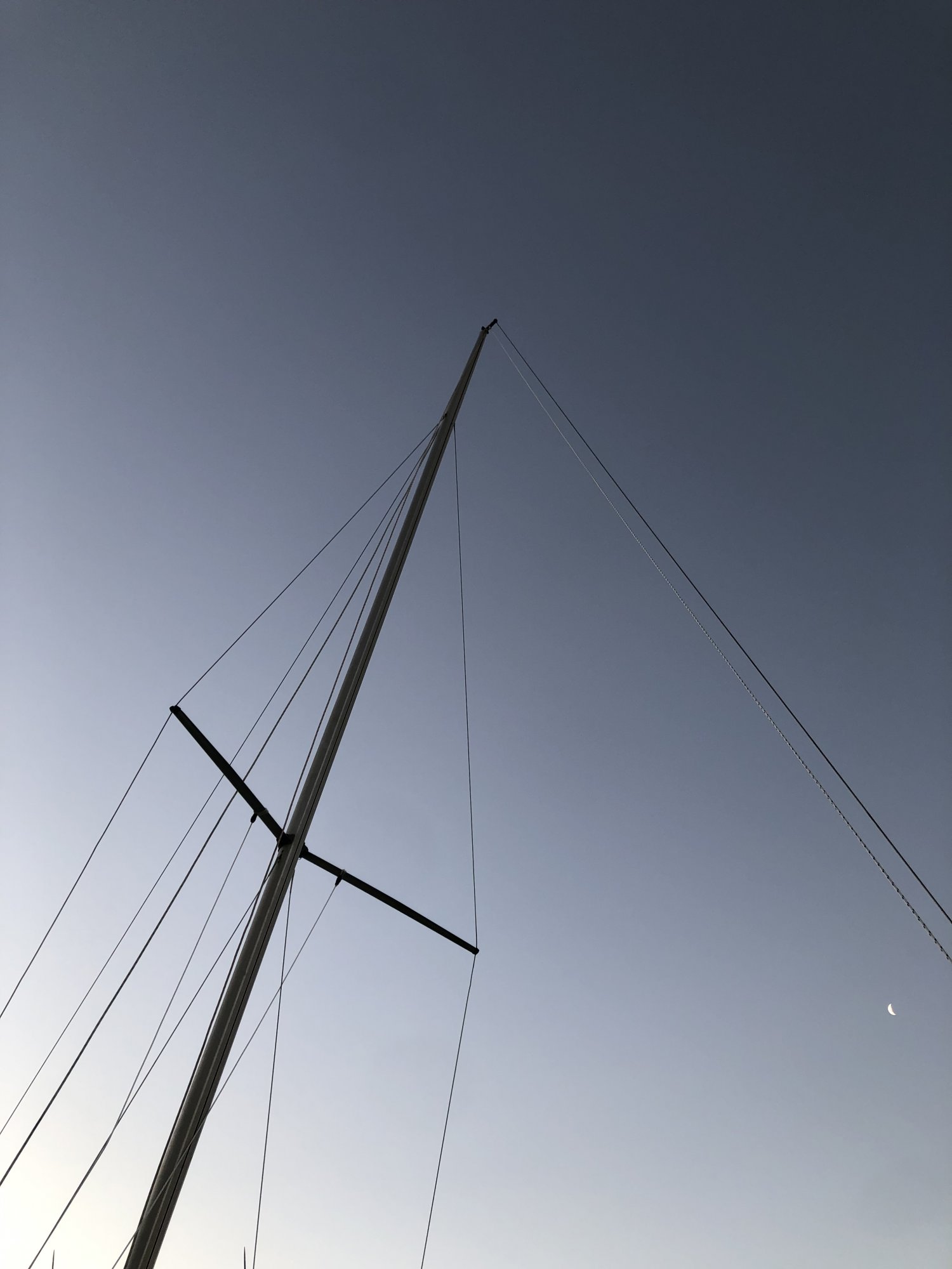

Pic of Hunter 23 Masthead for fitting main topping lift
Apr 8, 2024
2
hunter 23 brisbane
Hi all! Looking at fitting a topping lift to my hunter 23. It lives at a marina a long way from my house, so I have to prepare in advance when I do maintenance
does anyone have a close-up pic of what the masthead looks like, namely where I would attach a main topping lift?
main thing is - can I just shimmy up there and shackle it through an existing hole? Or do I need to lower the mast and do some drilling /riveting?
thnaks!

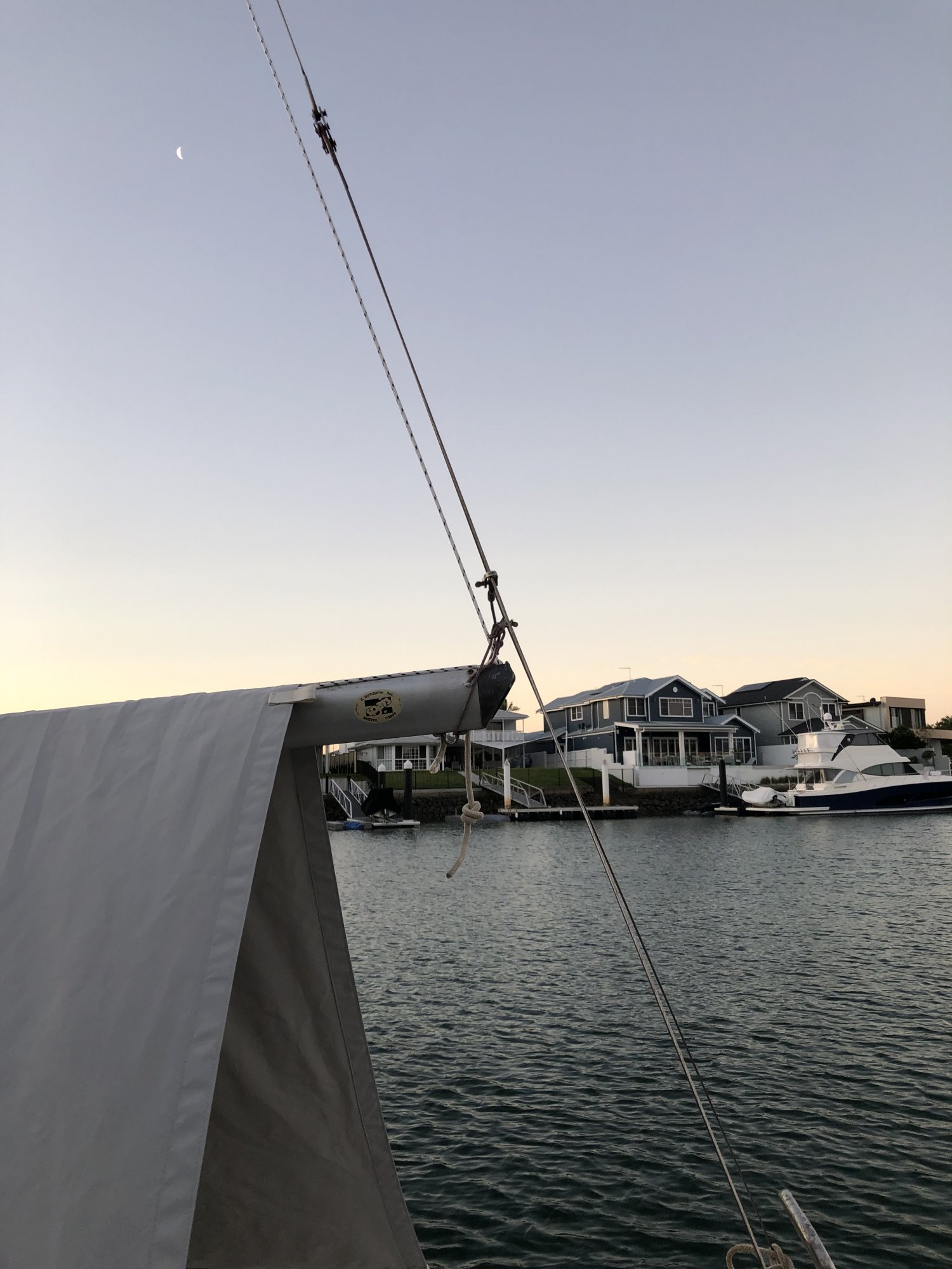

Thanks all for your input. Dropped the mast over the wknd, attached the topping lift to the masthead and lazy jack lines to the spreaders. Also discovered some rusty pin-fasteners so replaced them (no one wants those to break mid-ocean). Next job is the Bimini, will see how I go and keep you updated! Thanks again, happy Huntering!
