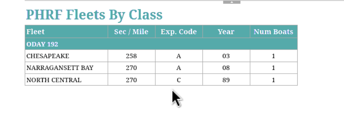

The numbers that David found above (post #4) might indicate that the boat is quicker in Chesapeake Bay's light air than in places that might be windier like Narragansett Bay. Perhaps it is easily overpowered, heeling too much for optimal forward speed. Your PHRF Committee will take local conditions into account when they decide on a rating for you.
I'm Race Director and PHRF Committee. lol

Good luck then. We have more than 2700 different standard classes in our YRALIS PHRF database and no O'Day 192's.
