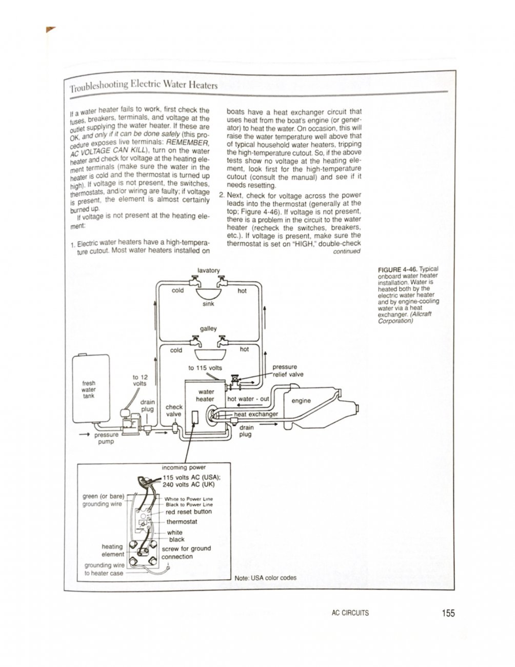

14,029
@thinwater, yes it is one way of installing a tank. Here's a schematic from Calder's book (3rd edition). Raritan uses a expansion tank with a check valve between the city water supply and the expansion tank. When Sabre built my boat, they used a check valve. Obviously it is important to have an appropriate and working pressure relief valve. Raritan recommends a 50 psi valve.
Without a check valve the whole plumbing system will act as an expansion tank, the HW will back up through the system and eventually find the water tank. That would not be a big problem, except it puts scalding hot water in the cold water hoses. If the cold water tap is opened it will pour forth with scalding water and not cold.
