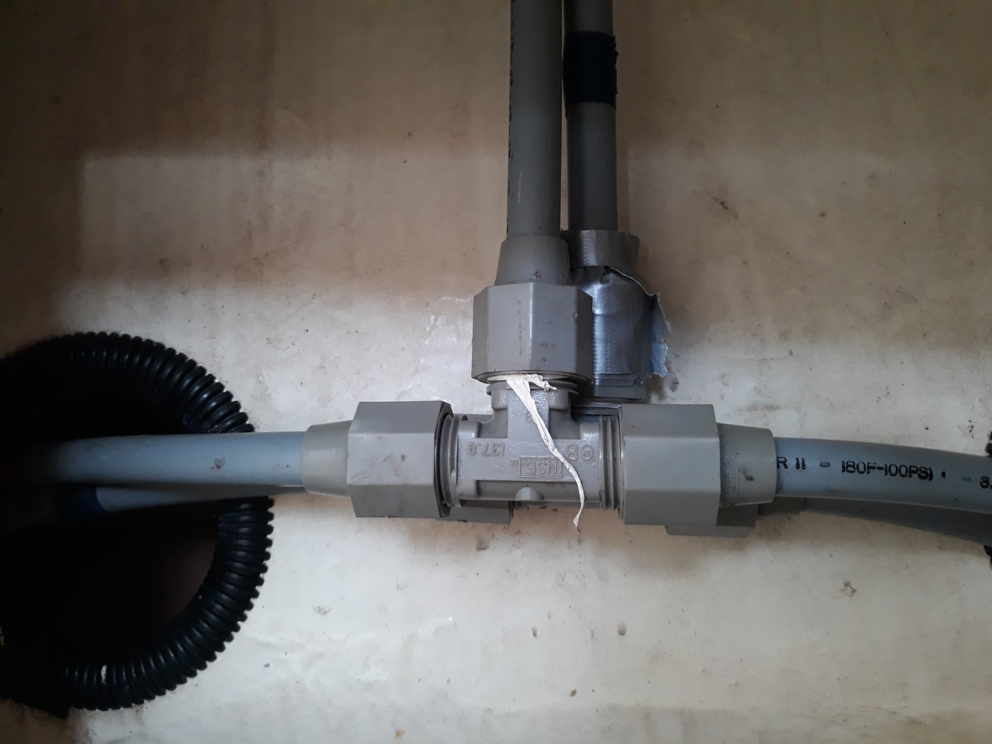

I own a Hunter Legend 40.5 1996. It comes with PEX piping. See pic attached.
I've found that chlorine affects PEX piping, but I am unsure if this is the case with all PEX or only the early forms of it.
What is your experience?
How do you disinfect water for those that have PEX plumbing?

Thank you CHP, I put the pic cause I wasn't sure.
And do you use chlorine on the tanks?
I started using chlorine after I cleaned the tanks for the first time.
By the way, bow and stern tanks don't have inspection hatches, which I had to install.
And water here in my club comes from a reservoir (where I learned today capibaras swim and refresh themselves... )
So aside from changing source now, I have been applying chlorine.

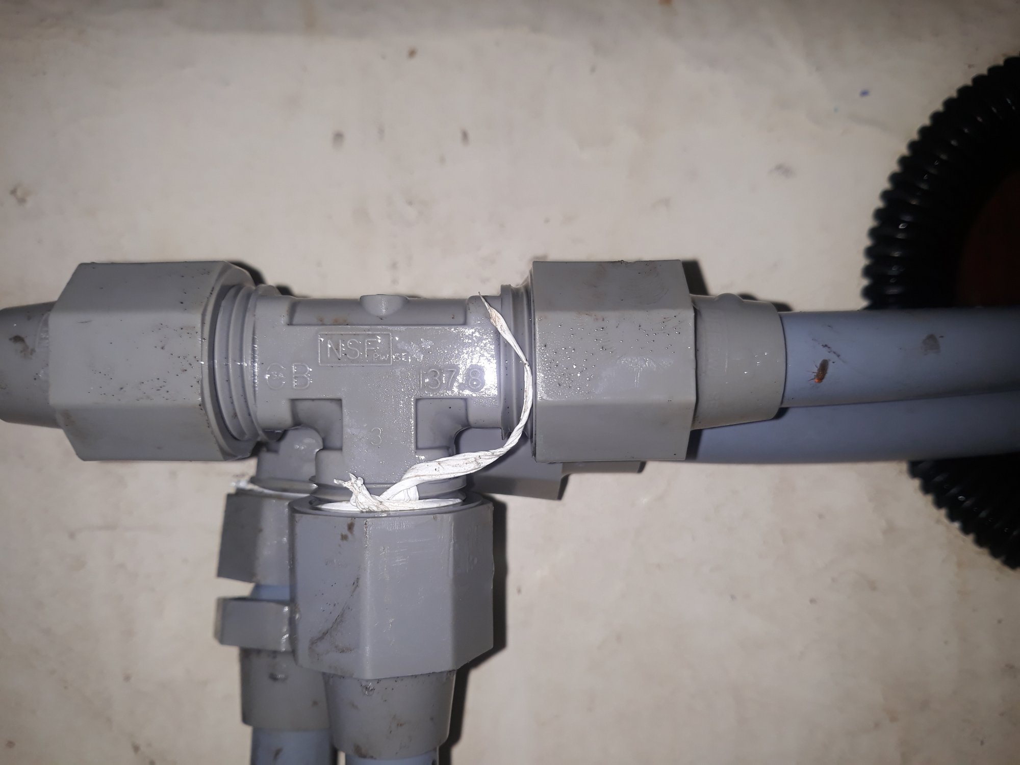

If you see the pic you'll see the nut is cracked.
No pipe has leaked yet. But I am afraid of ruining with chlorine.
Boat is from 1996 I should suppose by then these pipes were made to tolerate chlorine?

I had two nuts cracked. No pipes leaking yet.
Not having spares here in Brazil, I fixed them with instant glue and duct tape.
Working good still after over one year...
