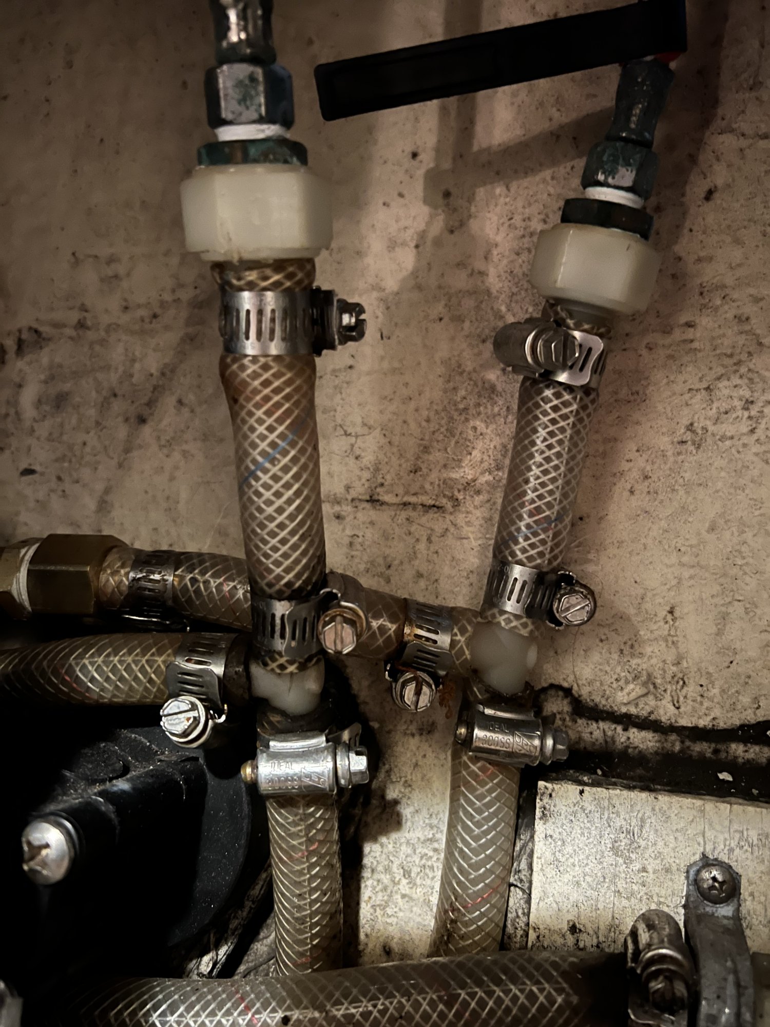

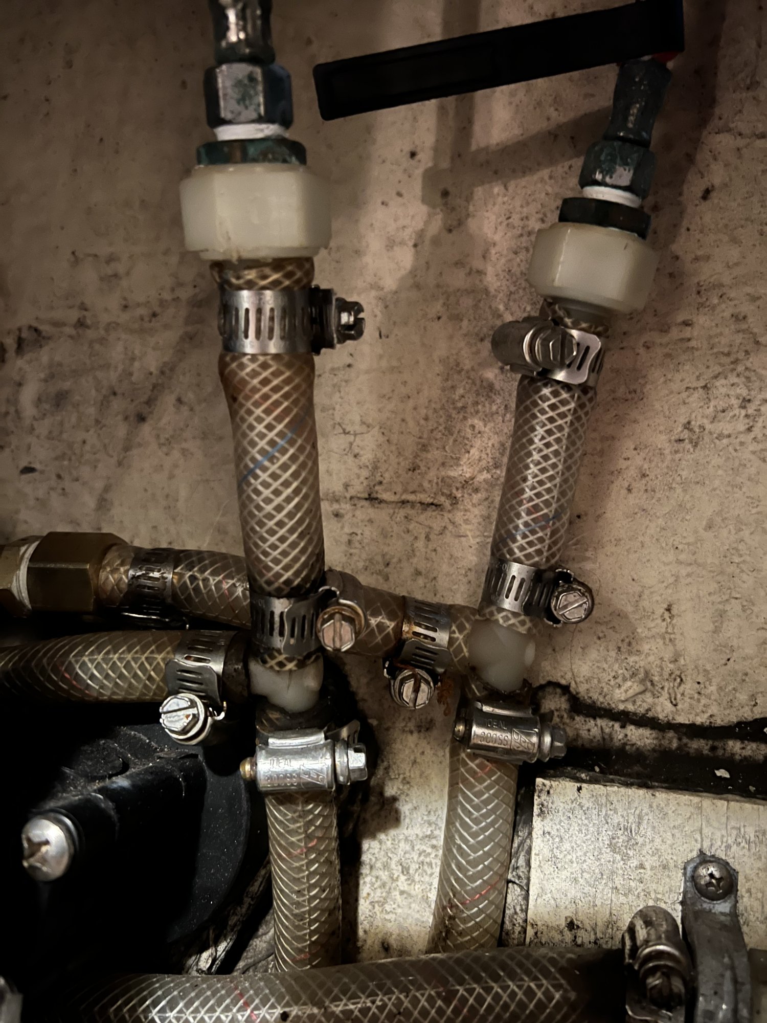

Our boat and hoses are 22 years old. Having worked on them they seem to be fine. I don’t see any signs of swelling or cracking (see attached). There are hundreds of feet of hose and it would be a mammoth job to replace them all.

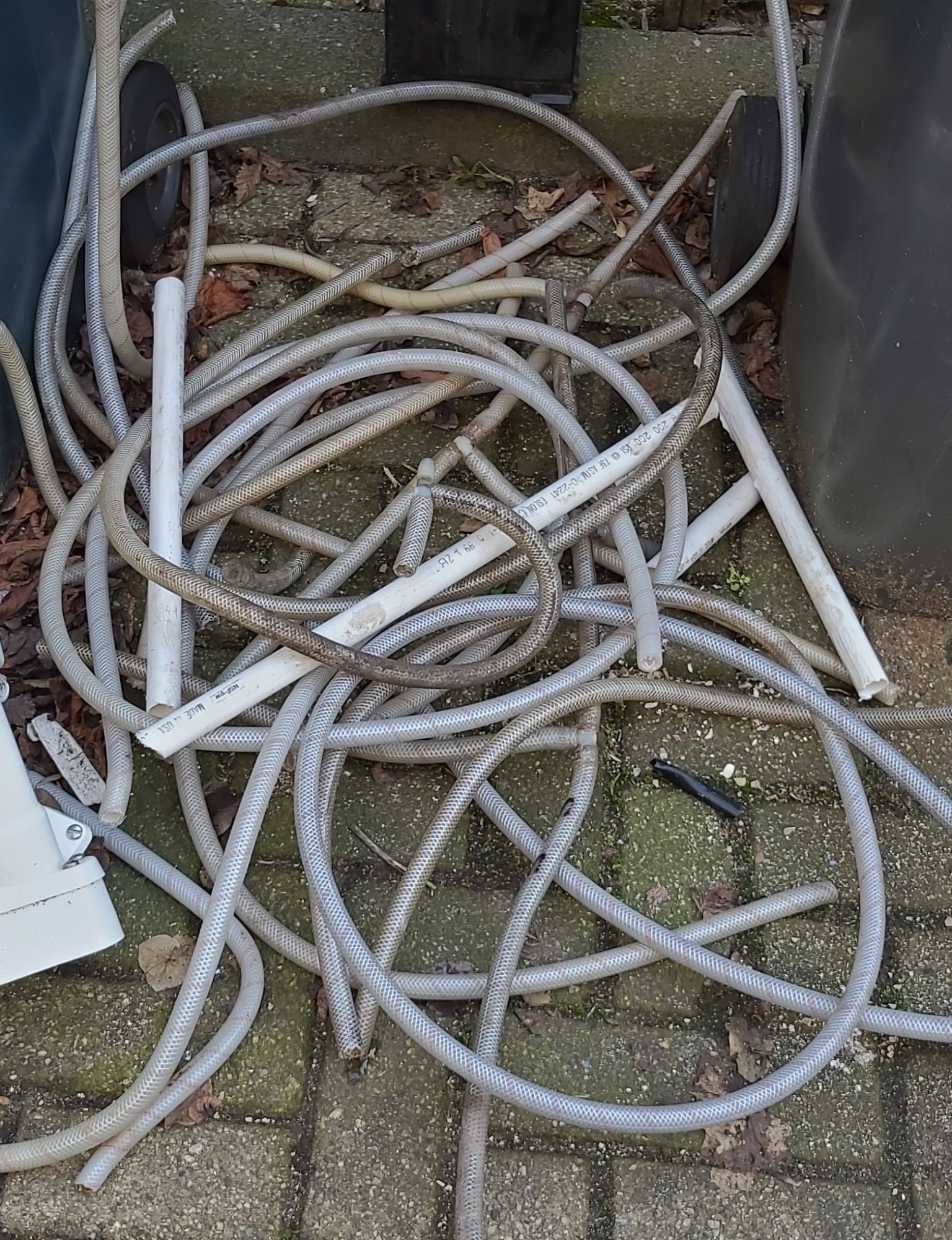

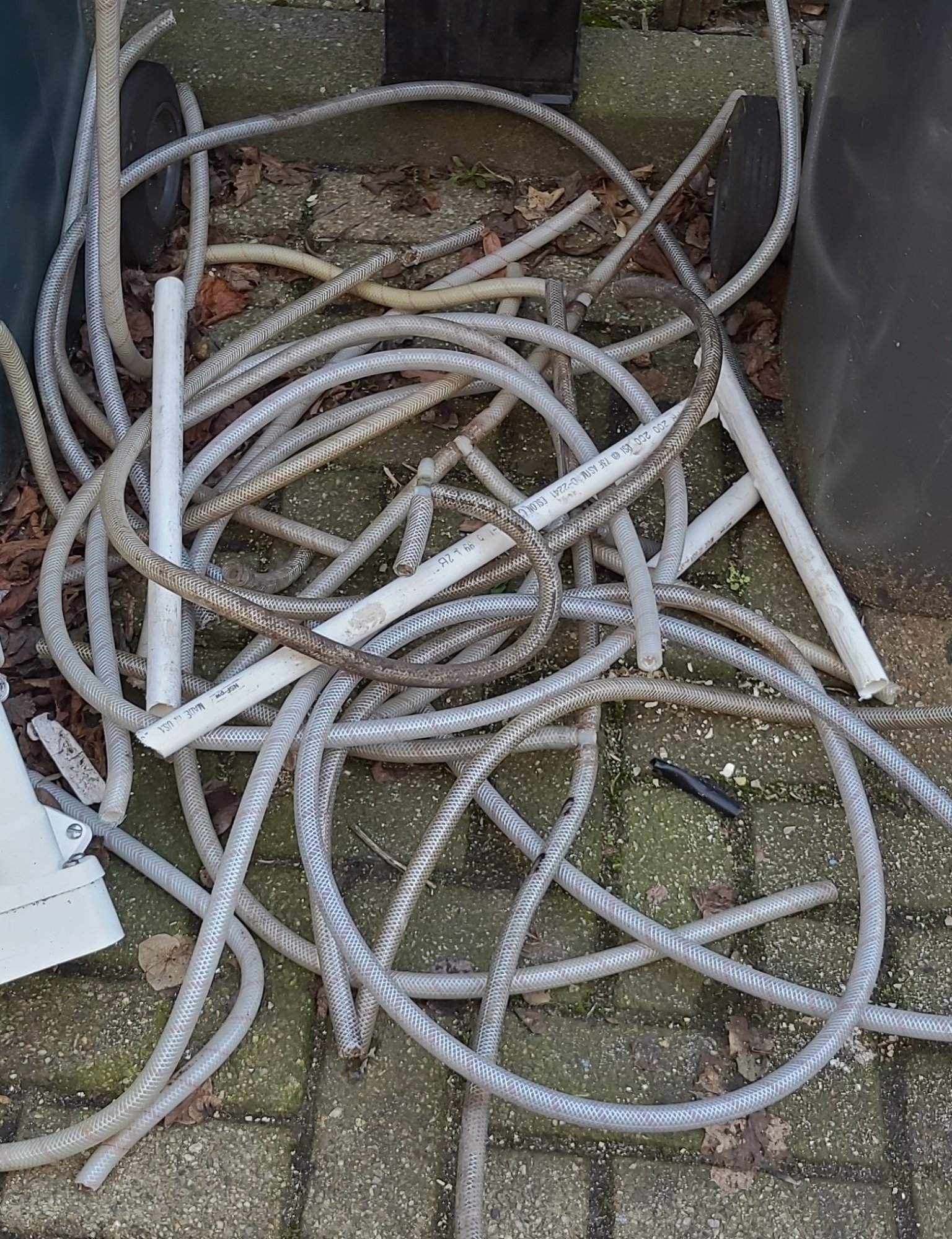

Hello , In our cat there were hose connectors in places you can't reach ... i ript it all out and found many leaks/lose clamps.
We had the issue that the waterpump turned on every 10 minutes. notice how bad and discolored the old hoses are!
we are going for all new and i'm moving the T connectors so they can easely be checked. Specially the ones around the heater.

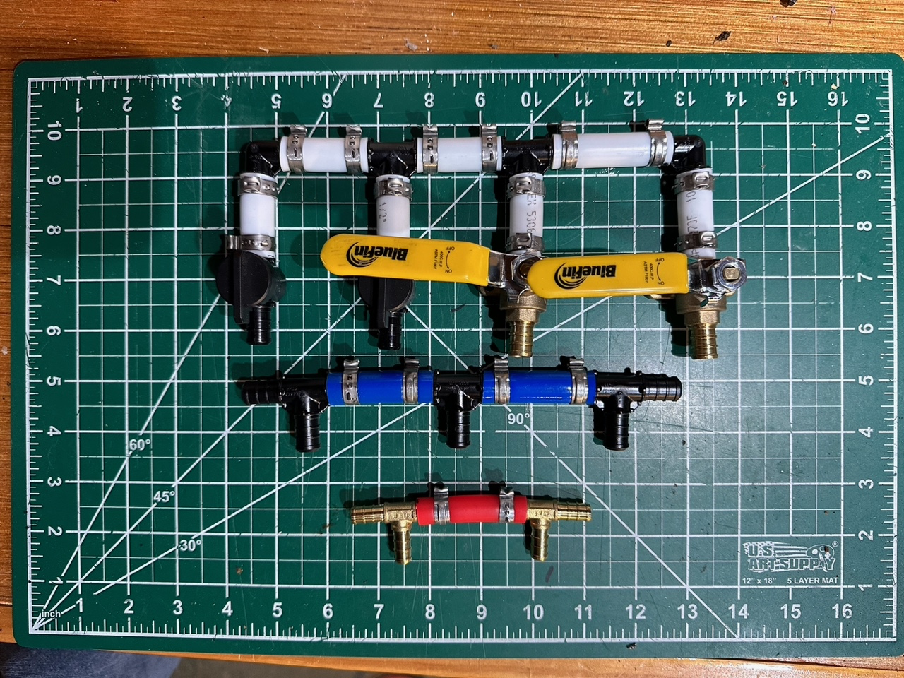

Last year I chased leaks all over the boat. The last leak I found was in a difficult to reach space. This year all the vinyl hoses are being replaced with PEX. This should last long after I'm gone. The new manifolds are below, white hose for unpressurized water from the tanks, blue for cold water and ⅜" red for the hot water. I'm using the smaller diameter for hot water to reduce the amount of water that must be drawn from the hose to get hot water at the sink.
