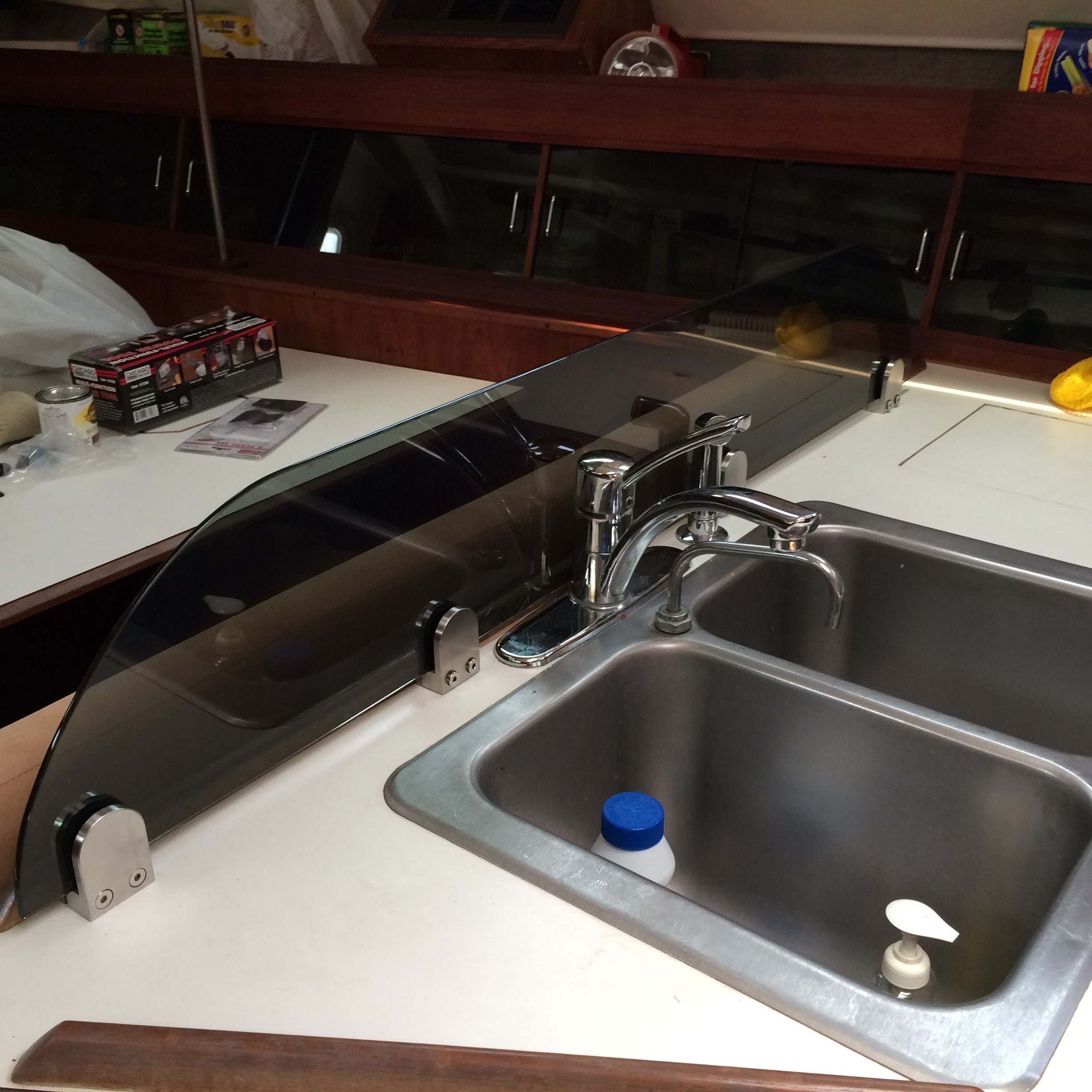

I will be putting dishes in a square bucket and putting salt water in it to wash. I wish I had a salt water option for the sink. Certainly an option

My PO had installed a Whale foot pump to route salt water to a spout he'd installed on the sink separator .. really is a nice thing to have and easy to use .. ya step on the little pedal and salt water comes out.
