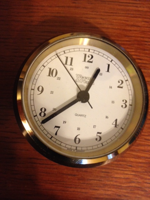

I have an interesting problem with my Weems and Platt clock. When the clock is on shore, it keeps near perfect time for months. I gained less than a minute from October to today when compared to my atomic clock. However, when I put it onboard, it loses time consistently (at least a half hour a week, but sometimes more). This is regardless of whether it is mounted in its base or not. This occurs even with a new battery. There is no corrosion on the terminals, and I even had a clock repair shop look at it and declare it to be in perfect working order. I'm at a loss as to what might be causing this Jekyll and Hyde behavior on the part of this time piece and would appreciate any theories/insights from the collective wisdom as I try to solve this dilemma.

I would venture a guess that the difference is related to temperature/humidity. About all I know about this subject I learned by reading Longitude. The challenge to make a chronometer was for it to lose the same amount of time in varying conditions. Unless your clock is a chronometer, it has not been designed or built to account for those environment changes.
If it is a chronometer, well I'm stumped.

When you bring it home... leave it outside or in an unheated shed. Any difference?
I think I'd call Weems & Plath for an explanation. Maybe the clock is for decorative home use.

Dumb question, but is the battery loose or maybe a wire loose and when sailing it bounces around a little?

We had a similar issue with the same clock so I bought the clock guts at an electronics shop for $5 and fixed it myself.

You don't say how old the clock is.
There are going to be two major components there. One is electronic and consists of a crystal controlled oscillator (very often a multiple of 32,767 Hz) with digital divider to get a 1 second pulse out. The other is a mechanism to make the clock tick in response to the 1 second pulse.
Either the electronics are skipping some pulses or the mechanism is sticking and not ticking on every pulse. I would put it in the fridge and see if that causes it to lose time. If it does then see if you can stop it by freezing the electronics. If that does not work then look for mechanical sticking, especially if it more than about 5 years old.
Also, the advice to carefully clean the battery contacts is worth taking.

Is it affected by magnetism like your compass?
Is the clock mounted near a stereo speaker?

Some interesting points to consider. Based on my finish in the last race I participated in, I'm ruling out the "sailing really fast" option. Of course that could be the skipper. I've attached an older photo showing the clock's location on the bulkhead. http://forums.oday.sailboatowners.com/album.php?albumid=2158&pictureid=13853. You can see it's near an electric fan (always off on the mooring), an electric light (usually off), a compass mounted below with a backlit device (usually off), and a speaker (often on when I'm on the boat). It does seem to lose time even when all those devices are off for a week or so.
I'll put it in the garage for 24 hours (will be below freezing for the next few days) and see if there is any difference in keeping time. The terminals are clean and the battery is relatively new.
If I can't figure it out, there is an upside. "Sorry I'm late, the clock on the boat showed I still had an hour" is a nice option sometimes.
Thanks for the ideas. I'll see if I can narrow this down.
