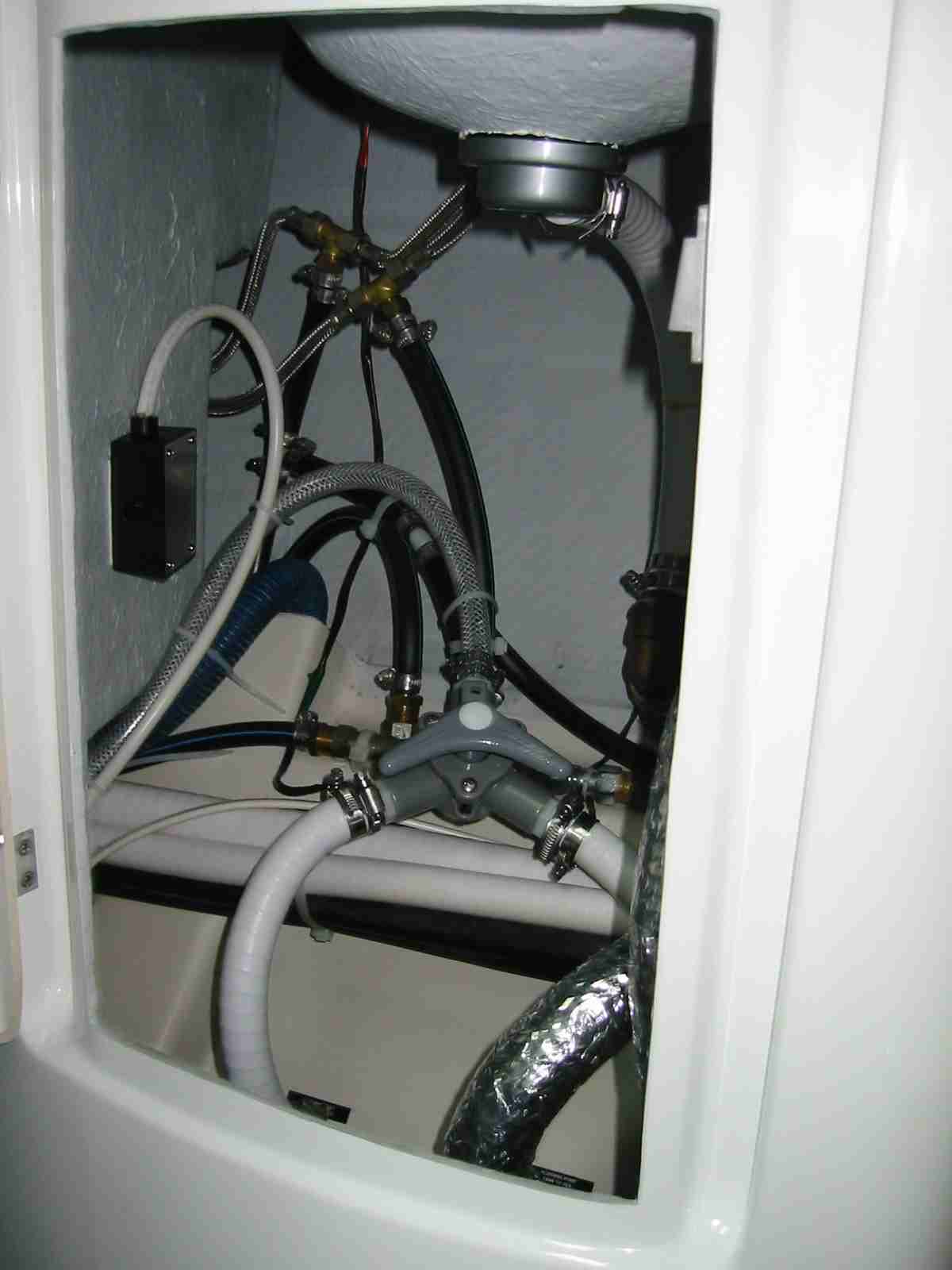

Aluminum foil tape worked for me.
John, my permeated hoses have been covered with aluminum tape for 2 and 1/2 years and the stench is has not come back. This is despite the poor sanitation system design including a small and elevated holding tank and some of the hoses always keeping stuff in spite of thorough flushing. Covering the hoses with the aluminum tape, sold at Home Depot for about $15, was easy and did not require the disassembly of any hose. There was only a short segment I could not reach but fortunately, it does not have much of an effect. Peggie, I am in the Beneteau owners list. My e-mail is: jgvenegas@hotmail.com
