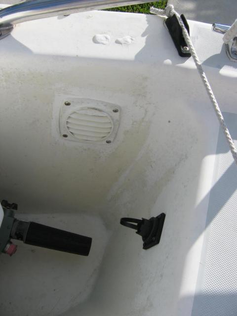

Yes, BB, I did it on my 1990 26S.
If you want a gas tank in the lazarette, you need to do a whole package: deck, gas tank, deck fill, external tank vent, lazarette intake and exhaust vents, power blower, and bilge pump.
I first installed a deck in the lazarette to level the floor; this was about 4" above the bottom of the boat at the forward bulkhead, and met the bottom about 6" from where the bottom turns up on both sides, and at the joint between the bottom and transom at the stern. The deck was made from pressure treated plywood resting on pressure treated 2x4s, all covered with a layer of glass cloth and plastic resin, then painted. Be sure to leave some notches in the stringers so water won’t get trapped between them. I made provision for mounting a bilge pump under the deck just behind the forward deck.
I mounted a rectangular 18 gallon plastic tank on the centerline, strapped to the deck. A combination deck fill and vent was installed in the engine well in a position so that I can get a gas nozzle into it easily. The tank is connected to the fill with a piece of 1 ½" gas hose that was outrageously expensive; the vent hose was pretty cheap.
I installed an intake vent in the front bulkhead so it will scoop air from the cockpit. I installed an exhaust vent in the aft starboard corner of the lazarette hatch. For the exhaust vent, I put in a piece of plywood in the corner of the hatch opening to support a 3" dia. flexible aluminum duct which goes down almost to the deck. Just below the hatch opening, I installed a 3" power blower in the duct.
Some of this may seem like overkill, but its what is needed for my understanding USCG and state requirements. I have used this for almost 2 years, and it works well, and I’m happy with it. Of course, I’ve not needed 18 gallons of fuel at any one time yet, because I haven’t taken any long cruises. The first time I took the boat out, I put in 12 gallons of gas. A year and a half later, I still had 3 or 4 gallons, so I put in another 5. Now, 2 years (give or take a week) I still have about 4 or 5 gallons. I figure its better to have it and not need it, than to need it and not have it! -Paul

BB, I forgot to mention that while I was having so much fun in the lazarette, i reworked the cockpit and engine well drain plumbing so that it is against the bulkhead and side of the boat where it is out of the way and doesn't interfere with storing stuff in the lazarette. I took the opportunity to install a Tee in the line for the bilge pump, too. -Paul

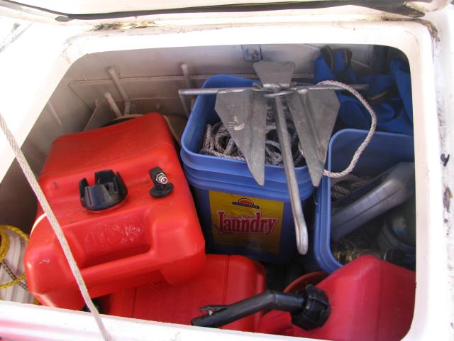

After installing a 10 gal tank in the laz (regular portable tank), venting the tank, venting the laz, adding a blower - I am now going to rip it all out and use a 1 gal tank that'll fit in the motor well.
Why? Because it's more of a PITA to fill what I expected. To remove it for "legal filling" I have to empty half the laz and almost fall in to reach it. When full, it's VERY heavy to lower and place. I fill it in place with a funnel sometimes. Still have to empty enough junk to reach the tank. Then there is always some dripping from the gerry can/fueling process. It takes a long time for even a few drops to clear from the laz.
Finally, one gallon gives me over 2 hours motoring with my Yammy 4 stroke. We only use it for about 20 minutes to get in/out of our slip.
To make things easier I plan to carry another 1 gal tank in the laz instead of a gerry can. Then I just switch tanks that "once in a blue moon" motoring session.
Of course there is the aspect of actually being legal, compliance with marina rules (Clean Marine program, etc.), INSURANCE IMPLICATIONS and the obvious safety issues that are all resolved.
Something to consider anyway...

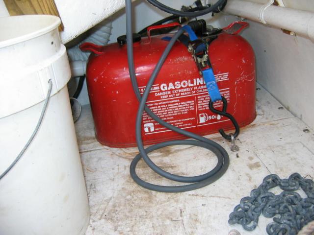

We do a sort of hybrid (the latest thing, right?) setup where we strap a six-gallon tank down on the raised floor of the laz. We average two gallons of fuel every three trips out the channel to the Gulf, so we use a 1-gallon can to ferry fuel when we need it. The strap on the larger tank is loosened so that we can swivel it towards the hatch, and we use the dripless type of spout, making sure that there is at least room for the entire gallon so that we don't have to stop mid-stream (which we all know can be very difficult). The blower can be seen in the back corner connected to the vent (dryer) hose which goes up to a grill exiting to the motor well. Although we don't use the power vent much, it's nice to have when we get our inspections done.

BB & Sum- The 18 gal. tank I put in my 26S is similar to the MOELLER
ones shown in BB's picture. It is connected by a gas hose to a deck fill mounted in the side of the the motor well. The deck fill has an external vent that is connected to the tank vent with a separate hose. You can fill the tank from jerry cans, or simply stop at a gas station and use the gas pump- there's no way to spill gas in the lazarette. With the two laz. vents I added, and the blower in the exhaust vent duct, the Coast Guard requirements are met. The exhaust vent takes air from just above the deck in the lazarette, where any fumes from any source will collect. By strapping the tank in, it can be removed if you need to work on it. Its also nice to have the electric gas guage (mounted in the bulkhead aft of the cockpit, just forward of the motor well) so I know how much gas is there. -Paul

-Holdech, I have 2) 6 gallon portables in the laz, (2cycl mix) and fill them with a clear hose from jerry jugs. (about 1" diameter) the hose is NOT fuel safe, (from HD), but it has worked well for me, and I flush it w/ water after use. you could find one to fit a nozzle from the gas station. I like you can see the fuel going in..
