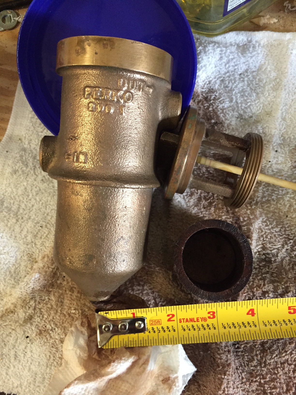

The first filter downstream of the diesel fuel tank in our '82 Hunter 36c is a brass-bodied Perko 299 1 (?, hard to read the numbers on the filter body) filter. I believe it is the original filter. Downstream of the Perko is a Racor, and then the engine mounted filter. Does anyone have a source to obtain new Perko cartridges?

Thanks to all responding to my Perko filter question. I contacted Perko and received a quick response that the filter cartridge part number is 0324001ELM. Was able to buy a few for about $15 ea.
