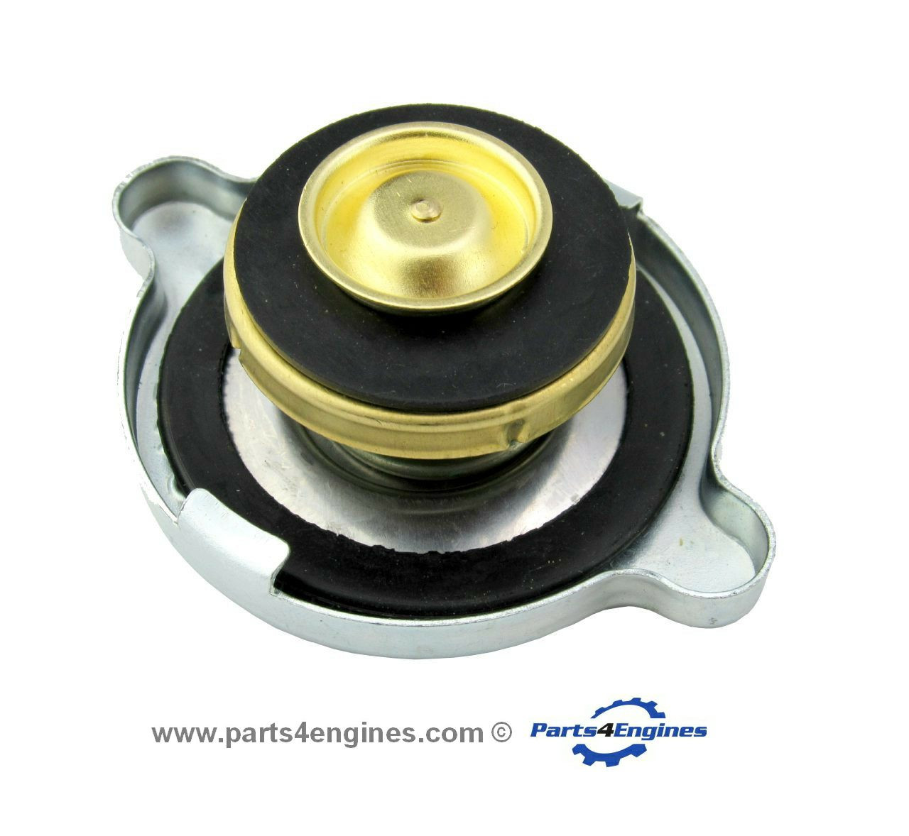

Be careful replacing the pressure cap. There are two different ones with different heights. Check your engine service manual to be sure you get the correct one. Or if you know that yours is the OEM, measure so that you get the correct one from Parts4Engines in the UK. They may also have a replacement overflow tank.

In your picture you posted from PartsforEngines.

I've tried them in the past but I find Parts4Engines to be about the only source. Their prices and shipping are reasonable and they ship real fast. Also if you have an MD22 you have or will be replacing the exhaust elbow connector. They sell a stainless one that will hopefully will last a bit longer than the stock aluminum elbow which disintegrates after a few years.
