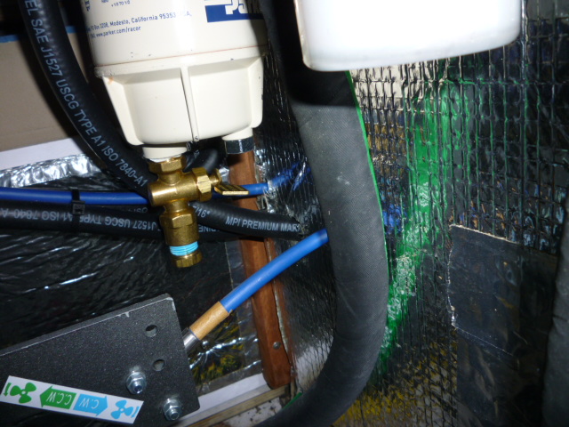

After I dropped the filter plug into a narrow glass I was capturing the fuel with, I added a petcock to make checking for water easier. I bought mine at McMaster-Carr, part no. 7910K83. For extra safety, I screw the plug into the end of the petcock. It looks like:
