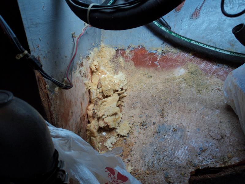

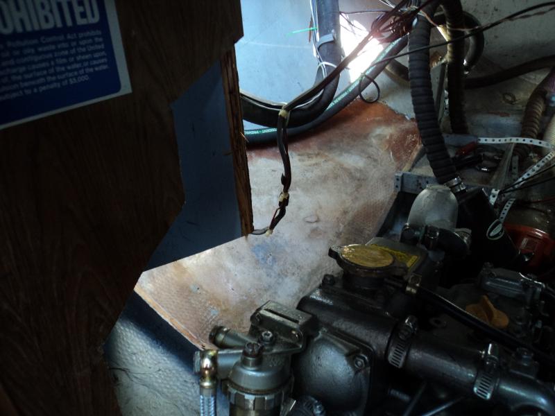

Fuel Tank Project Update:
I spent Wednesday in the engine/fuel tank area removing the soaked plywood. The fuel was insidious! Pictures show the stages of the removal starting with the last bits of the saturated foam under the tank and continuing to the views of the area ready for the rebuild of the effected areas of wood including the bulkheads of the wet locker (which will soon house our water heater......Oh, great, another project!) and the longitudinal bracing for the inboard side of the fuel tank. That plywood, by the way, forms support for the wet muffler, and the holding tank aft of the muffler. While I'm at this project I will be replacing some tubing that is probably original.
Email contact with RDS Manufacturing in Perry, FL has provided original drawing and build info of the tank and I will contact them today to build the new one that matches the original. Thanks to members for reminding me that is the best course of action.

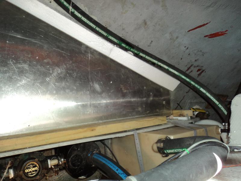

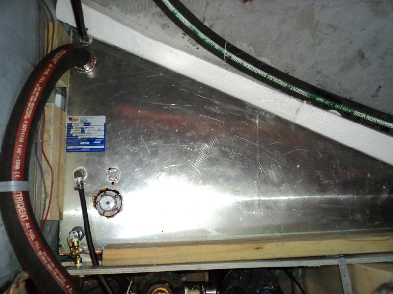

To describe Friday as "Good Friday" would be a misnomer in our case. Eileen and I spent a L O N G day at the boat removing the fuel tank. We had tried all arguments possible to avoid that project, but the bottom line was: the fuel tank is leaking. I had pumped the tank empty on Monday and had stored the smelly juice in containers on deck.
The decision to remove the tank was followed by trying to figure out just how to remove it. Initially all hose connections to the fuel tank were removed, and the holding tank with its associated tubing had to be moved. (It may even find a new resting place if we decide to reposition the fuel tank.) We cut the retaining plywood to the inboard side of the fuel tank for a distance of 28 1/2 inches. Thank heaven for the Fein Multimaster tool! With a combination of prying, lifting, pushing, and gouging out styrofoam we finally moved the tank. From that point the removal of the tank was pretty easy. It actually slid out over the engine once a few protruding parts were removed from the engine and engine area. That included the battery charger, the air cleaner, a drain hose, and just moving the shift cable.
The point of my post is this: aluminum fuel tanks corrode and eventually leak. That should come as no surprise to any of us, but when it happens be prepared to work your butt off. Our tank lasted 28 years. We had nearly convinced ourselves that someone (surely not us) had accidently drilled a hole in the tank while installing some errant screw in the area. Maybe we could locate the hole and patch it. JB weld was suggested by more than one person. Our investigation started by checking all fuel lines and then opening a small inspection area in the lower, forward corner of the fuel tank retaining plywood area. At that point we found saturated plywood and oozing fuel. A repair project became a replacement project.
Finding a replacement tank has proved difficult. The original aluminum tank is a 21 gallon tank that is triangular and its bottom is slanted both to the outboard side along the side of the hull and slanted aft along the shape of the hull. I am looking at Moeller tanks of various rectangular shapes and sizes to fit onto a shelf that I will install. It seems that I will be limited to a 12, 13, or 15 gallon tank in plastic. I do not have final dimentions because I have another day of cleanup before the soaked foam will be removed.
I have attached some pictures for your enjoyment. Our boat is a 1986 Caliber 28 that we have owned since August of 2013. We enjoy the boat's sailing characteristics and are excited about getting her back into the Chesapeake Bay again by mid May.
Notice: (1) There is no room to spare. (2) It's good I'm no heavier. (3) Pitting and discoloration on the tank.

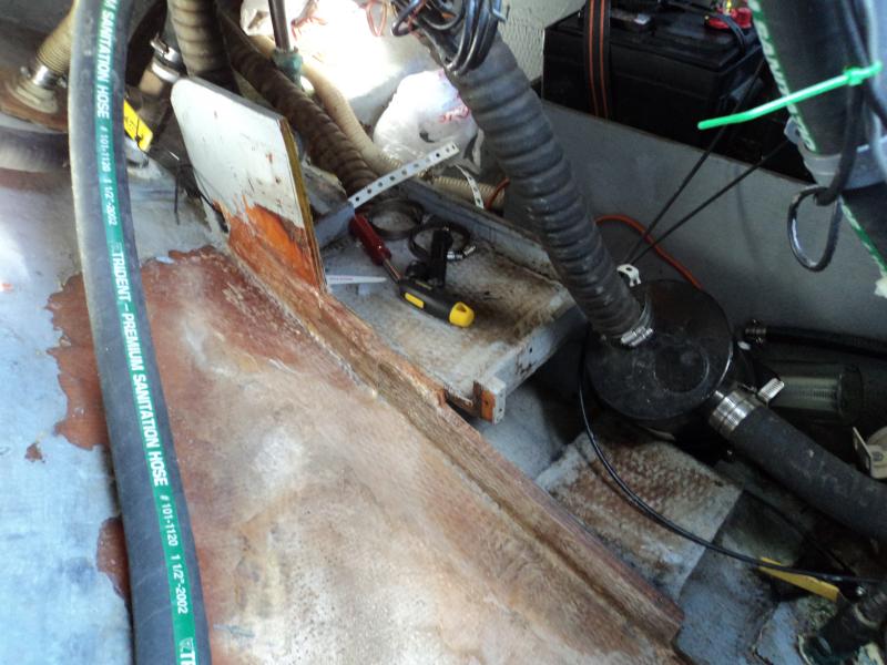

:dance: FUEL TANK REPLACEMENT UPDATE:
The project is in its final stages (I hope!). After removing and rebuilding the plywood areas that had been saturated with diesel fuel I painted the hull that would be under the tank. Why? Because I could. Fabricating a grid for the tank to rest on so air flow could get under the tank was nearly a full day project. The frame is generally a capital "F" shape with some cross bracing. I should have taken a picture, but did not. The tough part of the frame was supporting it so it would conform to the shape of the hull. Once that was complete I used Quick Cure 5200 to hold it to the hull. I set the tank in place on the frame and let the 5200 set. On top of the grid I placed a gasket that is for window seals. Two rolls were just enough to put a double-wide covering on the grid. That squelched the squeeking that had been ocurring when the tank just rested on the plastic. It should also keep the tank high and dry. I held the tank in place with 2 X 4 strips on top of the tank forward & inboard. There is a vertical 2 X 4 aft of the tank to keep it positioned.
I have not refilled the tank because I have a few loose ends to deal with: Fuel guage reads 1/4 although tank is empty, need to remove the guage to measure it's length, while the guage is out I will vacuum the inside of the tank as Maine Sail has recommended. Some fuel lines still need to be connected. (Yes, they are new hoses. I will not skimp on this repair at this stage of the project.) The water seperator has been wiped clean, seal and filter replaced. I have proudly put May 2014 on everything that I worked on in that area. (exhaust hose, pumpout hose, tank, fuel fill hose) I placed some foam blocks along the outboard side and forward edge of the tank to help keep "things" from sliding under the tank. That had already happened, but I was able to retrieve the nut driver.

I could be wrong but looking at the corrosion on the outside of your tank and the pitting from the outside it seems to suggest that the tank was getting wet from the outside resulting in the corrosion? Check the whole area above and around the tank to see if anything is leaking. I replaced my tank last year and I had some wet plywood in contact and found the source as a leaking bolt on my steering pedestal that was right above the plywood. The pedestal now has a nice butyl tape bedding.

Does that sticker include date installed and who made it- for future reference?
Aug 2, 2005
1,155
Hi Ron,
Yes, all info on the sticker including ABYS certification, thickness, capacity, date of manufacture, name of manufacturer, and even my name. (How great is it to have my own personal fuel tank!?!?)
