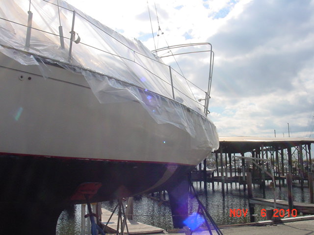

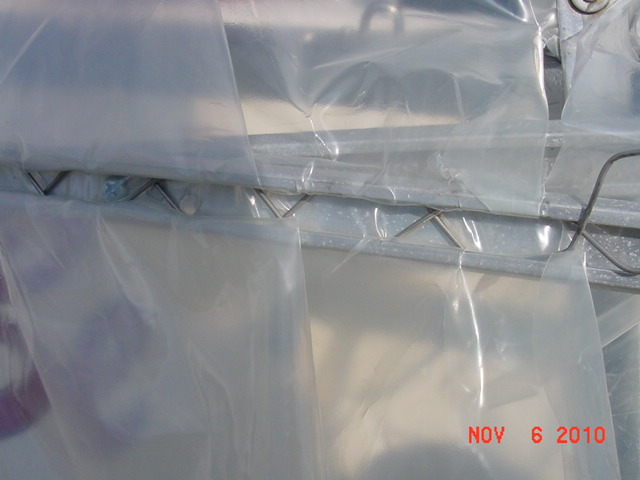

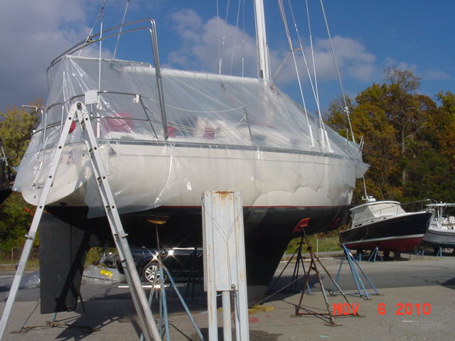

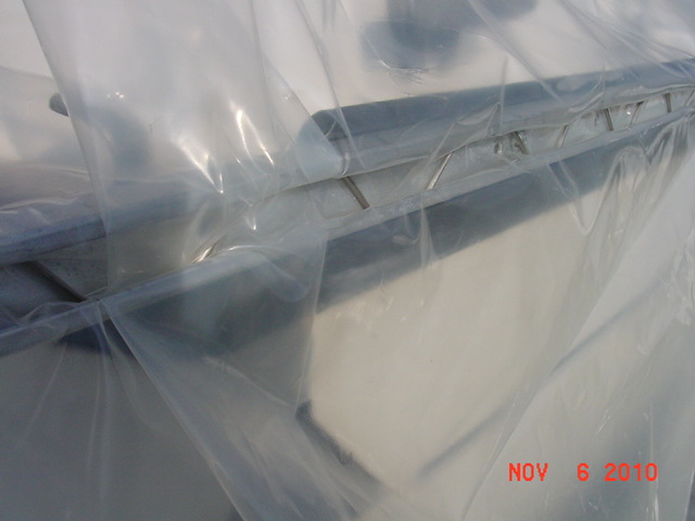

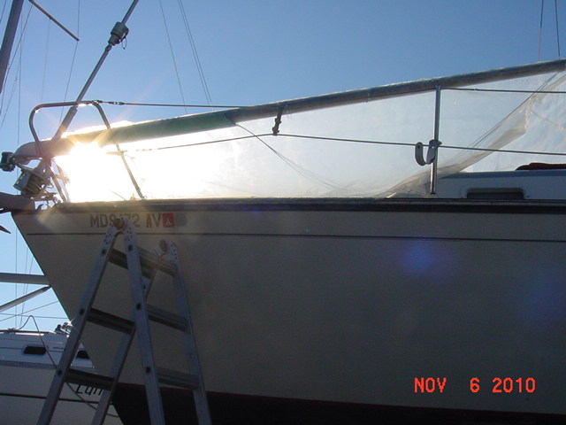

once again, the winter cover made from greenhouse 6mil film is getting placed on the Meant to Be using aluminimum channel lock and wiggle wire.
This system was first used in 2006 and continues to hold-up.
