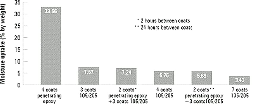

Yes, that west systems article was one of the conflicting pieces of info
that I found. Seems that if you want to heavily thin epoxy, you
need to be an expert at epoxy formulating.
I wonder if anyone has ever tried a vacuum chamber to suck in the epoxy? lol
The S1 seems to be pre-thinned to 50% if I am reading correctly.
I think I will probably try the 10% alcohol since I have alcohol on the boat already.
