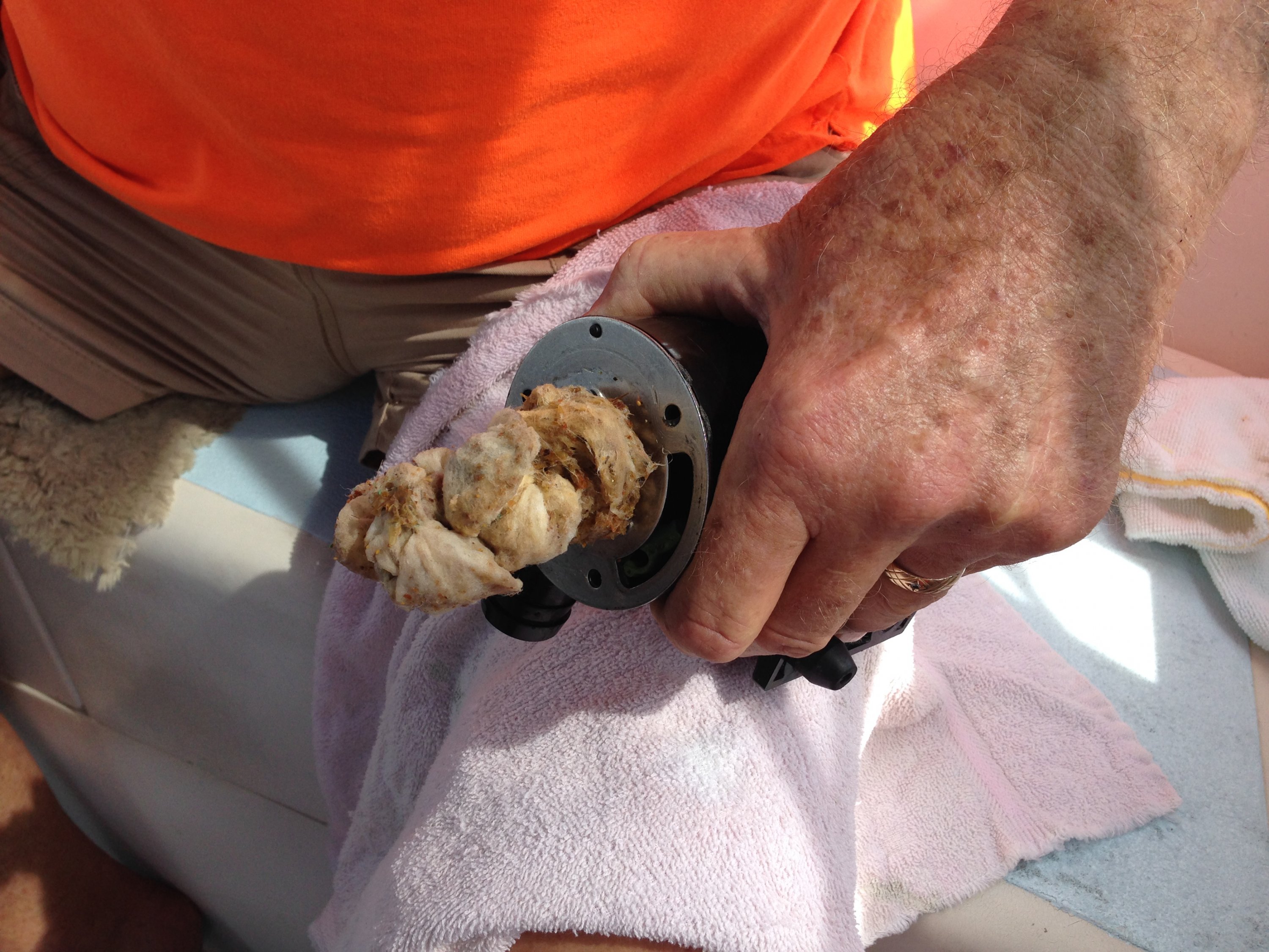

.....and claims of "biodegradable" are irrelevant and silly, since that takes at least weeks and it will only be in the pipe minutes to hours.
In theory. In reality each one collects a bunch more of 'em and creates "fatbergs." They don't shred either...they stay intact. I've never tested a wet wipe's dissolve time, but I strongly suspect your guess of weeks is highly optimistic. I'm guessing a year or longer. If I can get my hands on some (unused!!!) without having to buy 'em, I'll put a couple of 'em in a mason jar of water and check it once a week.
The attached photo shows what one can do to a macerator pump...and they'll do the same thing in any toilet pump, manual or electric.
