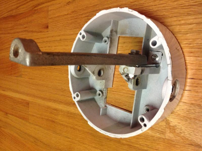

Hi,
Took pedestal apart yesterday, :( section that holds throttle and shift levers cracked at shift lever bolt, need new part Y321-0110.
Can someone confirm that Hunter 28.5 1987 vintage has edson pedestal?
No specifics in my owners manual and other paperwork.
Spent many days redoing bottom this spring, don't want to be stuck in slip now that she is finally afloat!
Appreciate all input, thanks!
Lisa

Thanks Allan, this is exactly what I have, 7 inch dia. 2 inch ht.
Do you have more info on the pedestal? Would you be willing to email it to me?
I may try to have a friend fabricate a new one.

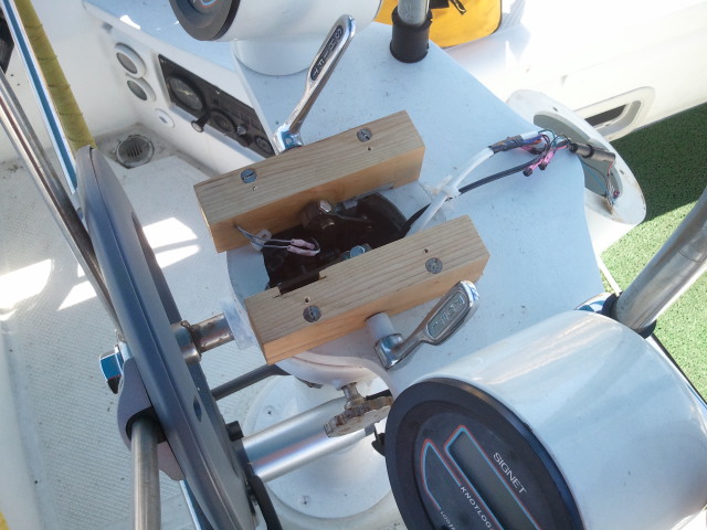

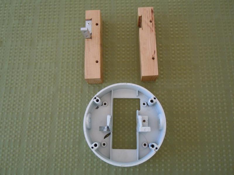

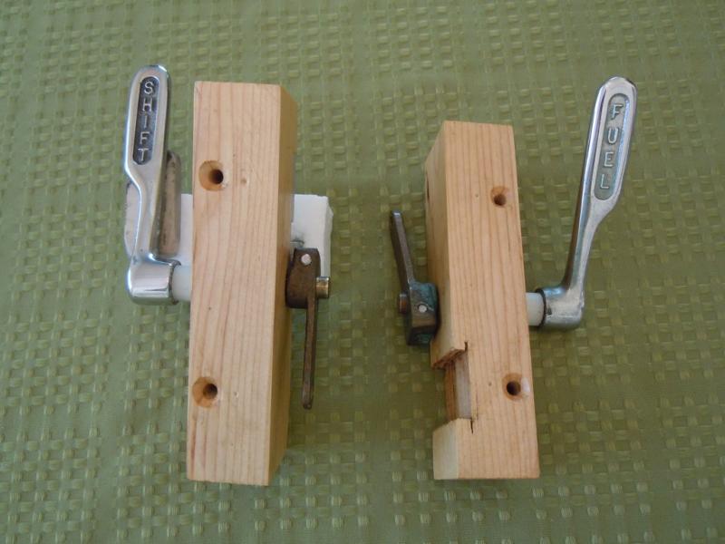

Claude, great info, will call and see if they can make one for my pedestal.
In mean time, a friend helped me repair mine, including a backer plate.
See attached photo!

Your friend came up with an elegant solution to reattach that piece to the control head. Mine was so completely shattered that I can't do that. Also, I can't get that piece off the cable even after removing the little screw.
Allan

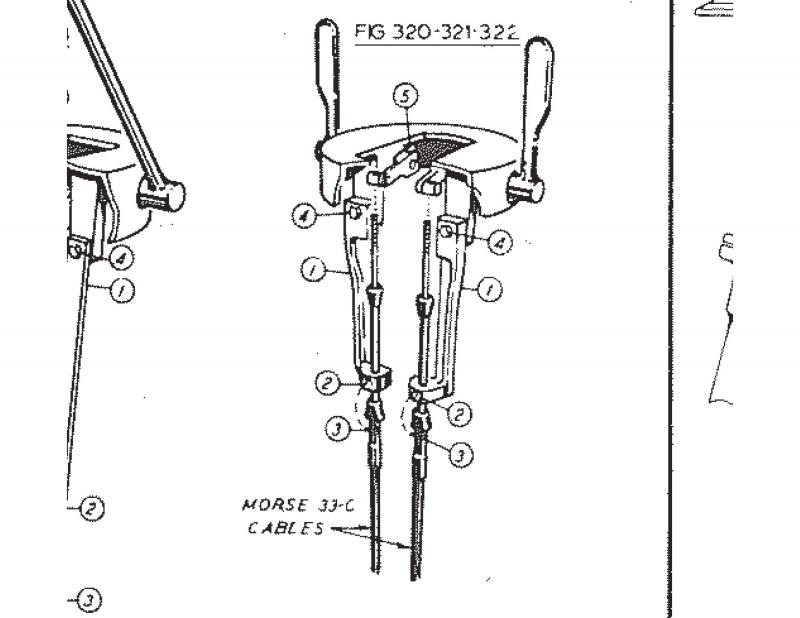

When the throttle cable broke on my Merriman, I checked the manual and found the diagram in Allan's post. I noted that the original design called for both cables to have supports [item 1 in the thumbnail], but later Hunter assemblies eliminated the support for the throttle cable [which is exactly where my cable failed]. I wanted mine as originally designed so I emailed just about every salvage yard I could find on the internet and finally got a response. I was able to buy the supports for both the cables. I can't remember now who had the pedestal parts, but I suspect if you do the same thing, it's more than likely you will get a hit and save yourself well over $100.
