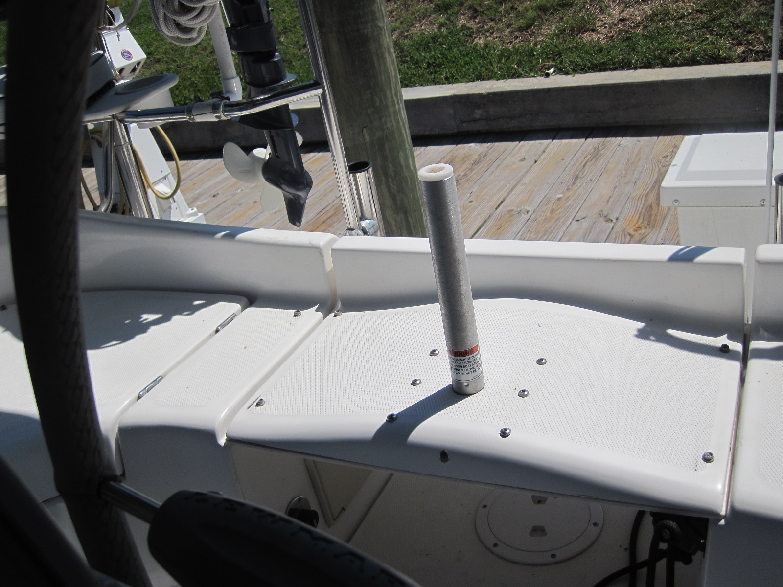

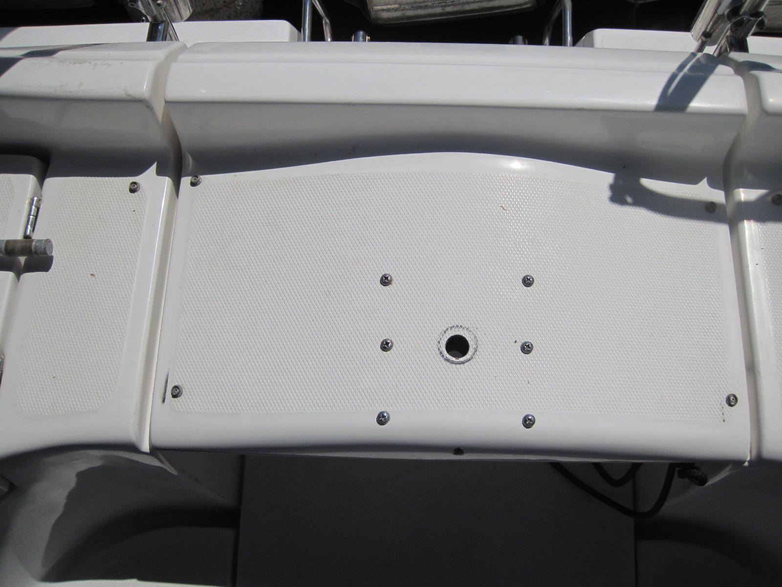

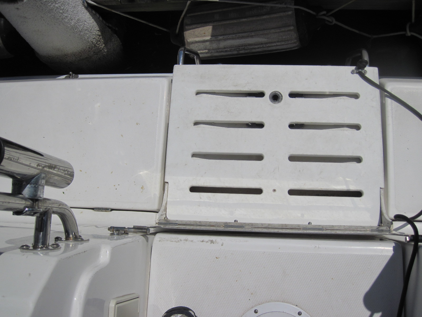

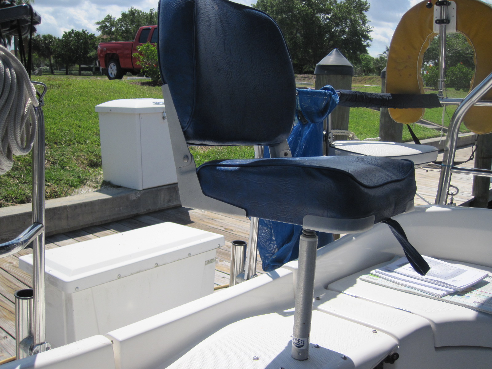

I added a seat at the helm and here some photo's.
The trick is to take the folding step apart and go to walmart and get aluminum plate
that is used for the pole in the photo and will need to grind away some of the inside of the folding step seat so that the plate sits flat against the upper part of the seat.
The seat pole and plate came from walmart or boat store and can't find the photo of the plate that goes in between and like I said get the aluminum cast one not the stainless because the first one I used was stainless and started rusting after a few days.

Yes I think Benny's would be way easy to install compared to my install and it was a little work putting the plate in between the swing down step.
My setup is less for storing and my seat is perfect for me and small to store in my cockpit
locker and the pole is easy to store for sure and I looked into better setup like Benny's but
my setup much cheaper and pretty much any type seat can be used but installing the plate is much more work and a little tricky but was well worth it.
I like the seat and pole for comfort and ease to fold and store.
