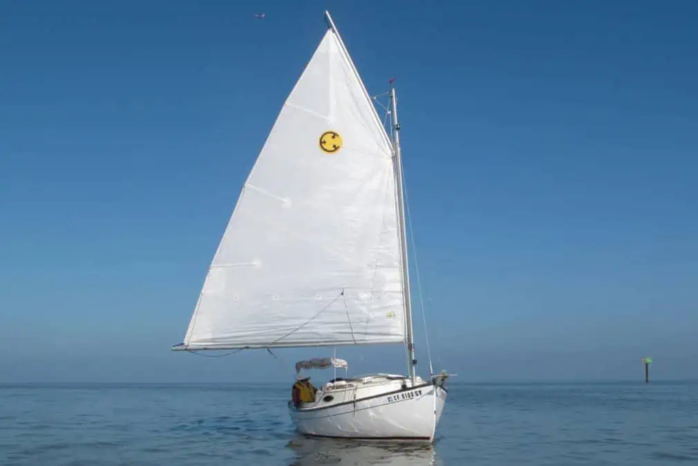

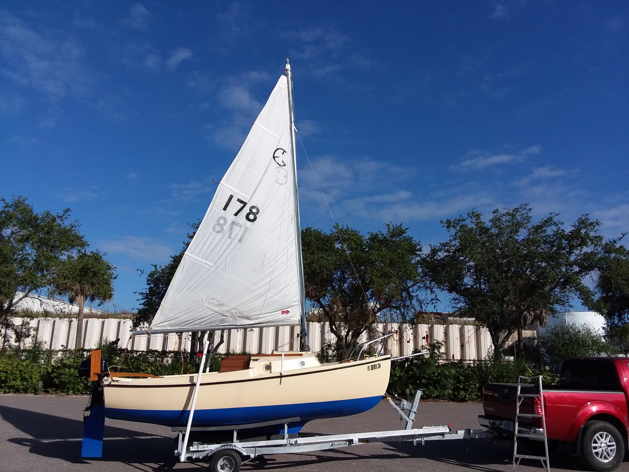

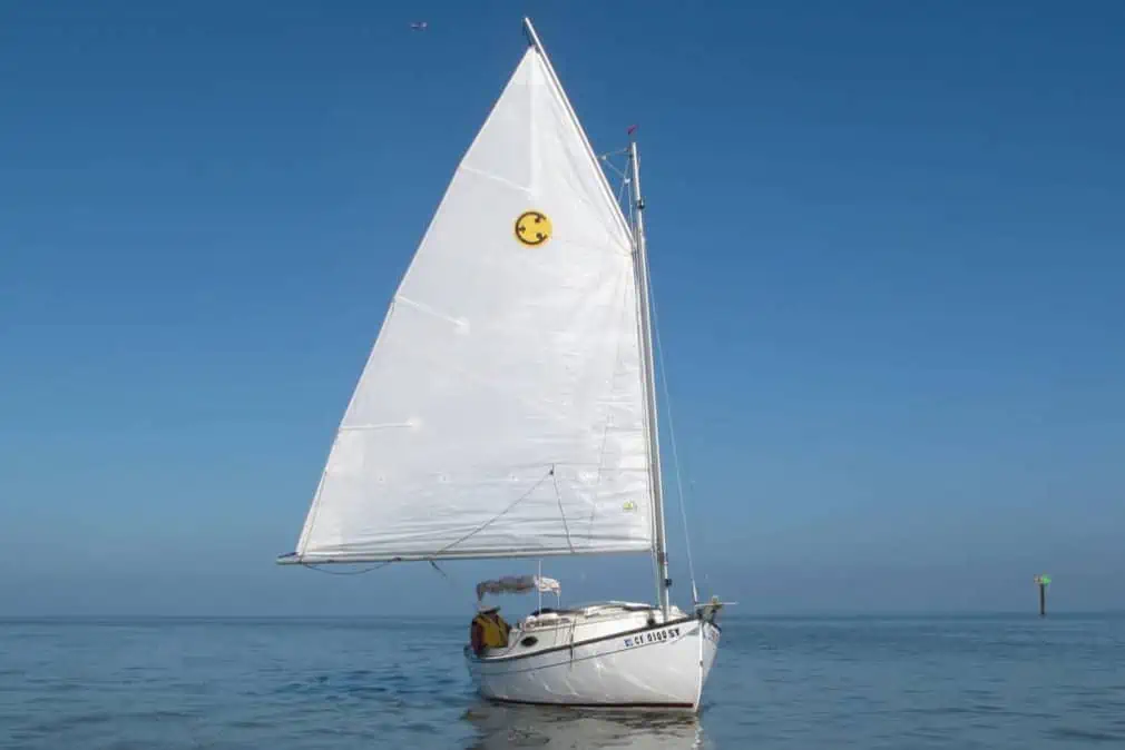

  • Compac 16
  • Compac sun cat...
    This one is a cat boat w/easy sail controls.

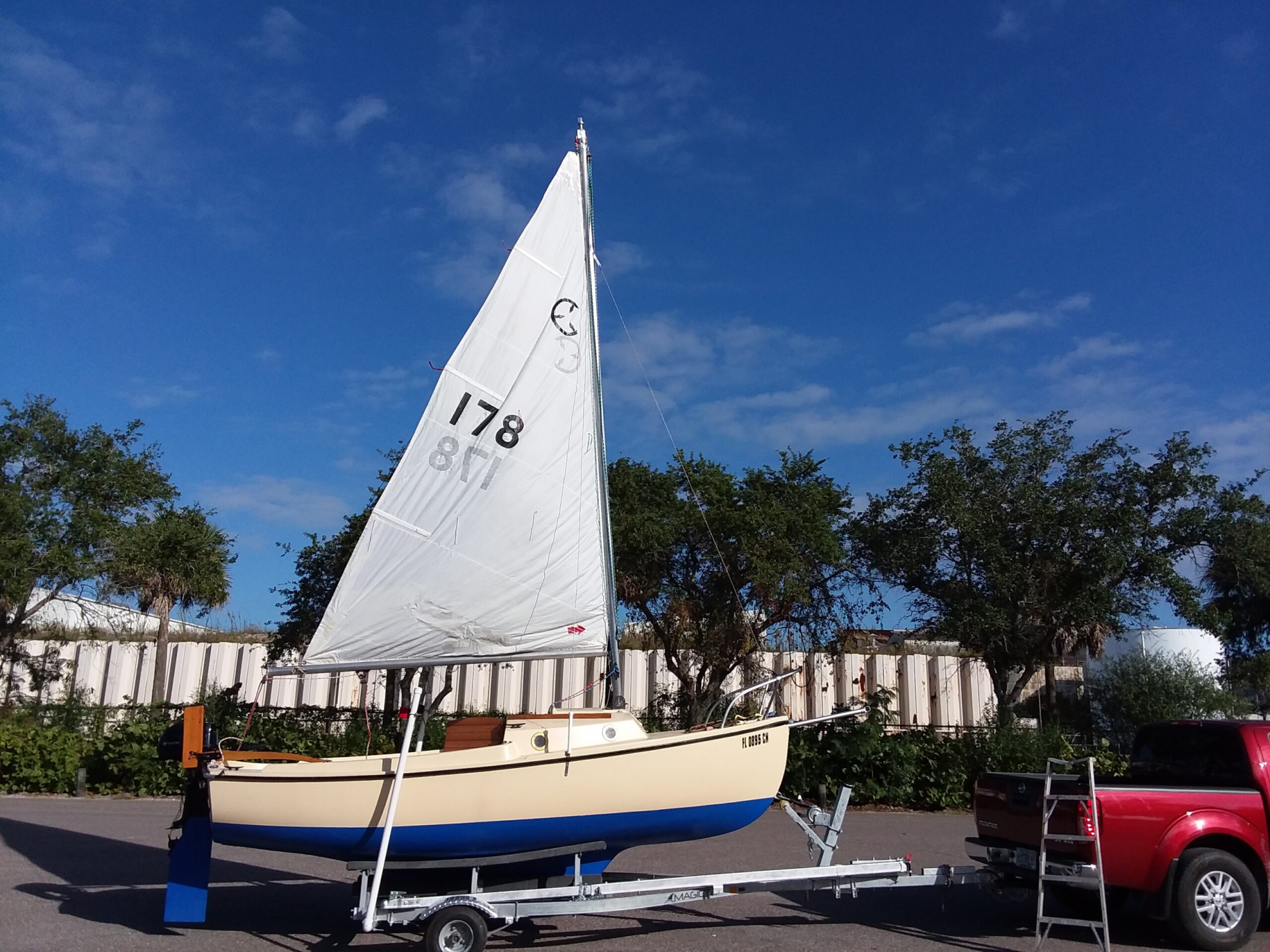

  • Montgomery 15
    ... also a cat boat with easy sail controls

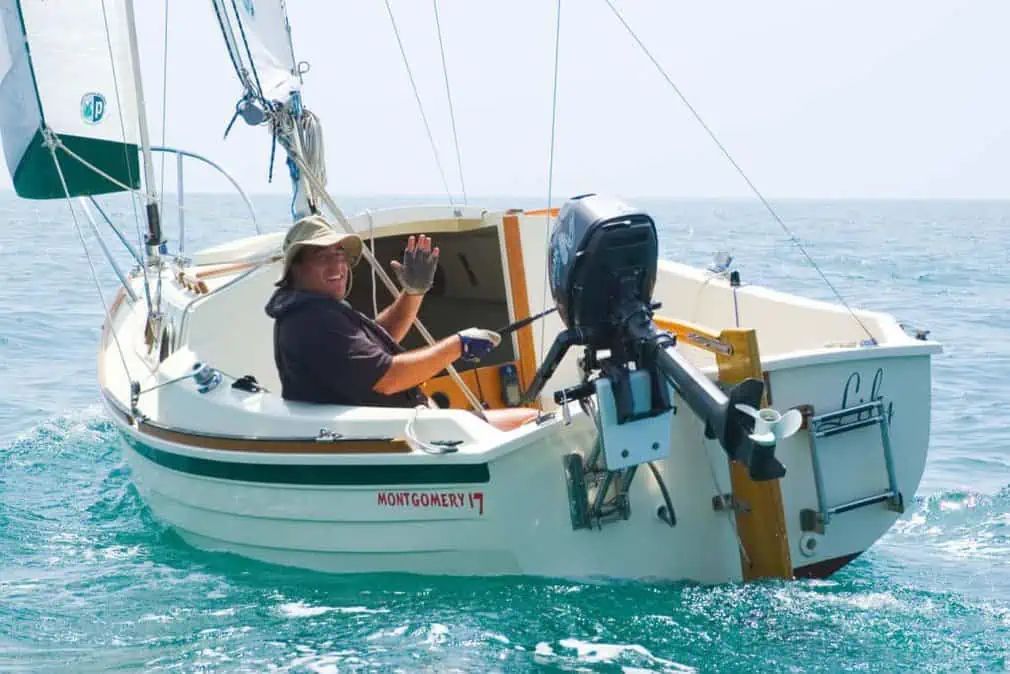

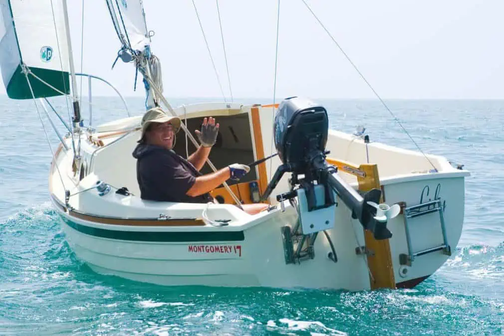

  • Montgomery 17...

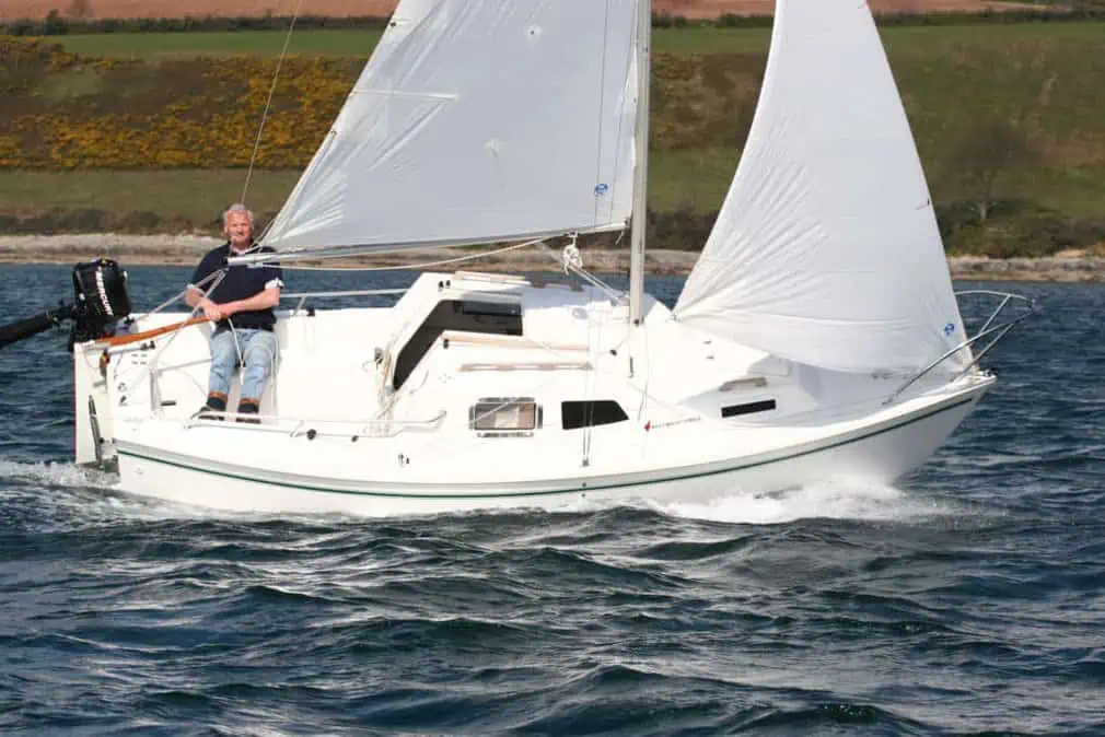

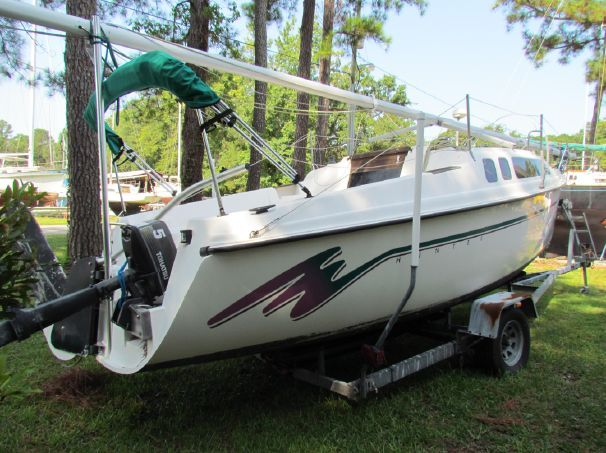

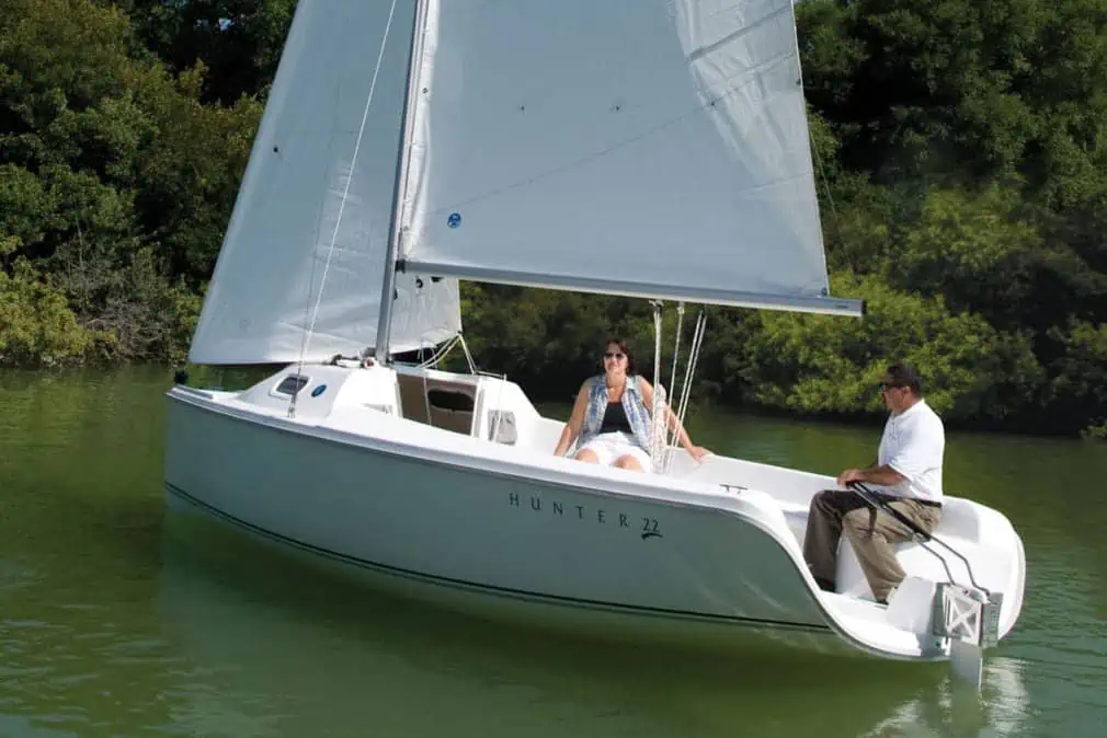

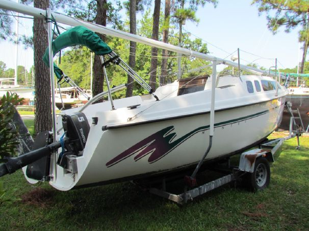

  • Hunter 23.5
    ... water ballast so very easy to tow. Cut out transom so easy to swim off of.

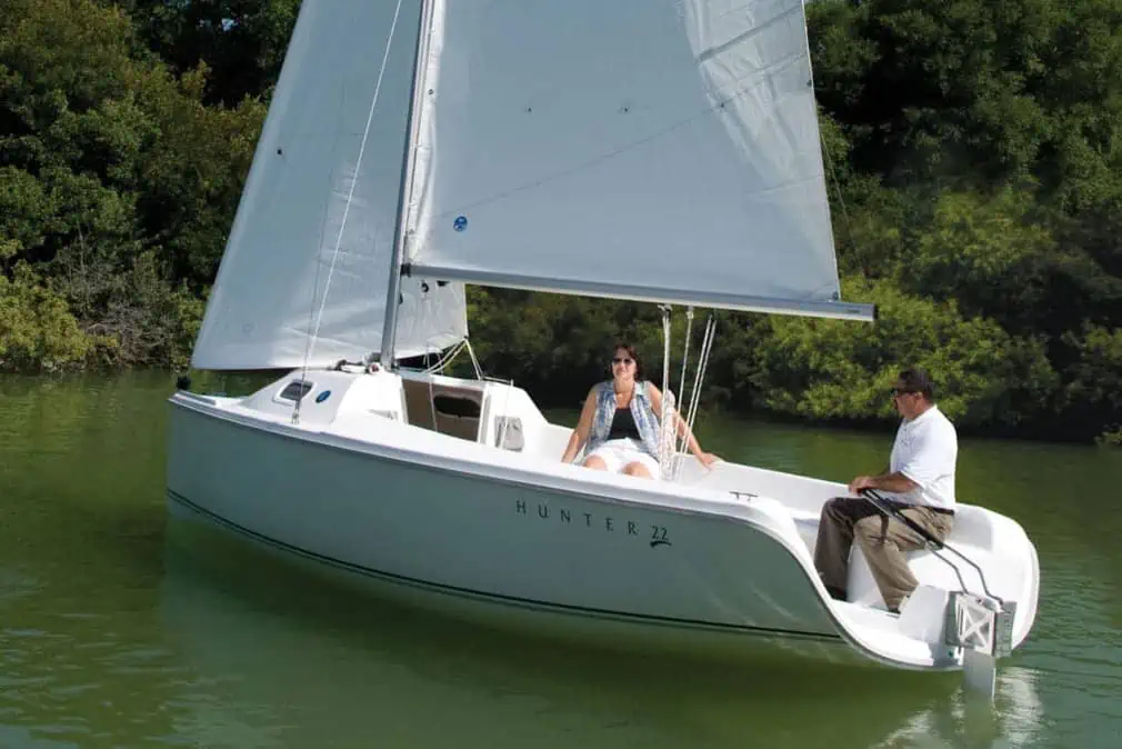

  • Hunter 22...
    ... also has a cut out transom so easy to swim off of.

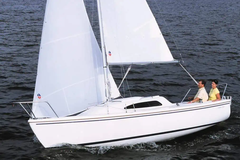

  • Catalina 22 sport...
    ... a traditional pocket cruiser... still in production.

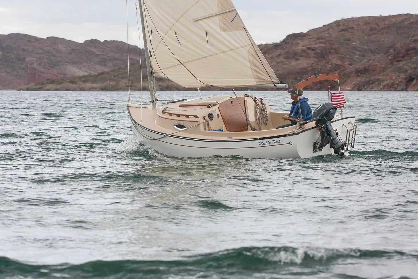

  • West Wright Potter 19...
    ... tried and tested pocket cruiser.

I trailered and sailed the Montgomery 15 for 18 years. Terrific boat, very easy to solo sail a bit small for your use.
