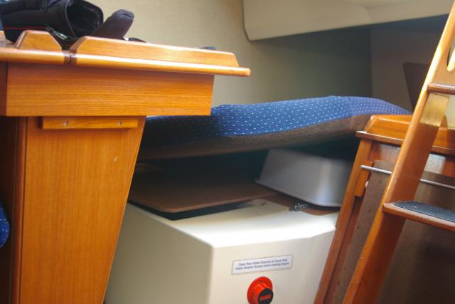

The nav table on my 1977 Pearson 323 does not open very far. When opened it interferes with some of the molded fiberglass above. I have been thinking of cutting it through the middle and hinging the two sides so that it can fold back and then open all of the way.
Has anyone else ever considered doing that?

Attached is a photo to give you an idea of what I did last year. This is the best I've got because I did not take an "after" shot. Anyway:
Cut top where shown, re-edgebanded, mitred the fiddles back so it could open just past 90d. Hinged with flush two pin table hinges for flat surface. I used the less expensive hinges from ABI (purchased at Hamilton). Next time I would use a better grade of hinge because the Chinese made ABI's are inconsistent in size so the router template I made didn't fit each hinge as cleanly as I would have liked. They still look good, just took extra hand fitting.
The back portion of the top is 4-5" wide and fixed down with a block supporting the seam where it butts the fixed existing portion, otherwise methinks it would flex downward when weight applied to surface. I also routed a hole for, and fixed in, along narrow plastic tray in the newly fixed 4-5" wide portion. It holds parallel rules, dividers, pencils allowing large chart to extend over the top.
I stayed the top with a Sugatsune SS lid stay (McMaster Carr - #11615A11-Type 304 Stainless Steel Lid Support).
Works well.

Thank you for the photo and reply. It looks really nice.
What do you use for a finish?

Rubbing varnish
I finished with a gel type satin rubbing interior varnish because this was a last winter project. I am 350 miles from the boat & I only had the removable top to rework & no way was I going to open the can of worms refinishing the whole desk. The satin rubbing varnish finished the new parts pretty close in color & sheen to the 23 year old stuff around it. I love working on the boat making & fixing things. I'm not a big fan of sanding & varnishing & sanding & varnishing & sanding & .........
