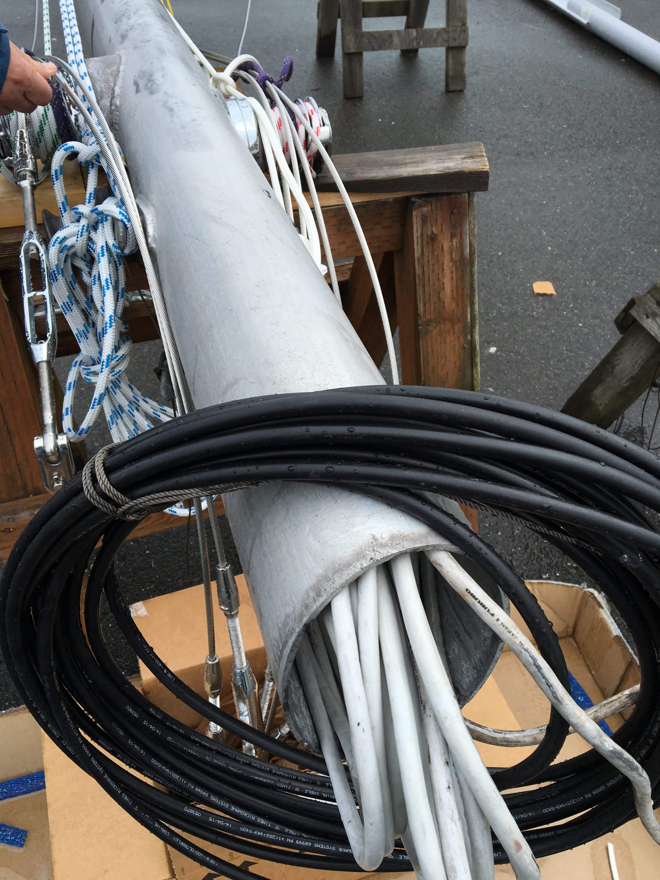

While not all of us have a Pearson, perhaps you might get an idea from the forum contributors if you gave us a picture.
Here is what mine looked like having been run thru the mast then the extra length folded over while we fitted the rest of the mast hardware. The black cable is the VHF/AIS lead that will be one piece into the boat cabin and to the radio to reduce signal loss.
