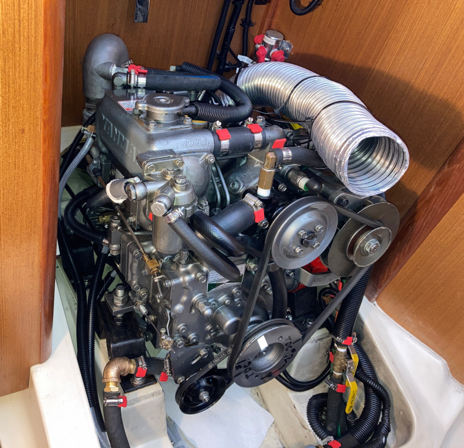

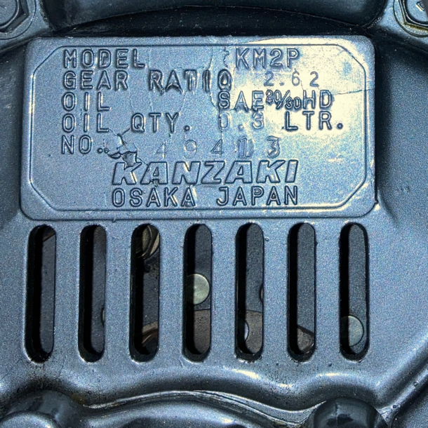

Looking for some advice on an issue w/ my '85 Pearson 303. This has been gradual but seems to have picked up over the last 3 months. Running a Yanmar 2GM20F (16hp, 3400)
/ Kanzaki KM2P 2.62:1 with 14x10 3 blade (RH). She never cruised too well over 2500 but now won't push over 2000 and the engine just sounds flat w/ a lot of grey exhaust and discharge if I push it full throttle. Raw water discharge is consistent (trap clean, flow looks good) and in neutral I can reach full RPM...so I have to imagine something is constricting the engine when engaged...but can't seem to figure it out. Mechanic said it is an over sized prop issue, but from what I'm reading 14x10 seems OK for this configuration. Good times. Many thanks for any thoughts here...

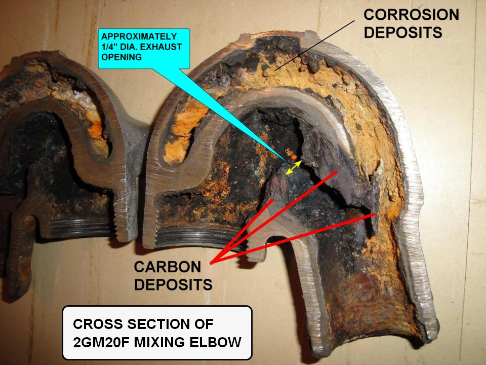

Your Yanmar may have a congested throat :
A short history of your engine would go a looooooooong way in determining what the problem(s) are here.
Also, I mentioned a plugged mixing elbow as a first inspection because it's the cheapest in a long list of expensive solutions running from this one (~$15.00) up to buying a new fuel pump and servising the injectors all at the same time (upwards of $2,500.00).
I trust you will be checking the mixing elbow yourself for the cost of a new $15.00 gasket. It's an easy enough job but realize you may not be able to clean the old elbow which means buying a new one.
Check the archives for Plugged Yanmar Elbows. A real ballpark estimate on having the elbow checked by a mechanic and "replaced" just to "keep it clean" I would expect to be pushing $800.00. Look at a SS mixing elbow which few mechanics will tell you about. About 50% the cost of a Yanmar mixing elbow.

Ralph has clearly identified a blocked or corroded exhaust elbow. So my advice is to follow his advice.
I reckon that he is on the money with that one.
This a job that you can do yourself. That will save time and money and get you more familiar with your engine.

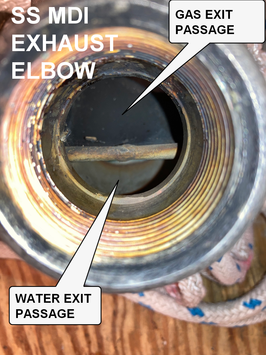

Seriously, the injector elbow is a good candidate for inspection and cleaning if necessary. If it does need replacing because the metal is getting thin or the carbon build up is too thick to clean get a SS elbow and be done with it. HDI Marine is the place to go for a new elbow.

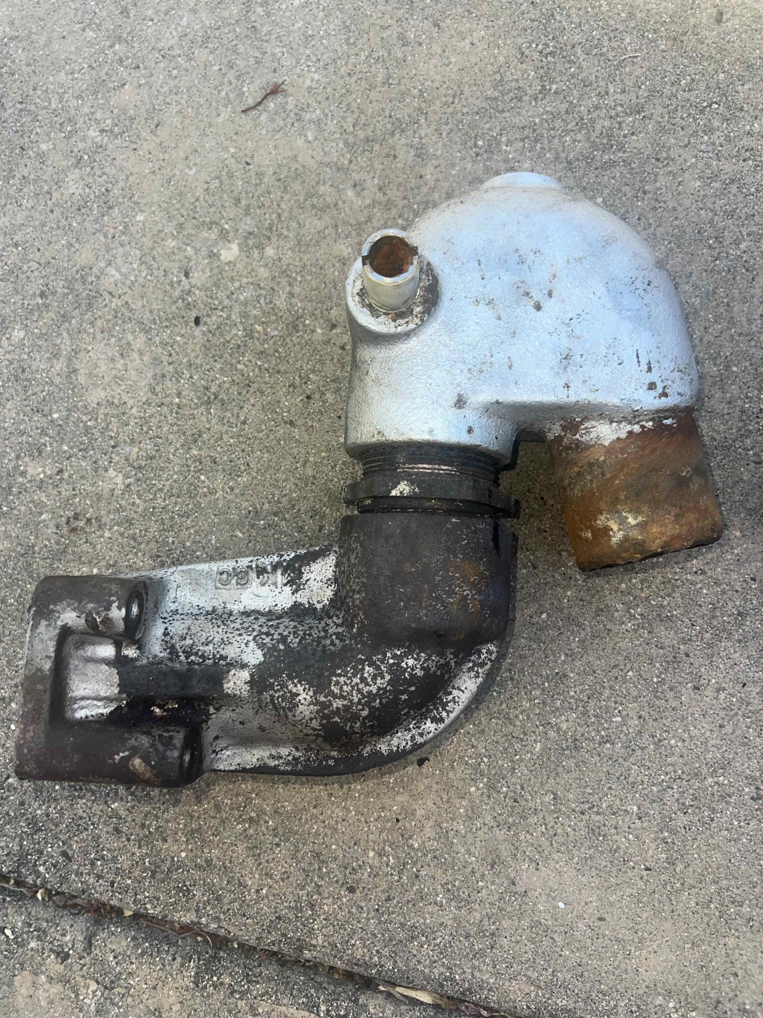

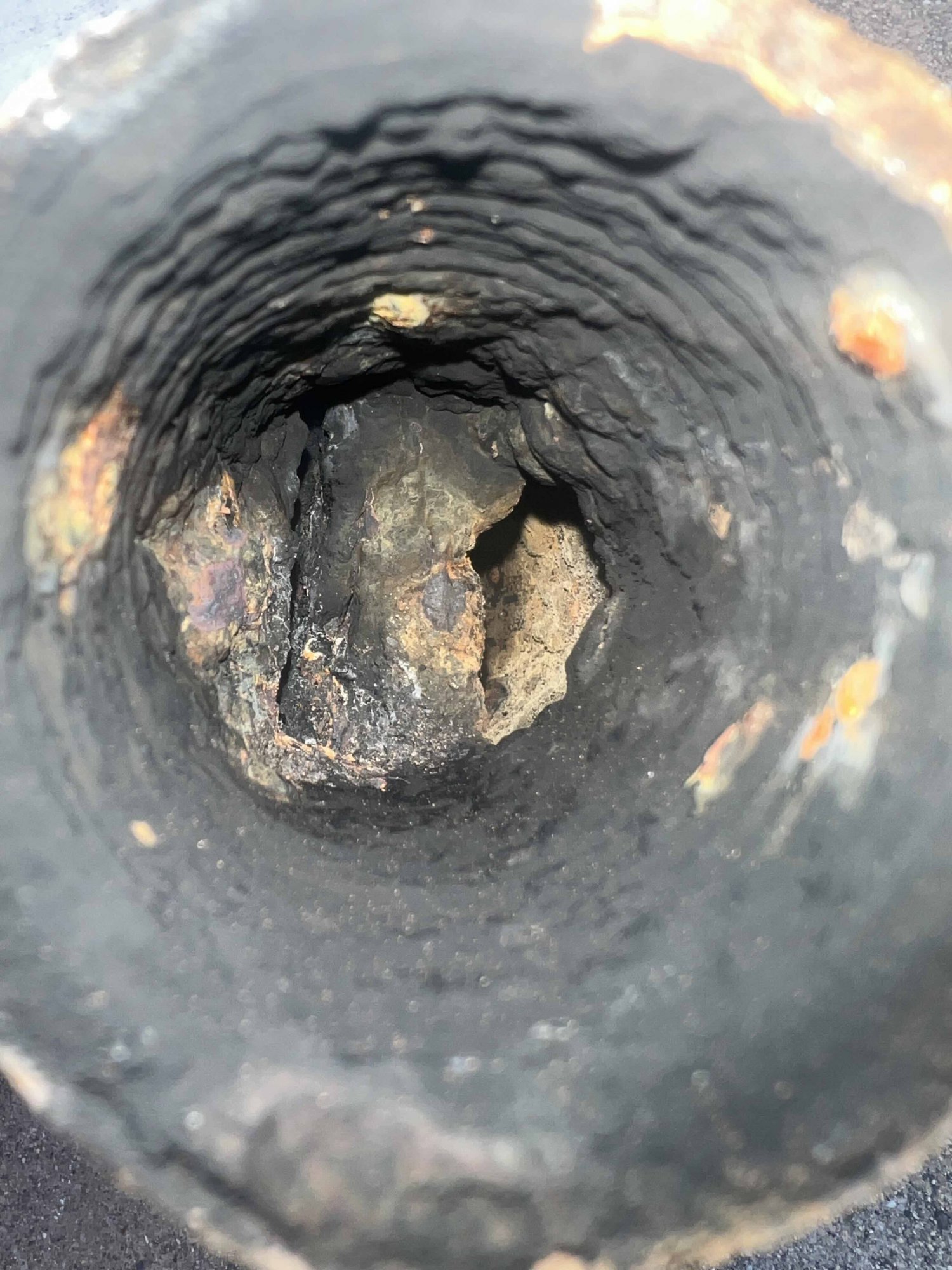

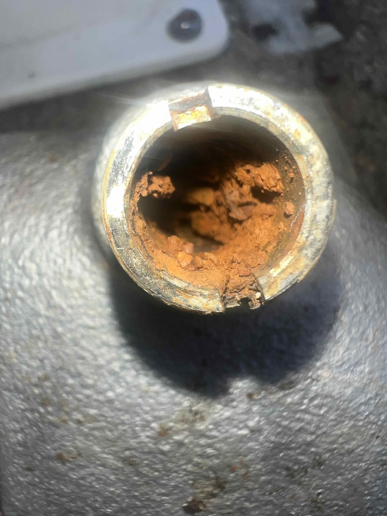

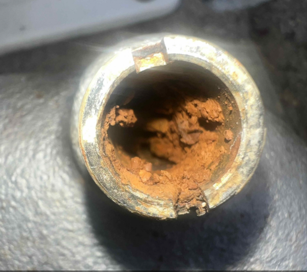

Hi all - Life got in the way here, but I finally got around to inspecting the mixing elbow and indeed it was a mess (looked a lot like the images Ralph shared and I've pasted a few below). Had a heck of a time doing the work in the confined access space, but got the new one installed, replaced some hoses, etc and was a good experience getting in there.
Ran the engine for 30 mins after install and she ran great. RPMs almost fully back, a big increase in raw water flow/clean flow, much less (almost no) grey smoke/exhaust.
Heading out for a full sea trial tomorrow...but so far so great. I'll surely be checking/replacing my fuel filters and a few other things here soon as well.
A huge thank you to all of you for the input and knowledge here (as well as a confidence boost that I could do this).
Really appreciate it.

May 29, 2018
693
Canel 25 foot Shiogama, japan
Congrats on the (self) repair.
You have saved money and learnt along the way.
I hope you went for the stainless replacement.
RE: Had a heck of a time doing the work in the confined access space,
That is why it is called boat yoga!!
gary
Jan 4, 2006
7,870
Crikey. I though I held the record for plugged up mixing elbows. I see my record has been usurped :
Well, I had my 15 minutes of fame.
If you did get the SS model by HDI marine, that's the last of soot and corrosion deposits.
