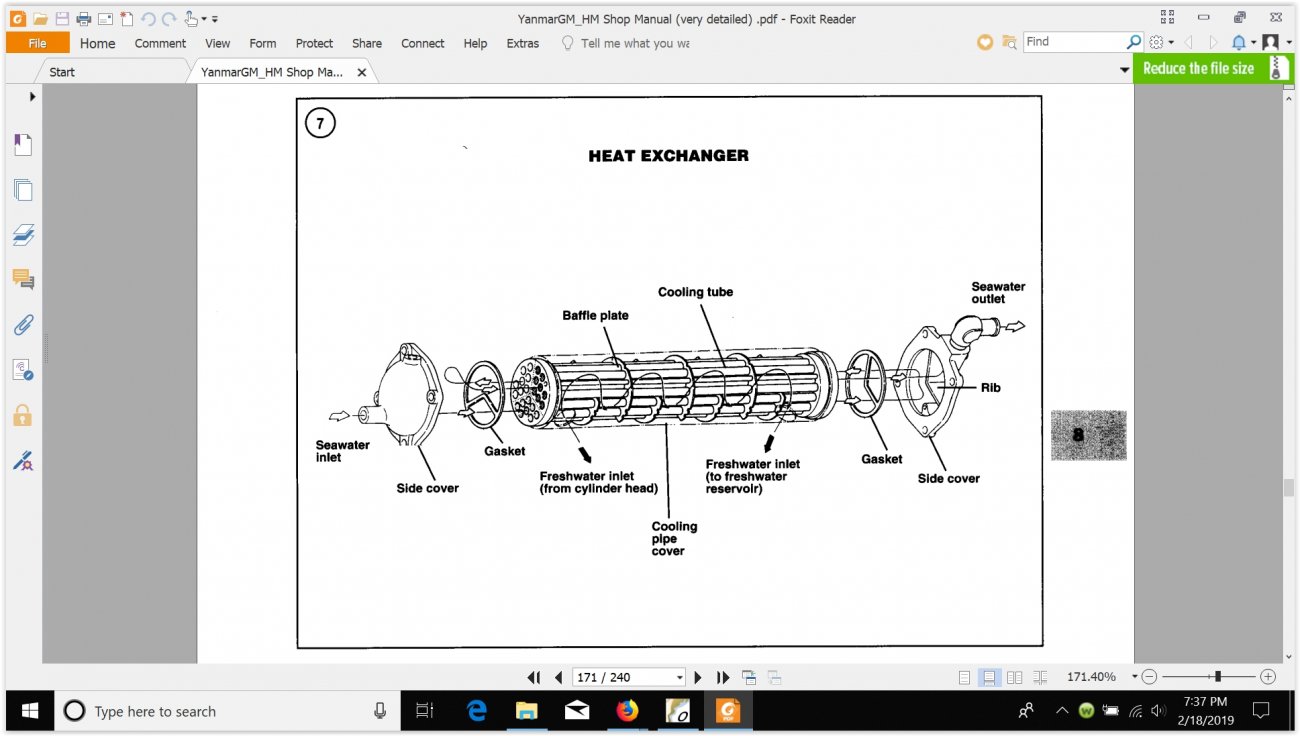

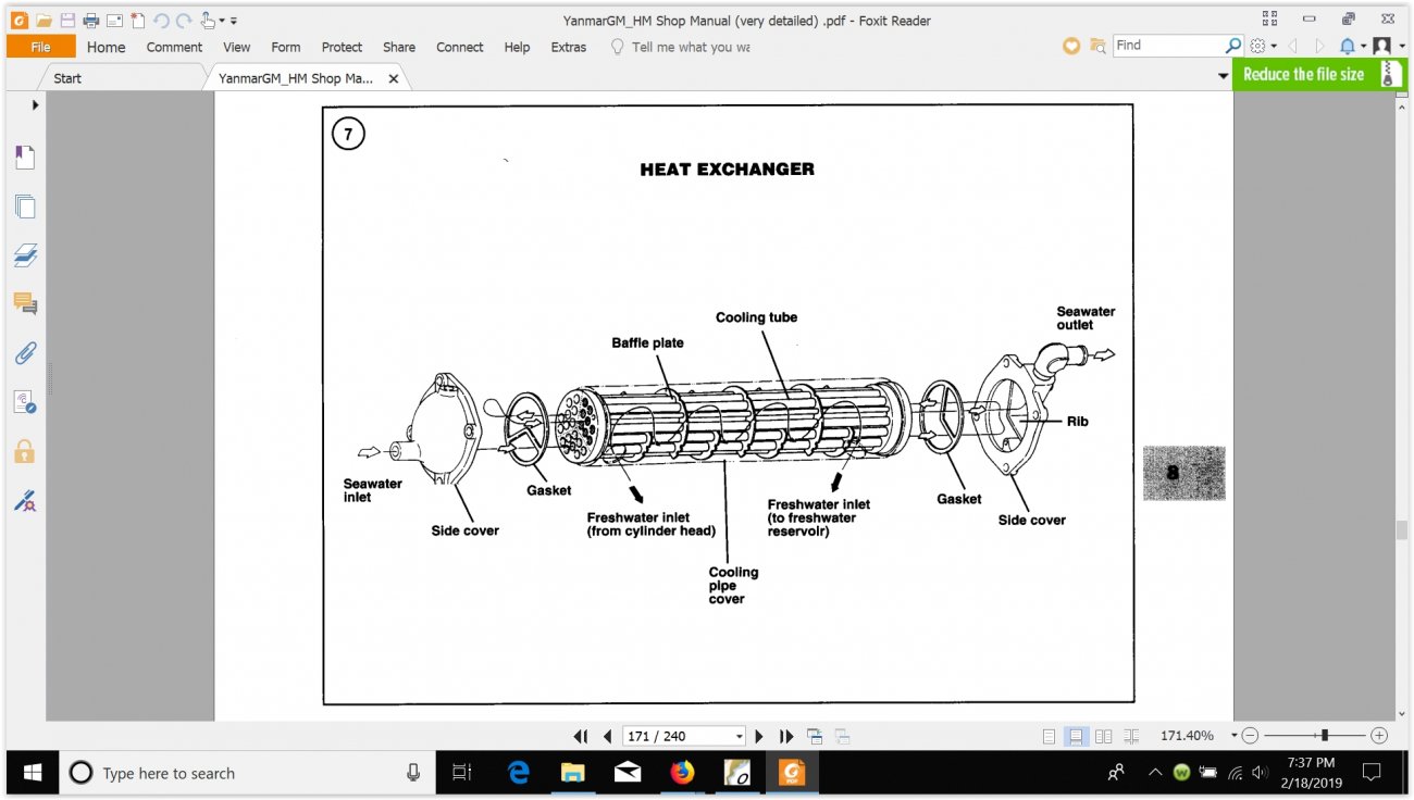

Hello Yanmar fresh water cooled fans! I flushed out my engine system and was going to removed the core to have it cleaned. However, I noticed it would be easy-er after inspection to use a GUN Cleaning kit to ream out the pipe's rather the taking out the core. This saved allot of time and expense. So, from the front of the engine i remover the cover changed out gasket and used the 22 pistol gun soft quilt dipped into vinegar and it did a great job. Put the cover back on and started engine running fresh water to remove residue from the cleaning. Total time apox:30 min. I hope this helps someone with a fresh-water-cooled system.
