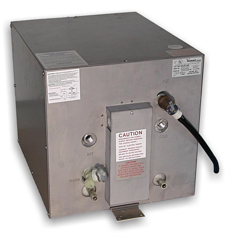

Hi all! This season I've decided to change out my hotwater system a Seaward F600 6gal Marine Electric Water Heater AC110v - 1500watt with Front Heat Exchanger. It has a good but too hot temperature coming out the faucet's you have to watch out because the engine heat exchanger heats the water to around 200++ degrees OUCH! I said. Also, I would like to get more water volume then just 6 Gallons of hot water. I do like long showers "LOL". So after doing some looking and reading I think Ive figured out what to do and I am open to any ideas,views or opinions here.
New configuration as follows:
New Seaward F600 Marine Electric Water Heater 6 Gallon with Front Heat Exchanger, a new AC heating element that's only "750Watt element" and not 1500watt. This allows me to use my 1000watt Kipor generator to heat up water at sea and at moorings. New: install Mixing Valve at heater that will allow the hot water to mix with cold and deliver a good comfortable temperature threw out the boats faucets. This will mean that the HOT 6 gallon tank will act like 10 Gallons of how water.
Currently: To run water I have to run Hot water then add the cold water to mix at the faucets to get it to right temperature then take shower or wash dishes..etc. We would go threw water quickly because of wasting hot to mix before using it. I guessing about half-gallon per event.
I'm thinking also 200++ degrees of water pumped to the galley and Head faucets must play a bad role with plumbing too. Any comments or ideas to add please do!

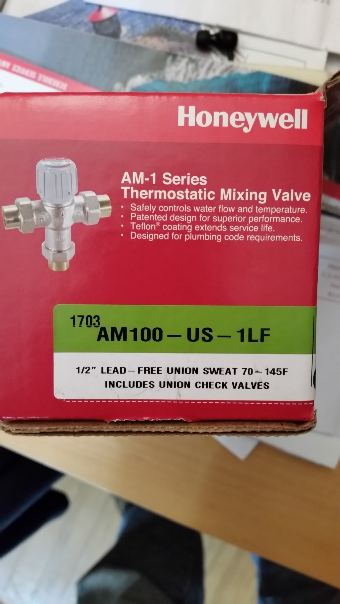

The mixing valve I use is a Honeywell AM100C-UT-1LF, purchased from supplyhouse.com for $99.95 last year. I have never attempted to clean it separately. I do shock treat the water system with bleach in the spring with the valve in place. I also installed a large stainless steel dial readout thermometer in a T fitting in the hot water outlet of the water heater. The thermometer I got from a brewers supply with a very long probe that reaches into the tank. That provides a constant look at the internal water temperature in the heater (not the mixing valve output).

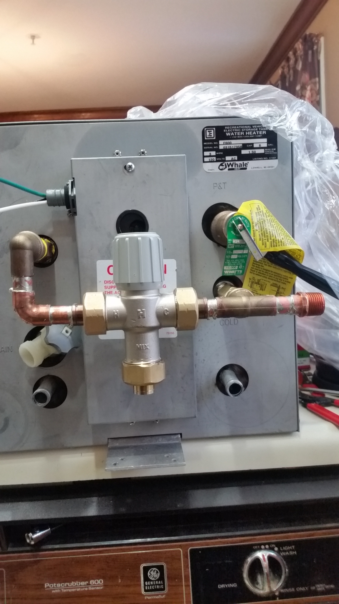

Yaaa! Completed Hot water tank with new mixing valve. Picture shows installation and piping. Time in project 4 hrs. Thank you all for your incite on what parts to use.. Cheers!

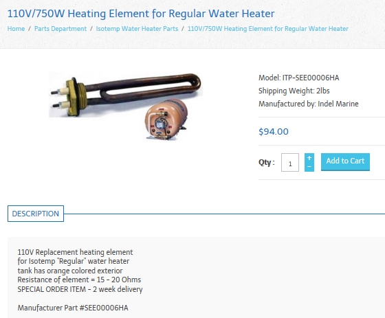

Your engine thermostat is probably 180, max. Have you found a 750 heating element?
Still looking for a standard threaded 110vac-750watt after talking to David @ Indel he basically stated that the thread is European fit and NOT standard and also 2 week order time for parts. Boy! I'm glad I don't install there "proprietary heating system". Any idea's please jump right in! Thanks
