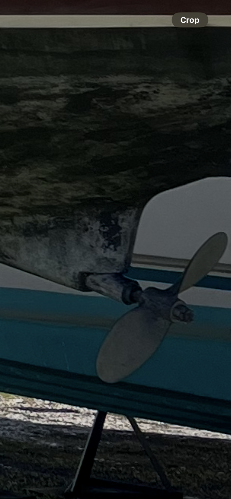

A picture of your setup will help us provide more detailed support.

No problem, it looks like mine, as I suspected.
You should see holes on either side of the shaft log. Mine were covered with a dap of caulk that covered the hex head screws. I picked out the caulk and unscrewed the two screws. I then went at the cutlass bearing, first with needle nose players to pull it out. That did not work. I then took a hack saw blade. The bearing is about 5 inches long. With the shaft out of the boat, I put the saw in one of the bearing grooves and began to saw through the bronze outer rim of the bearing.
Once the saw was through the metal, I grabbed the end and twisted it a little to fold the bearing in on itself. If yours is stubborn, you can cut a second slice near the first to allow the bearing to collapse. It will then be easy to remove.
