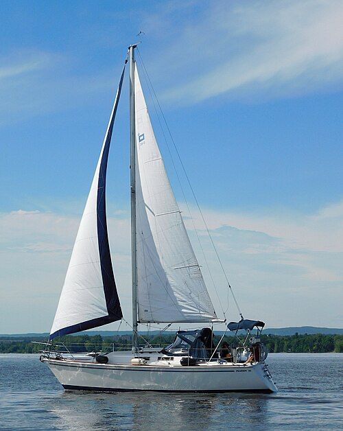

I bought a used 28-2, Looking for a picture of the correct topping lift configuration/connection to the Boom and topping lift.

This image of the Pearson 28-2 shows that the Topping lift is a line (rope) that is attached to the end of the boom, runs up to the mast head, likely down inside the mast to an exit block, and then is tied off on a mast cleat. This is a common method for masthead sloop-rigged boats. It is the way my boat is rigged and functions very smoothly. When I raise the main (at the mast), I ease the topping lift. I snug up the topping lift (keeping the boom level), when I ease the main. Since the boom floats between the topping lift and the mainsail, if I want to improve the trim of the main, I use a vang to hold the boom from floating when the wind is stronger than the weight of the boom. It is a simple balancing action that maintains a level state on the boom.
If this is not your boat design, let me know, and we can explore further.:biggrin:

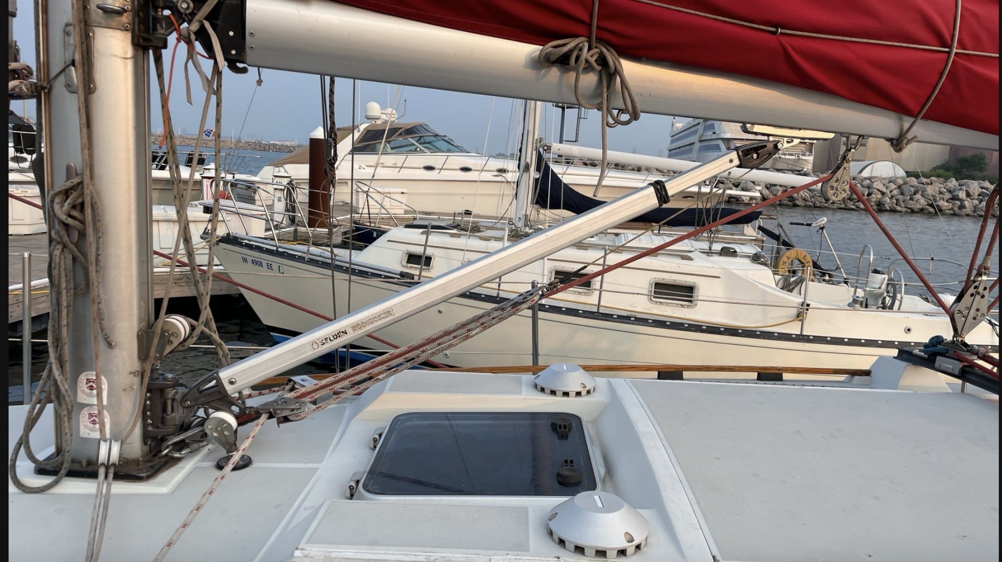

+1 for a rigid vang or a boom kicker. My Hunter 280 had a boom kicker (2 fiberglass rods that hold up the boom). My current boat (O’Day 322) had a topping lift. I found a used Seldon rod kicker (spring loaded boom support) and has been a game changer.
I no longer even use a topping lift.
