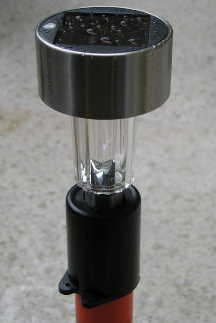

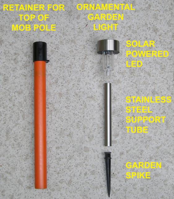

So what do you do about an anchor light when you are moored in a remote spot with minimal boat traffic? Run your house batteries all night to power the anchor light to avert a disaster with a 0.0000001% chance of ever happening? Spend good money to buy a LED anchor light for the mast head and risk your neck installing it?
How about a low cost solution that should keep almost everyone happy? The latest batch of solar powered LED garden lights are compact, low cost (under $5) and they even look good! Not only that, but the LED and the solar power portions (compete with auto shut-off for daylight hours) are totally integrated and can be readily mounted on your boat.
Legal beagles will point out that these units are not certified as anchor lights and must be mounted at the mast head. Ignoring the certification issue, my response is that traditional masthead anchor lights are less than satisfactory in the small anchorages frequented by coastal cruisers in my boating area. Human eyes naturally scan at eye level. If you are anywhere near a moored sail boat, your neck needs to be ratcheted back to an angle that creates business for chiropractors to see the average masthead anchor light. However any small twinkle of light at eye level quickly gains your attention.
After deciding that the solution to my crew’s stress problem was a solar powered LED, I eventually decided that the optimum mounting location was on top of the MOB pole. Easy to install, good visibility, looks as if it belongs there and is a low cost throw-away replacement every 2-3 seasons. The attached pictures show how it is done. Before anyone else mentions it, it did occur to me that it would be even better if the light could be mounted directly on the MOB pole so that it would also go overboard with significant benefit for a night time emergency. The mounting design for that is still under development!
