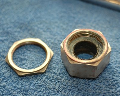

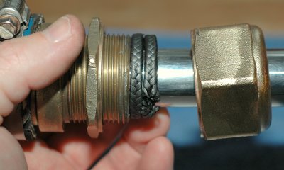

Maybe I'm not getting it ... but isn't PB Blaster supposed to penetrate into tight places, like all the way through threads? The packing flax is on the other side of the packing nut threads. I've copied a couple of pictures from Main Sail's article. Water gets through gaps around the packing flax. Seems reasonable that PB Blaster also can. The hole in the nut end is slightly larger than the shaft. Penetrating oil applied too liberally and spills on the shaft would reach the flax from that direction. I'm asking this because my first inclination is to PB the nut a few days before I attempt to loosen it with the wrenches. But won't do if I risk damaging the flax packing. I know that the boat yard did not lanocote the threads when new flax was installed five years ago. With the boat now in the water, I'm not inclined to mostly loosen the packing nut to apply anti-seize compound. Great suggestion, but that step should wait until the next haul out I think. For now it's just loosen the locking nut, gently snug up the stuffing box nut a fraction of a turn and re-lock. Hopefully that will get me back to pretty much drip free at the dock when not running the engine and several drops per minute when running.

Flax is a 'botanic'. PB is a penetrating oil.
When was the last time your cotton undershirt fully released motor oil? and what mechanical damage did the oil do other than cosmetic staining?
Flax packing is loaded with Tallow, a compound similar to 'sheep grease' or lanolin/Lanocote. The tallow is 'impregnated' into the flax braid to lessen 'permeability' of the water through the flax. What happens when the flax packing gets old and eventually loses its tallow .... or you get 0,01 ml of PB Blaster onto the end packing ring?
Answer: you tighten the packing gland.

No need to worry just use the PB sparingly, if you need to at all. With the proper wrenches I find I've yet to need any penetrating oil. I'd recommend measuring your nut OD and ordering a good set of packing gland wrenches it makes all the difference in the world. The wrenches I show on my site are a "least cost" option because I know sailors are cheap, "frugal" might get me in less trouble..
Beyond that the PB will get washed away/diluted pretty quickly once it comes into contact with seawater in the nut. Use Tim R.s method it works quite well...
