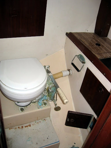

Thanks for the info. Blocked tank vent is not the issue - thats one of the things I checked :) Looks to me like the seals are allowing fluids to back up into the bowl. Not an expert on heads, but the picture below is what my head looks like. Looks like I may need to replace it with something newer...

That's a Skipper!
Defiinitely worth saving! If it needs more than what's in the kit, it's even worth having a bronze part machined somewhere. Here it is on the Thetford site: http://www.thetford.com/HOME/Products/PermanentToilets/TecmaSkipper/tabid/104/Default.aspx (doesn't show the pump handle in the photo). Click on "parts"...the box on the right side of the page, not the one at the top of the page. That'll take you to the exploded drawing and parts list (everything but the rebuild kit...hmmmm)...and a phone number to order 'em. Buy two of everything 'cuz Thetford tells me they don't plan to continue supporting any of the W-C toilets longer than a few years.

Coleman, your link doesn't work. However, there's nothing flimsy about the Skipper, nor is the handle hinged. So I doubt if what you found online is the same toilet. Nor is it likely to be an old Headmate either...it's always had the same type of piston/cylinder "bicycle pump" it has today...that ALL compact manual toilets have. Try again to get a photo up...I'll try to ID it for you.

I am not sure what it is, it looks more like what is in Southern Cross's linked image so that's why I posted. The the offset pump, the low base bowl, the raw water inlet control pedal, etc. Doesn't look like the Skipper at all and it may be what is typically on a '79 H37C as well as my own '80 model. I am almost certain the one in this photo is what I have, at least...

Unless you're absolutely certain that it's a W-C toilet...
I'm thinking that what you may have under all that corrosion is... Groco--either a Model EB (discontinued about 10 years ago) or a Model K, still in production. Both are in the same class and price range as the W-C Skipper. I don't THINK it's an Imperial.
Check out these photos and see what you think. The EB is shown with the electric motor added, so you'll have to guess what's behind it...neither show the pump handle ( which I don't think is original on yours). All the specs for the Model K are on the Groco website here: http://www.groco.net/07-sanitation/07-KH-heads.htm. I'd have to scan and email the ones for the EB.

I think I've finally got it,Coleman... it's a W-C "Junior"
A W-C "Junior #51"...discontinued so long ago Thetford doesn't even have any mention of it on their website any more. I found it in a catalog from the late 80s or early '90s. I had to scan a VERY small photo...see what you think: If I'm right, I have an exploded drawing and parts list for it that I can scan and send to you.

More than half the parts on the exploded drawings aren't on the parts lists...which means those parts are no longer available. And I'm not sure all the parts on the lists are even still available. In April their national sales mgr told me that the discontinued toilets still have some parts available, but more in kits than individually. So hopefully you won't need something you can get any more.
But judging by the layers of green vertigris and corrosion on it, it's gonna be a while before you know what parts it'll need! :) One thing about a "project boat"...it'll be years before you'll ever be able to say you don't have anything to do! I know 'cuz I've been there!

Absolutely certain its a Wilcox Crittenden. The head is exactly the one in the pictures from Coleman. So - based on that is it a Junior or an Imperial? Both exploded parts diagrams look pretty much the same.

Something I'd almost forgotten...
There were TWO "Juniors"....the original, and then the people who owned W-C between North & Judd and Thetford introduced a "Skipper Junior." They aren't the same toilet...the original "Junior" was a smaller version of the Imperial, not the Skipper..
So there's only one thing for y'all to do: call Jocko--a crazy Austrailian named Jock Allpress who's been with W-C for a zillion years and knows more about their toilets than I'll ever learn. He'll be able to sort out which toilet you have and what parts are still available in a heartbeat.

Wilcox Crittenden Imperial/Junior kit 1599 -- it's for sale most everywhere, it seems... Looks like this should do the trick, $80-$110. Even West Marine has it listed as "In-Stock"
