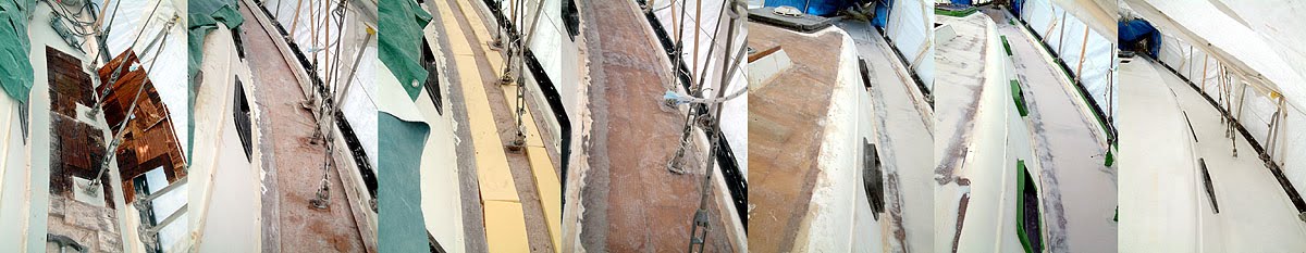

Hunter cutter 37 1981 St-lambert
You can find the pictures of the job I have on hand here: http://mathurin2.blogspot.com/2010/09/les-renos.html I have nothing else with me. The core doesn't extend all the way everywhere, on cabintop it stops about 3-4 inches inside the original antiskid paint. On the side deck, the core doesn't extend all the way to the cabin side either, and there is no core at the level of the deck to hull joint. Basically there is core section where there portlights are and a void over and below that.
The best suggestion I can give you is to cut about 2-3 inside where the core stops, you can later remove the core in that section using a flat bar and a wire brush on a grinder (works really well).
Here a specific picture of the area you are talking about:
http://2.bp.blogspot.com/_PCv9beR7eY4/TH8yW1u5DEI/AAAAAAAAAFw/Ro7fRmPKWms/s1600/deck7.jpg

btw, the original coring method was basically to glue 4in x 4in square pieces of plywood on the top skin and then to lay some fiberblass on top of that. They never took the time to fill in where the plywood didn't join properly, so there are some voids in come areas.
There was no way to recore where there was no core previously. To do that, one would have to do it from inside, which is a big no for our boats. You would have to remove the headliner to get to the inner skin, which be a non sense...
I hope you go with the drilling and filling with epoxy for the good reasons. If the core comes out dry when you drill and that the moisture meter doesn't go crazy when it comes in contact with your deck and you only need to re-glue the top skin to the core, then drilling and filling might be a good idea. If the core is wet and rotten, you will only make it harder on yourself when you got to do the job right because you are still stuck with the same problem in a short while... Just saying, I know how big of a project it's to go the long way...
