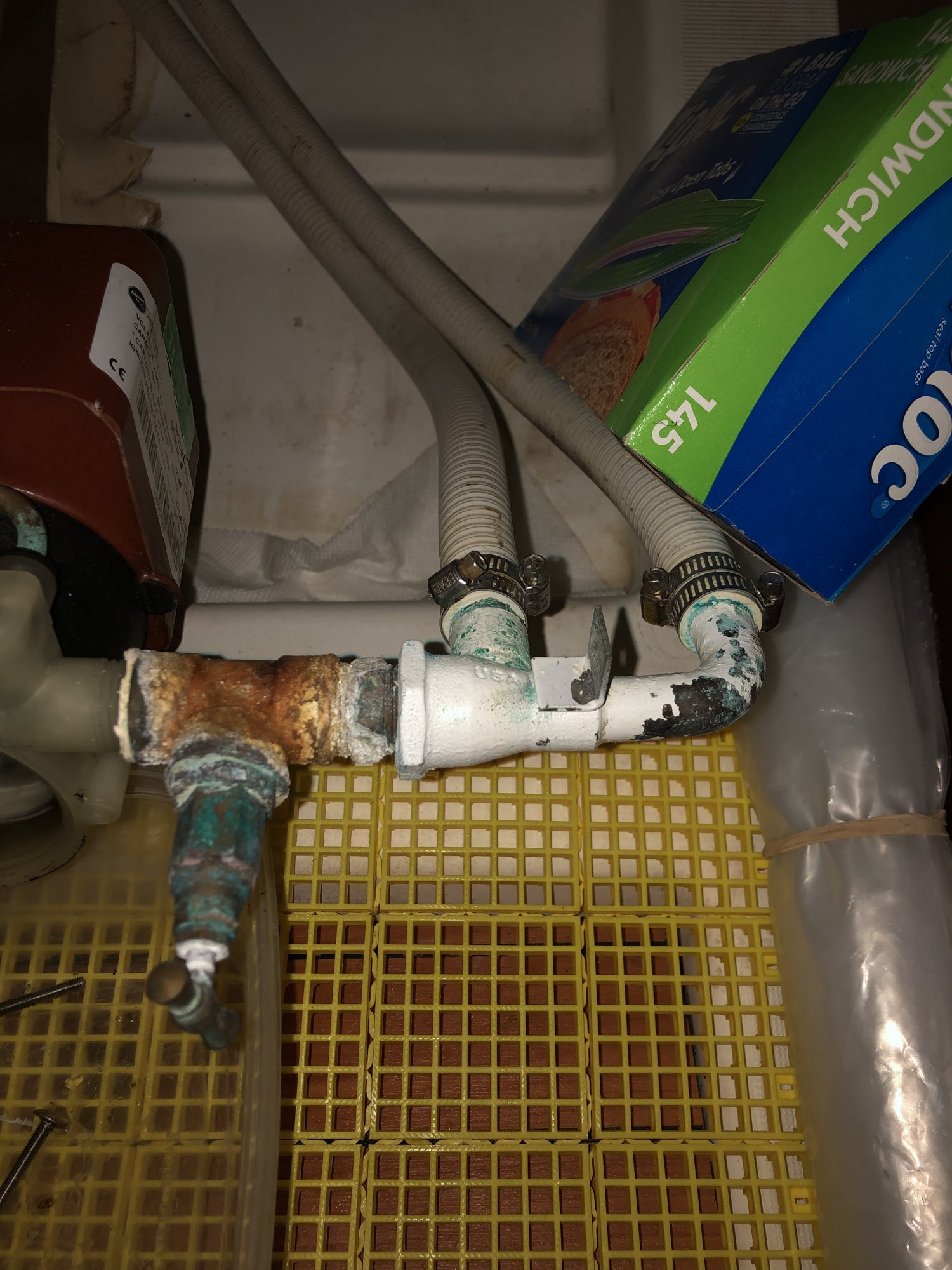

So I am sure someone will find this quickly but sadly I have been searching and can’t find where to buy. Remember seeing once a year ago but now I am at a loss. It is located after the water pump to my air conditioner..... screws onto pump, has a bleed valve and adapter to branch two lines.

It looks like a conglomeration ordinary plumbing parts, a T, some reducers, a valve all made of suspect material, is it steel? The one odd part is the reducing elbow with a T.
Is this to cool the condenser? If so, the bronze fittings should be use not steel or brass.

i am going with it is some method of draining the pump and condenser that has been added to help with winterizations before it corroded into oblivion. I personally would eliminate it and move the T/reducer fitting directly to the pump.

The purpose is to bleed the lines so pump works..... I have seen this exact set-up (and parts) on other boats...... so i thought it could be a standard thing.

There is an off the shelf part called a shower diverter that looks like that available at any plumbing dept. I have only seen it in 1/2" pipe thread. Yours look bigger maybe 3/4". It looks like it is hooked up to a March condensate pump. I have the same issue with my AC and simply installed a tee to a 1/4 turn valve. Use PEX, never corrode and crimps are stainless.
