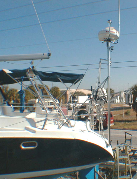

I have a Shakespeare SSB fiberglass antenna mounted on the starboard stern quadrant and want to build an outboard lifting crane. The crane really needs a pole and it would be attached to the stern rail seat tubing. I have the room and it would be next to the outboard rail mount. What distance would I need to not create a parasitic element as the pole would be parallel to the antenna? It is difficult to separate them much in that configuration.

Take the opportunity to get the antennae up higher by putting it on the stern pole you use to mount your motor lift. It sets you up with a location for other antenna, lights and radar.
