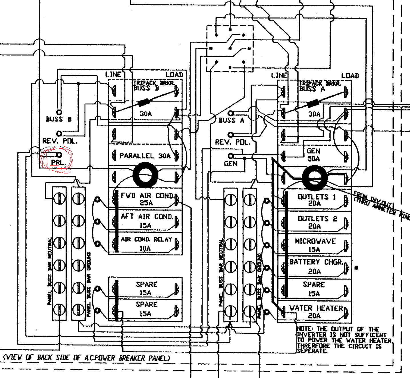

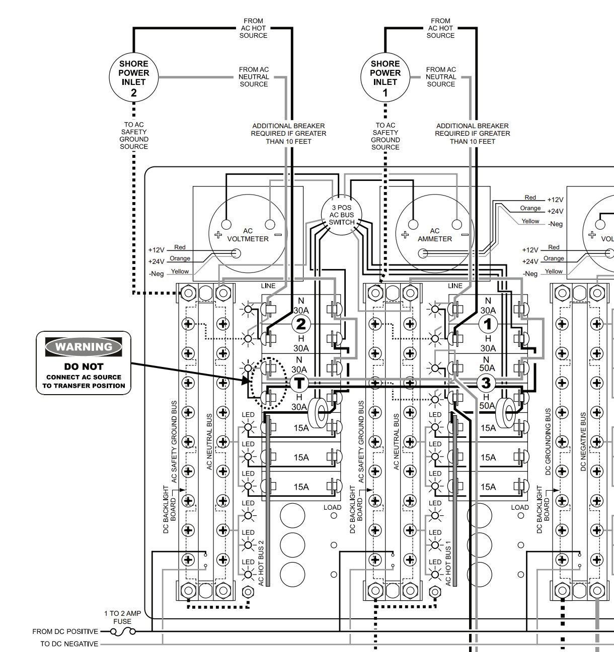

How is the tiny red light wired on your panel? What's it's neutral and hot source?
Here's an example of the wiring for the parallel light (circled in red), on a panel that has 2 x 120V 30A AC inputs or can parallel bus B to bus A.
Bus A can be powered from 120V 30A shore power or generator.
You can also follow the hot wire path for the BUSS B input or the parallel input (bus b on the left, bus A on the right) ....for bus B only one of the inputs can be selected:
-120V AC external input OR
-parallel
not both at the same time).

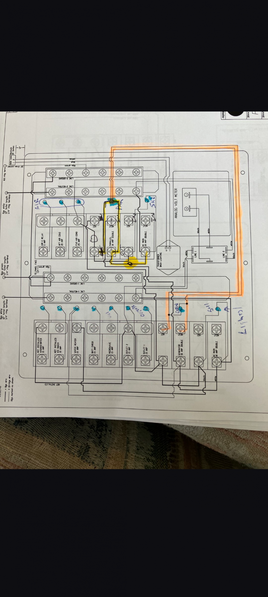

This is what we are planning to do. Installing the diode should make the Parallel light work like every other light on the panel. Light On will mean circuit activated. It will not mean Available and be the odd ball on the panel.
