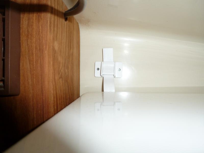

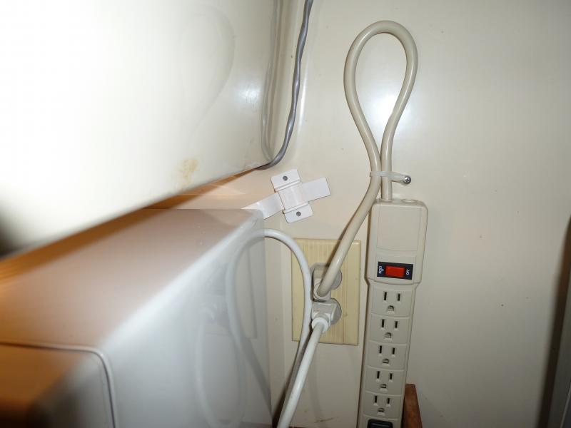

The microwave is sitting on about a 3/8" piece of wood to elevate it above the counter rail so the door swings freely. The unit is strapped down with a non-Velcro tie-down strap system that I got from WM. Heavy-duty Velcro would work just as well. Where positioned, there's not much room for the microwave to move other than forward.
I'll post pics of the install when I get to the boat this weekend.

Thanks Scott, I used to sit mine there but would remove it to go sailing. I noticed it was starting to mark the counter surface so now I just sit it on a cutting board on the chart table. A permanent mount would be nice in the location you are using.
Can you remove screws from the bottom of the case and screw it down from below by running screw through the counter?

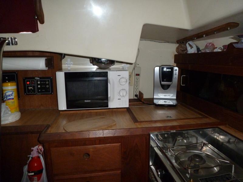

This is how I installed the microwave on Karma. I used Igloo cooler mounting hardware which comes with adhesive and can be screwed in. I figured that if the mounting hardware was stout enough for a cooler of ice that the microwave would be secure. The shelf front was removed so I was able to push it back against the bulkhead. The leftover shelf front was the right thickness to lift the front of the microwave so the door would swing open freely. Overall it uses a good bit of previously wasted space and does not take up too much counter space. I store the coffeemaker against the bulkhead when not in use which allows access to the cooler (my liquor storage area)
Looks great!
Do you have a inverter?

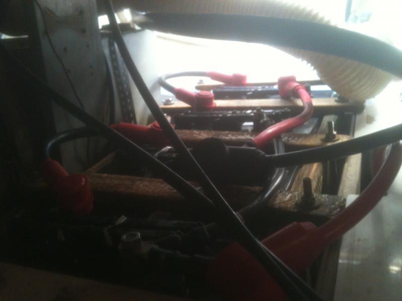

While digging around in the fuel tank project I notice that the battery tray is extremely weak and thin and the hold down is pretty weak. I know DaveM made a whole new arrangement for his batteries. While I'm in there I am thinking of beefing up the tray by cutting a slot in the front, inserting some wood to spread the loads of the hold down screws and then glassing it back together and beefing up the tabbing that holds it all to the hull.
I think I saw somewhere that MaineSail had put the batteries under the quarterberth in the first compartment on an O'Day. It might be on the Compass website, not sure. But that would be a great place for them if they will fit. Easy to get at and the wires to the battery switch would be shorter.

The PO of my boat built a tray behind the motor. It seems pretty sturdy and is all epoxied. Here is a pic.

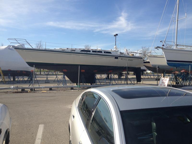

on the road again

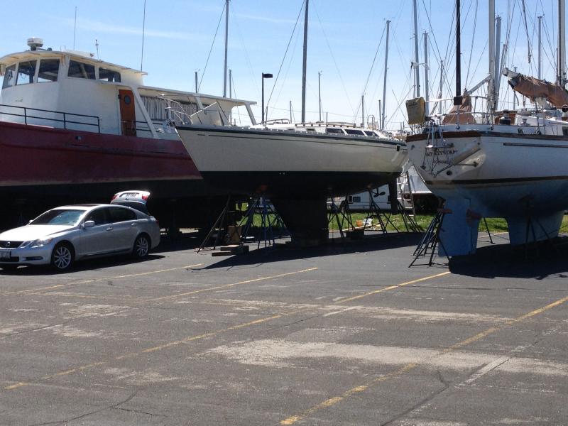

All ready to go. Panta Rhei is is heading 30 miles north to Manitowoc WI to a big time boat yard where the shaft will be replaced and a drip-less seal installed. I'll do my sea trials there with help close by then sail back south to Sheboygan for the summer.

Getting serous
Panta Rhei is now up with the big guys. Manitowoc is a big time boat yard. The ferry stops by three times a day. She looks pretty small compared to the others.
They have just begun to get boats into the water.
They are saying that they will have the shaft out next week. I'll be impressed with all the work they have getting boats in the water.
