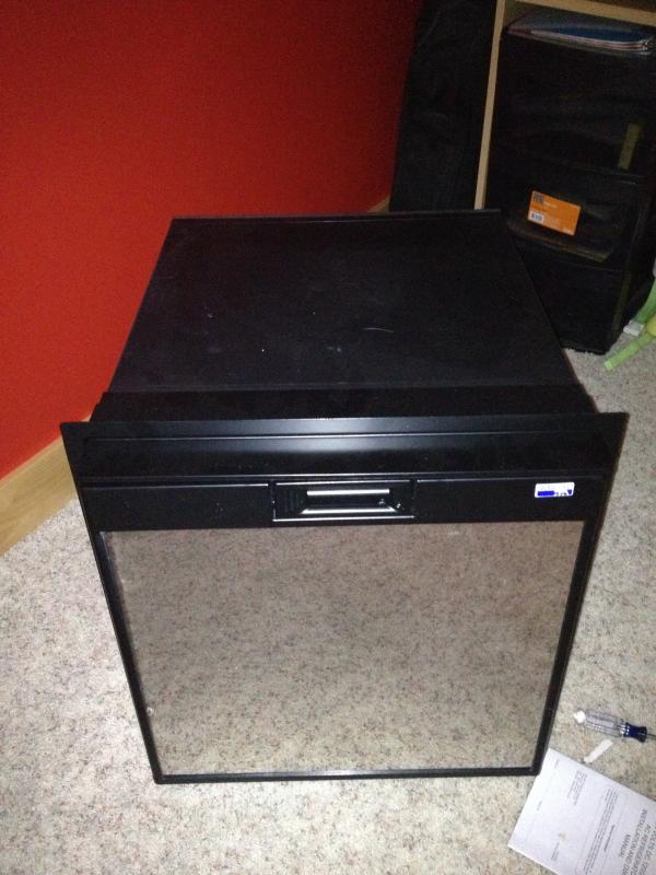

New refrigerator
My boat was first purchased and spec'ed out for a charter fleet in the virgin islands. The nav station was replaced with another Ice box and bar above.
We decided to replace it with a front loading refrigerator. The door will open to port. Not ideal. Certainly not if you are sailing on a starboard tack. We plan to use this exclusively for food so the beverages will be in the top loading Ice box. I can easy the sheets a bit if Susan is making lunch below but this should be seldom as we decided at the start that Panta Rhei was to be converted to a more modern design intended to be used down below only at anchor or in her slip.
I checked out many units even a few Walmart dorm room units I could run off the inverter. I decided against them as I was unsure of there functioning when the boat was heeled as well as the higher power draw and noise. I had many second thoughts since they are VERY cheap!!
I settled on the latest model Norcold at 3.0 CU FT. This unit is much more space efficient fitting in the same cutout as an older 2.4. It uses a danfoss BD35 compressor that is said to be very efficient and quiet and will run at a 30Deg angle. (we will soon see) 3.0 CU FT. is a lot of room just for food.
Our galley is set-up mirror finish stainless. I did not want to pay the extra 75$ for the mirror finish insert and silver plastic frame so I purchased a 22gage sheet of mirror finish Stainless and sheered it at the factory where I rebuild the boat. I think it looks better, I must admit that I saved very little money
I attached a photo of the unit. You can decide if it was worth it.
I hope to install it soon if spring ever arrives. Anyone have any tips on installing these things?

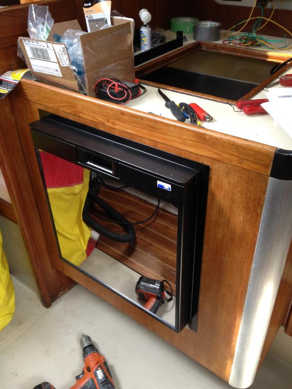

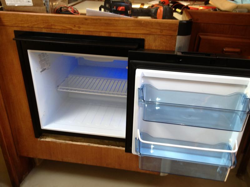

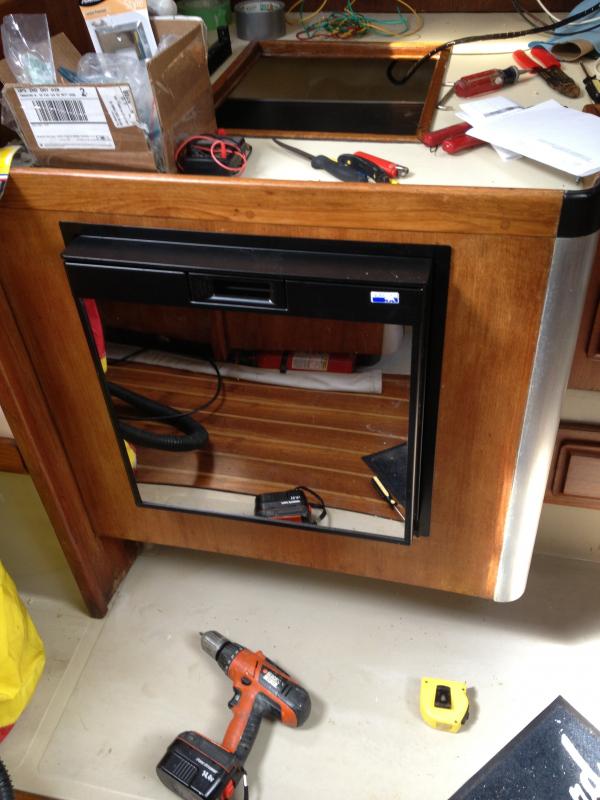

Fridge is in
I installed the fridge. It went in very easy but of course it is 38 Deg. Let's see how it does when (if ) summer comes.
It's a 3.0 norcold. It is designed to fit in the cutout of the old 2.3 Cu-Ft model.
I mounted it in place of the old icebox on the starboard side. This boat was sold into the Caribbean charter fleet. It had a bar/icebox in place of the nav station. Who navigated down there anyway. Just have another drink and find out where we land. It actually works out well now that chartplotters are the norm.
The fridge does not take up the hole icebox. I plan on putting paper charts and chartkits in there as I think it will be very dry.
You will notice in the photos with the door open that I need a piece of trim at the bottom. I'll have the guys bend one up at the shop. I may call Norcold and see if they have a solution. This area is very critical as the fan draws cool air in at the bottom left and blows it out the bottom right.
It super quiet but it is surrounded by 3.5" of the old icebox foam.
I intend to use this for food and use the other icebox on the port side for drinks and snack while we are underway. This should keep the fridge closed as much as possible.
I'm hoping my wind generator can keep up with it.
I added a photo of the port side as well.
The unit came in all black I had a mirror finish SS panel cut for it. It fits the rest of the galley.
