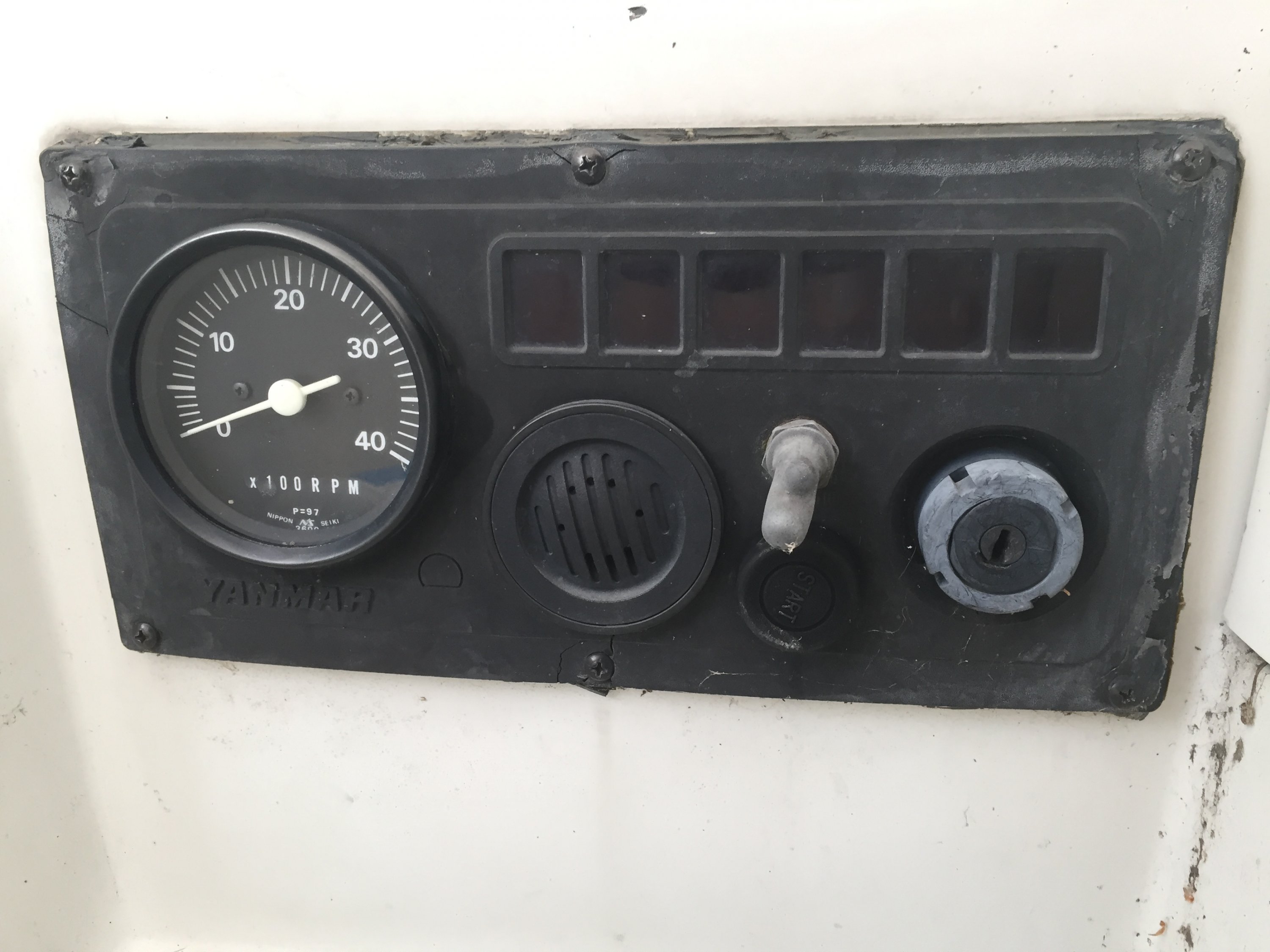

I purchased my O'Day 322 May 2016. Love the space! Great cabin. I have had to do some upgrades including new sails and a new furling unit, which are both going on in the spring. I'll also be replacing some hoses but otherwise she is in good shape.
I do have a question. What is this switch on the panel? Also, any thoughts on the 6 indicator lights? The only one that lights up at start is on the far left, oil pressure.

It's a Yanmar basic panel. Flip up the switch to check the alarm.Flip the switch down to turn on the backlight (hard to see in daytime).
Idiot lights are just that. They only come on if there is a problem. Not a great diagnostic tool but at least a starting point.

The flip switch has a dual function. Flip down and it will turn the panel and compass lights on; push up and it will test the temperature sensor circuit by sounding the buzzer and turning the warning lamp on. When you switch the key on the oil pressure and charging warning lamps should come on as well a the buzzer. With the engine off there is no oil pressure and the alternator is not turning. The temperature one will not come on because the engine is not overheated and hence the flip switch at the panel. I see some cracks on the panel template and weathering. A replacement can be obtained from Yanmar (panel B) and they are really inexpensive. Transferring the tach and switches is quite simple. The costliest component in the warning system can be the buzzer at around $130 last time I checked for the multi point fixture. Sensors and bulbs are reasonable. Yanmar did put six warning lamp positions in the panel but mostly only three are used.

I do need to replace the ignition switch as the key doesn't stay in very well. Maybe will look into the panel as well.
