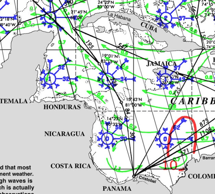

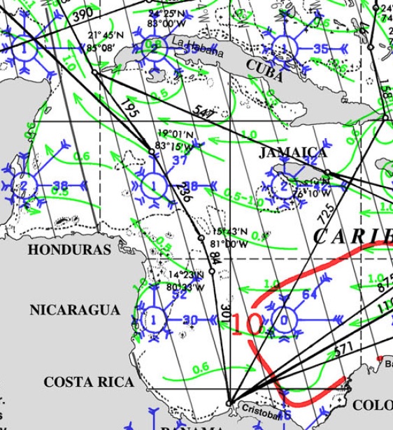

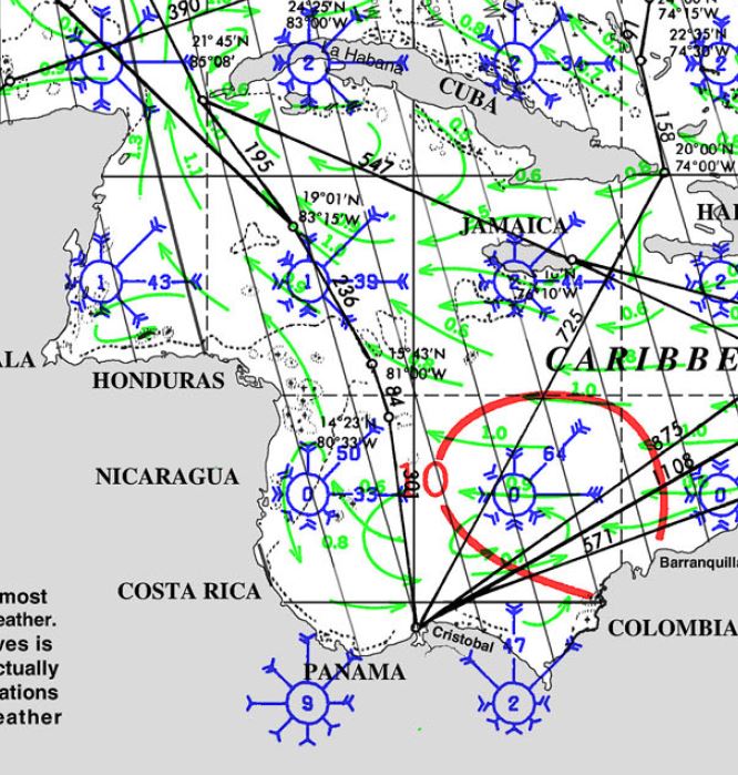

I'm curious where you get your wind information. The Pilot charts predict Force 4 (11-16 knots) out of the NE to E. The wind and current both seem very moderate and working together more or less.
December:
January:

Have a look at the February pilot chart. The winds are North at Panama City but offshore they are NE then trending to the E the further North you go. The high level plan would probably be to head out on a port tack, get into the favorable currents, until the wind starts to back then starboard tack all the way to Cancun. Ha, as if I could plan that well :biggrin:
