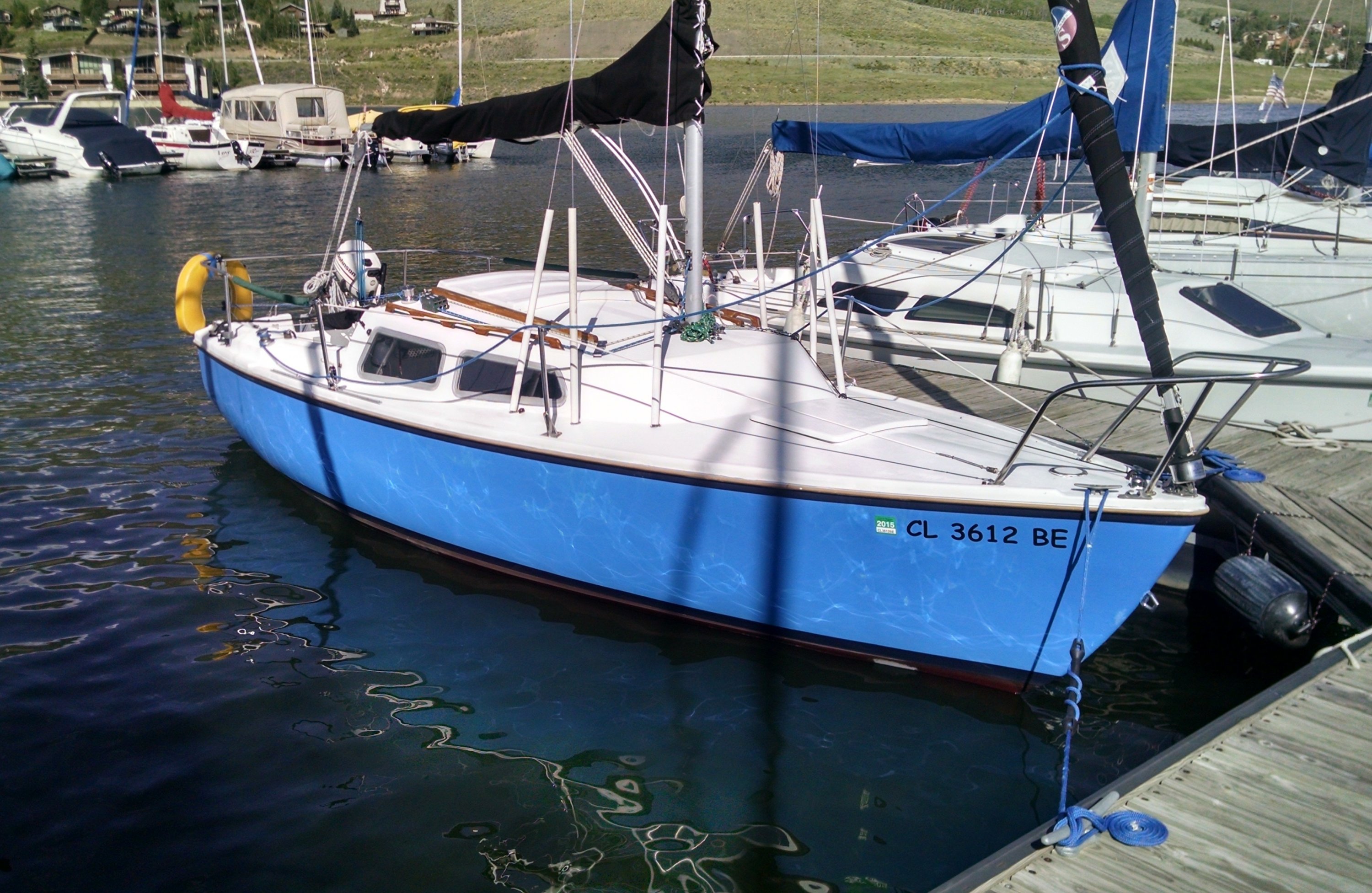

I did the topsides with Interlux Brightsides.
Loved the outcome and it was very easy.
Think about doing a color. Basic white is normal but, these older boats look great when they stand out a bit.
