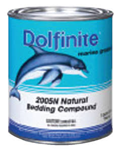

Of course, you could use the product designed specifically to bed things like hardware and handrails on a boat, ie; bedding compound. Very, very easy to work with and clean up is a breeze.
On a different note, if your boat has non-skid laid into the mold, don't forget that if you don't get each and every 'hole' clean and prepped for painting, those that do not have the paint stick could possibly cause areas of your nice newly painted deck to peel.
